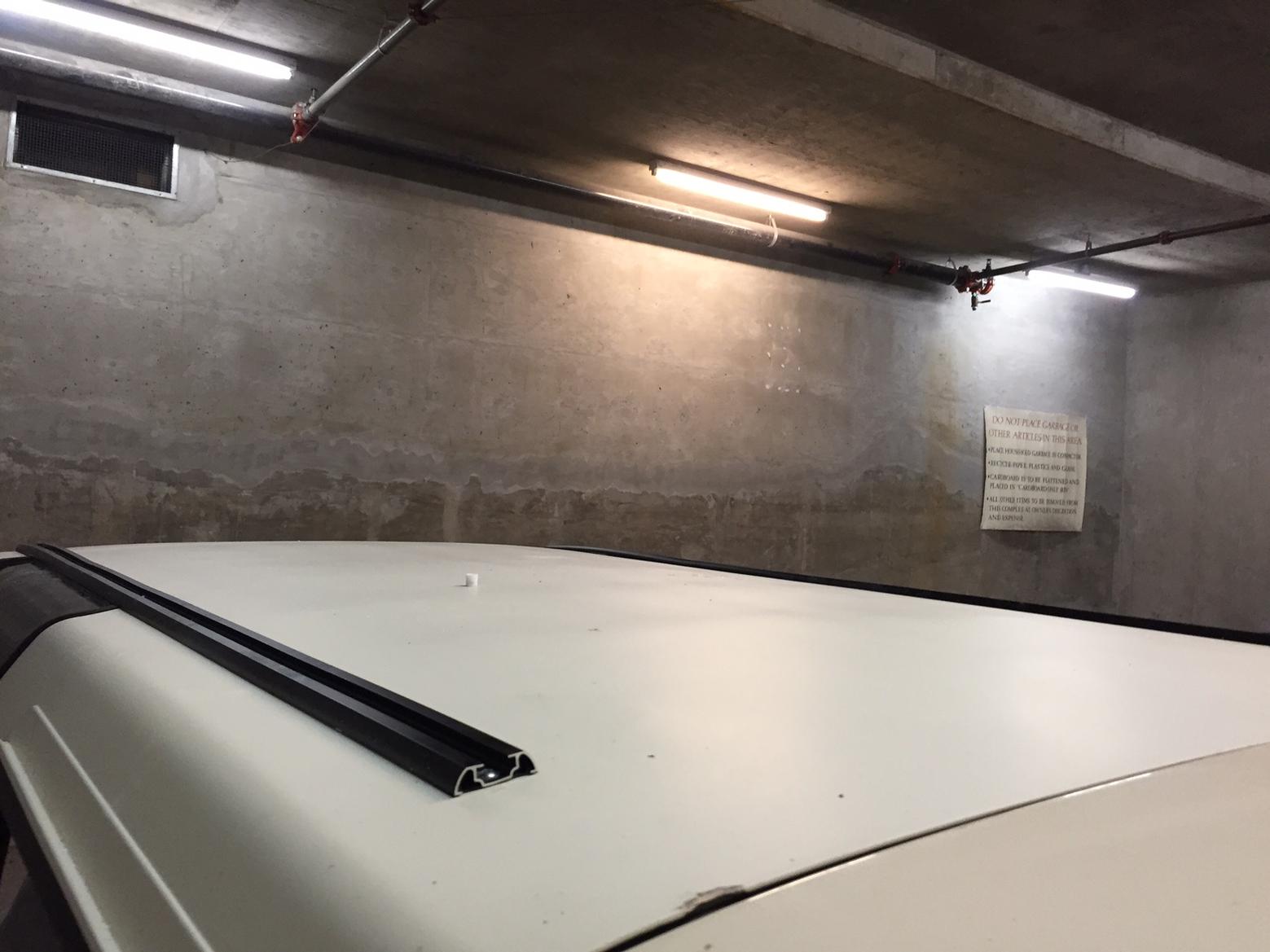

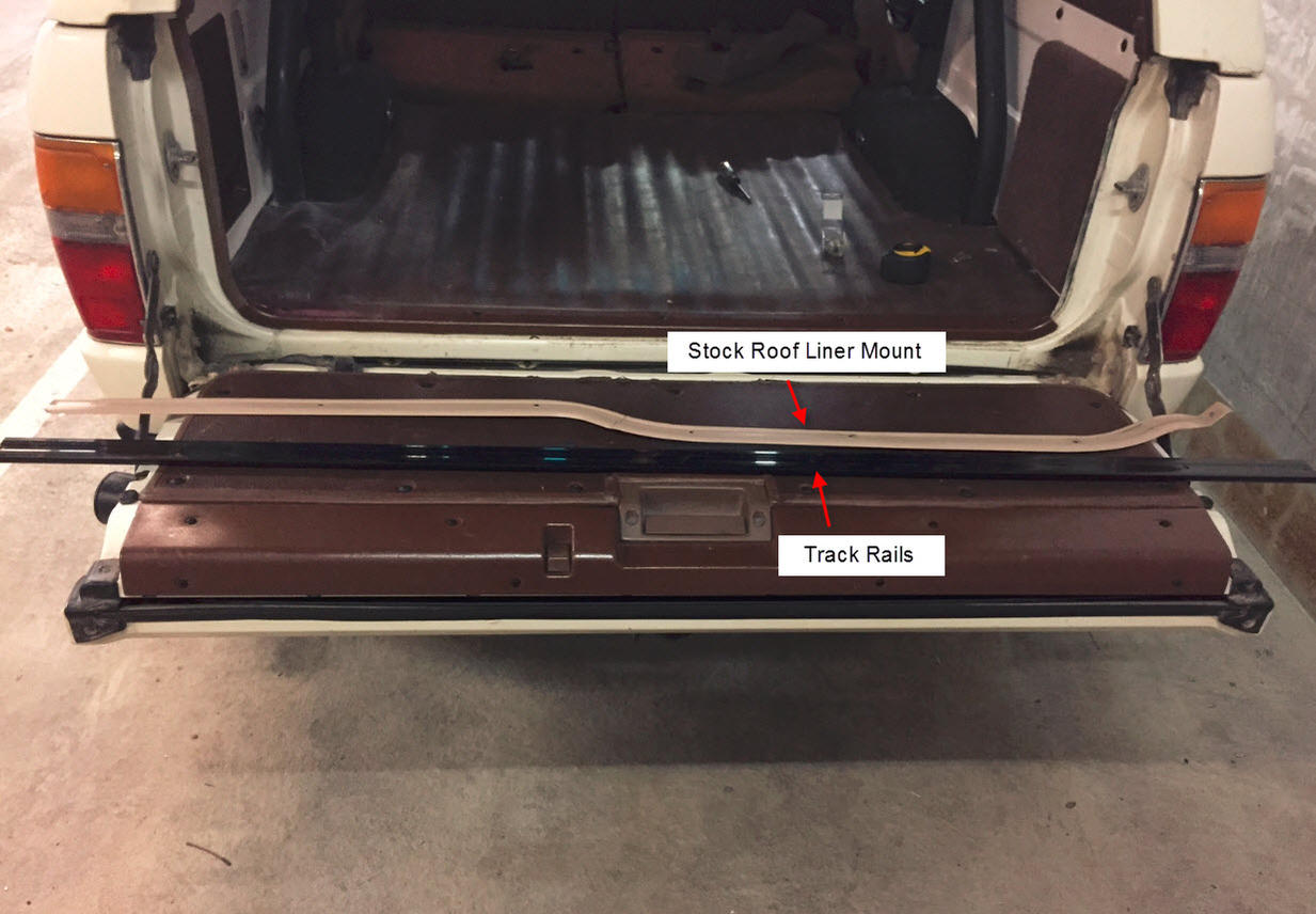

I used a Yakima track on my 1st gen.

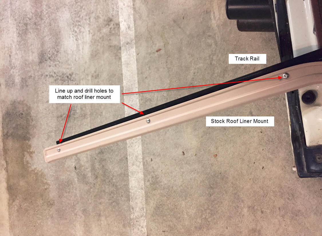

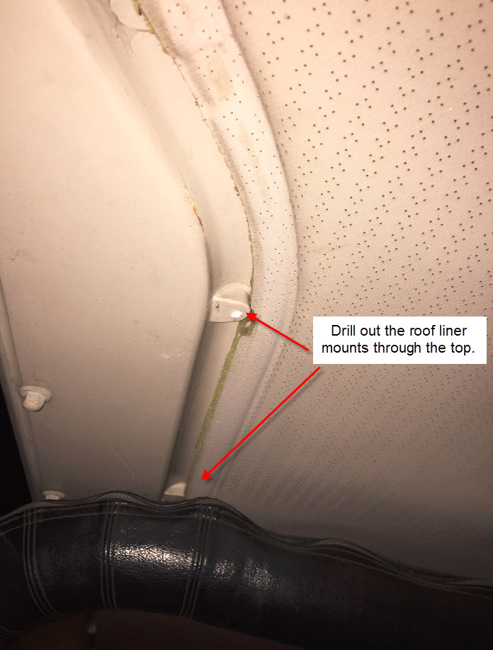

The roof liner mount is the same length and shares screw points similar to where I wanted to mount the rack on top, so I removed the liner mount, drilled out the holes that matched the rack, and re-installed with new bolts. I like this mount because it not only hides the bolt locations inside the top (stealth-like), but mostly because it is the thickest and most consistent part of the fibreglass on the top and uses the roof liner mount as additional support - a sort of sandwiching of two metal tracks between the fibreglass.

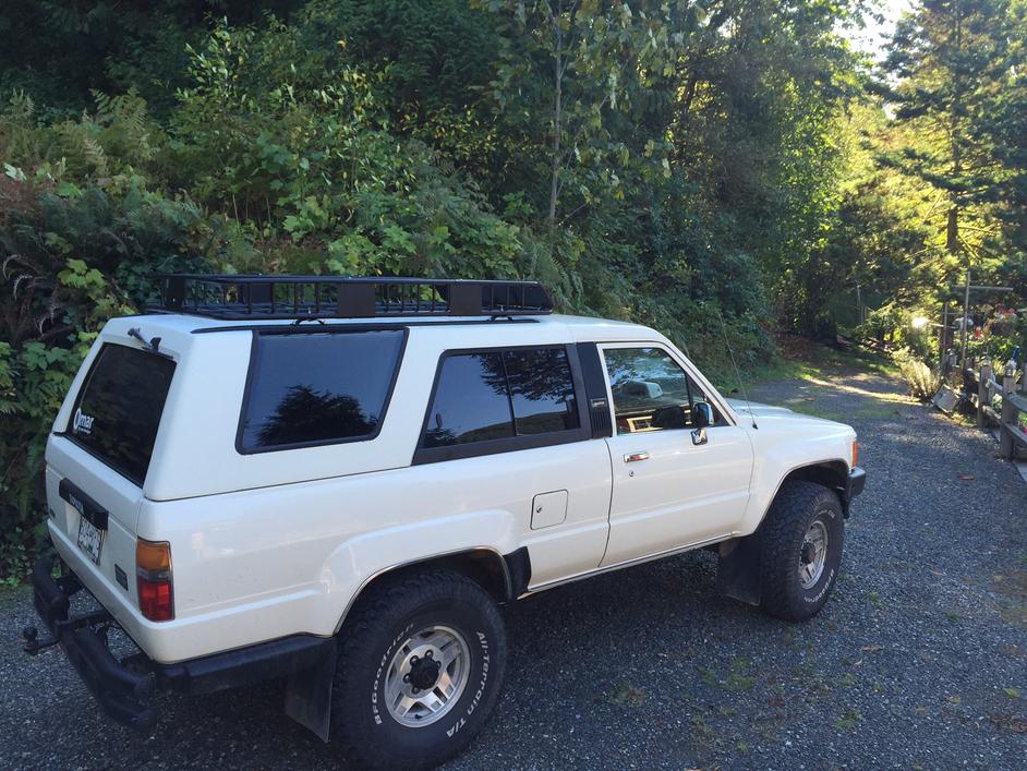

The result provided a very low profile mount system that I can swap out for rails, RTT, Basket, etc. Currently have a basket installed.
Recommend if you do this to take your time lining up the holes and test fit the track before drilling. I came a little closer to the window seal than I hoped. Also make sure to jam some silicone in the holes before tightening the screw to eliminate drips! Because I'm paranoid I siliconed around the track edge as well.

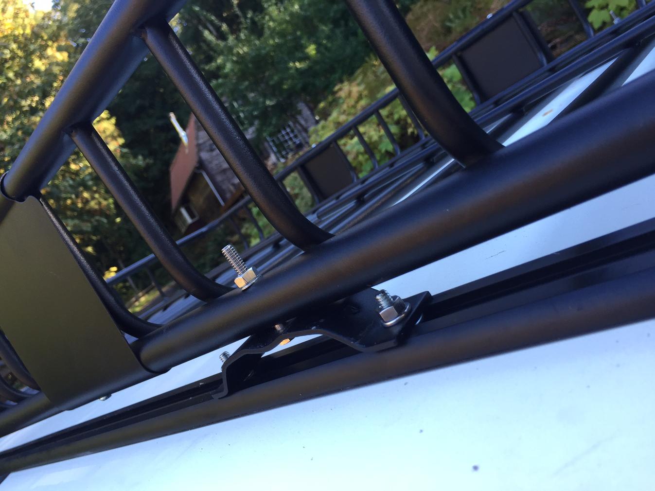

I used the Yakima rack, but in future I would use the Rhino version. The end caps on the Yakima are not easily removable, so if you have for example a large bolt that you want to slide in and out of the rail for different mounts (like I do) you have to unscrew the track to take off the end cap. I dont like this because it messes with the silicon seal.

The metal strip is curved. Care to show us the whole length of it and which holes you used? How far inboard do you think should one move the mount to make sure it clears the quarter-window seal?
T-Nuts or T-bolts would work without having to remove the end-caps.

I'll take a picture of the finished interior to give an idea which holes go where. I skipped the curve portion and drilled one or two (can't recall right now) holes directly through the fiberglass and supported the backside with normal washers.
You dont need to move the rail too much inside, maybe 1/8". My rail shares a bit of space with the quarter window metal trim which makes the seal against the roof not perfect. I'll try to get a photo of that too.
I like those T-nuts! Yakima was selling something similar but it was grotesquely clunky and expensive. I was contemplating just shaving the sides of a regular bolt head enough to slide in and out.

See photo below for bolt placement. I left them long temporarily in case I needed to re-set the track or something. Temporarily like many things became permanent.
The bolts are covered with a black rubber sock that came with the Yakima track.
Here you can see where the track overlaps the quarter window trim. Not the end of the world, but would have been nice if I could have missed it.
