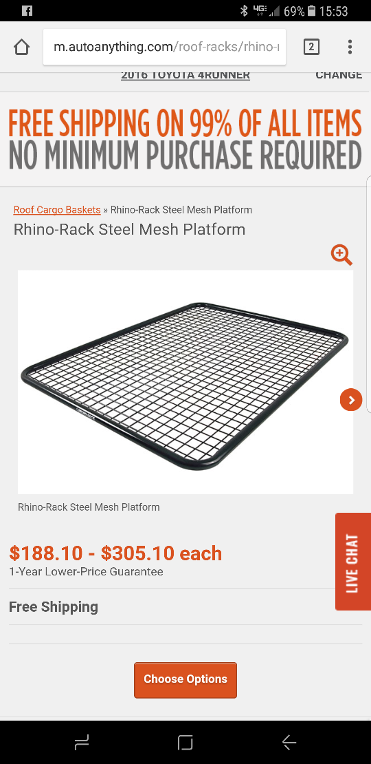

I think that this will work and sit down inside the rails. Or just slightly above. And provides limitless tiedown opportunities.
http://m.autoanything.com/roof-racks/rhino-rack-steel-mesh-platform
Size small for 188.10
Mounted to these flipped over-the-top
http://www.4xinnovations.com/03-09-4RNR-Rola-Rack-Mount-Kit_p_43.html
For 80ish bucks
And about maybe 10 bucks in hardware.
It would be a bit longer than the stock rails but extending past the back would be okay.
A little more thinking but I think this will work
Rhino-Rack Steel Mesh Platform - Roof Plank - FREE SHIPPING!
03-09 4RNR Rola Rack Mount Kit
For 80ish bucks

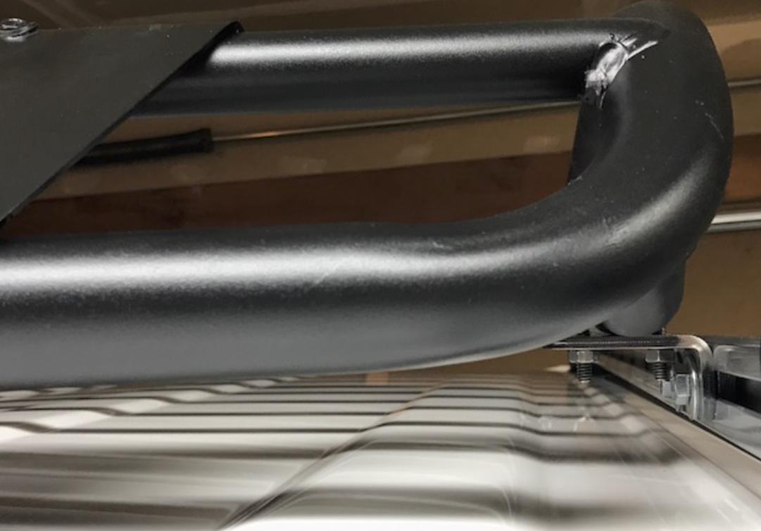

I just used the low-profile Rola mounts flipped upside down on my 5th Gen, worked great:
http://www.toyota-4runner.org/5th-gen-t4rs/238047-installed-rola-low-profile-mounts-5th-gen.html
I mounted it with the lower rail behind the shark fin, to push it as far back behind the sunroof as possible.
$221, done.
