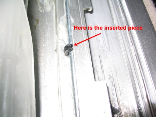

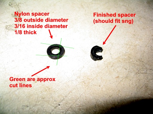

Well being no one seems to check the "Problems and Warranty" section I am re-posting it here:
Does ANYONE have the photos for the sunroof rattle fix with the plastic washers???? That entire post in the above mentioned section has no photos. When you open that thread there are only red X's where the photos should be.....yes all of them and from every computer ive tried so its not that. I know someone here has to have them and I cant take this rattle anymore when the roof is open. Thanks.
Let us know if you cannot see these pics.

Yes, thank you I can see these photos just fine. And no offense taken I am upgrading my Dell dinosaur with a MAC soon. Thanks for posting the photos.

Still havent fixed the rattle though.....woops.
