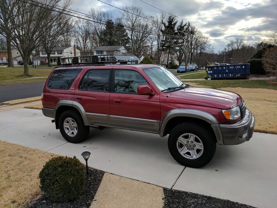

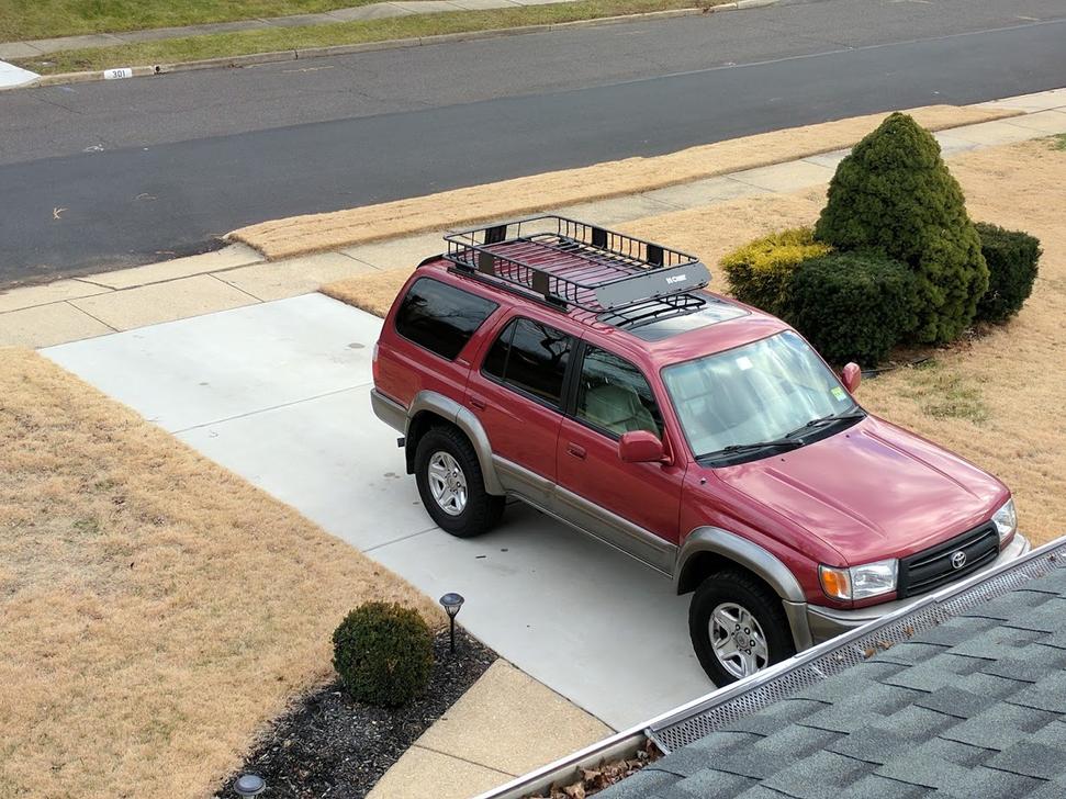

Bumping this to add my setup since this thread inspired it. Curt rack with a single extension mounted using Jaketino's method. My aluminium mounts are slightly shorter in height and the U-bolts that came the Curt rack were too long to work so I used some steel strap and bolts instead. The rack slightly hangs over the moonroof but it still opens with no issues.

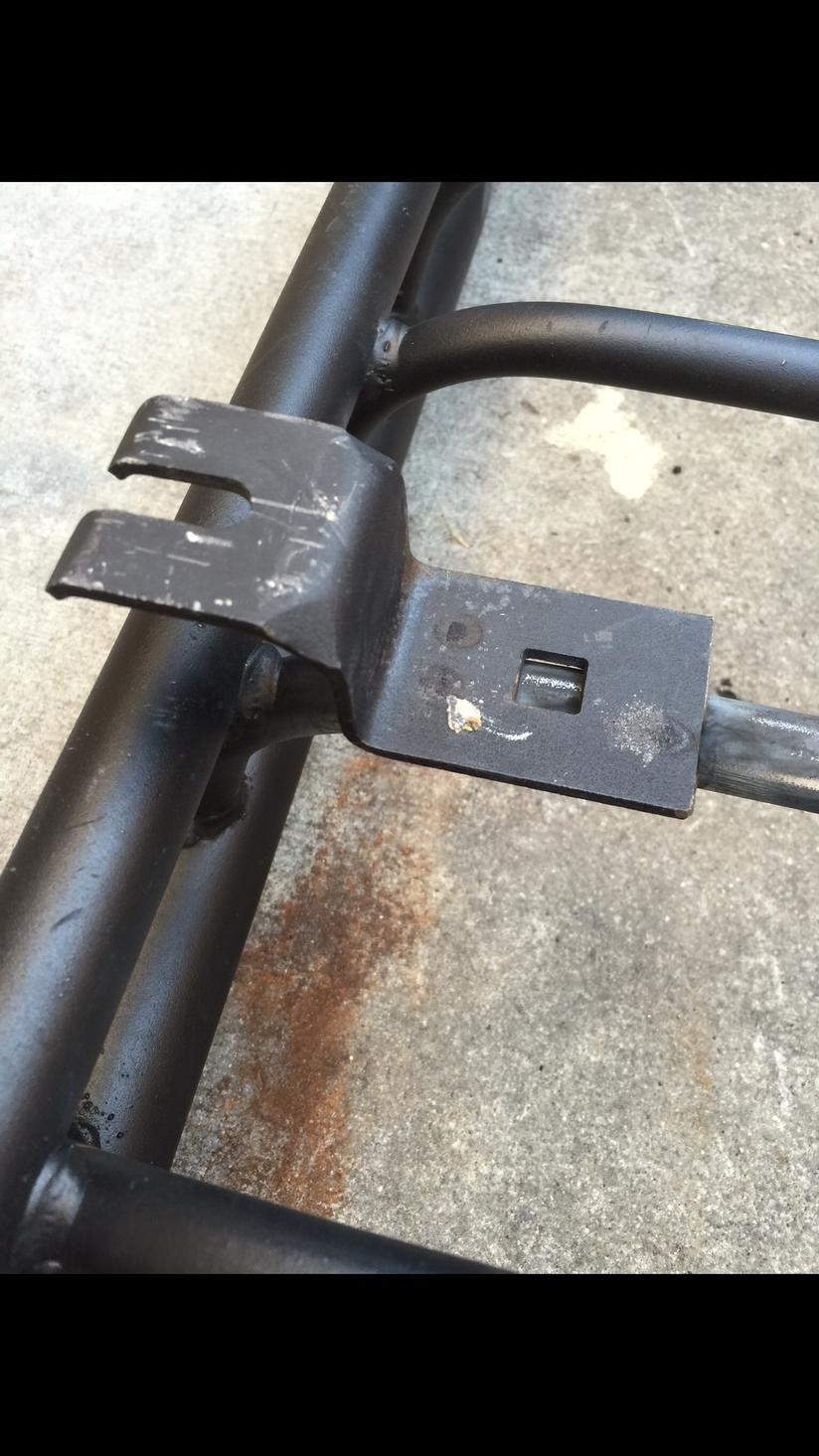

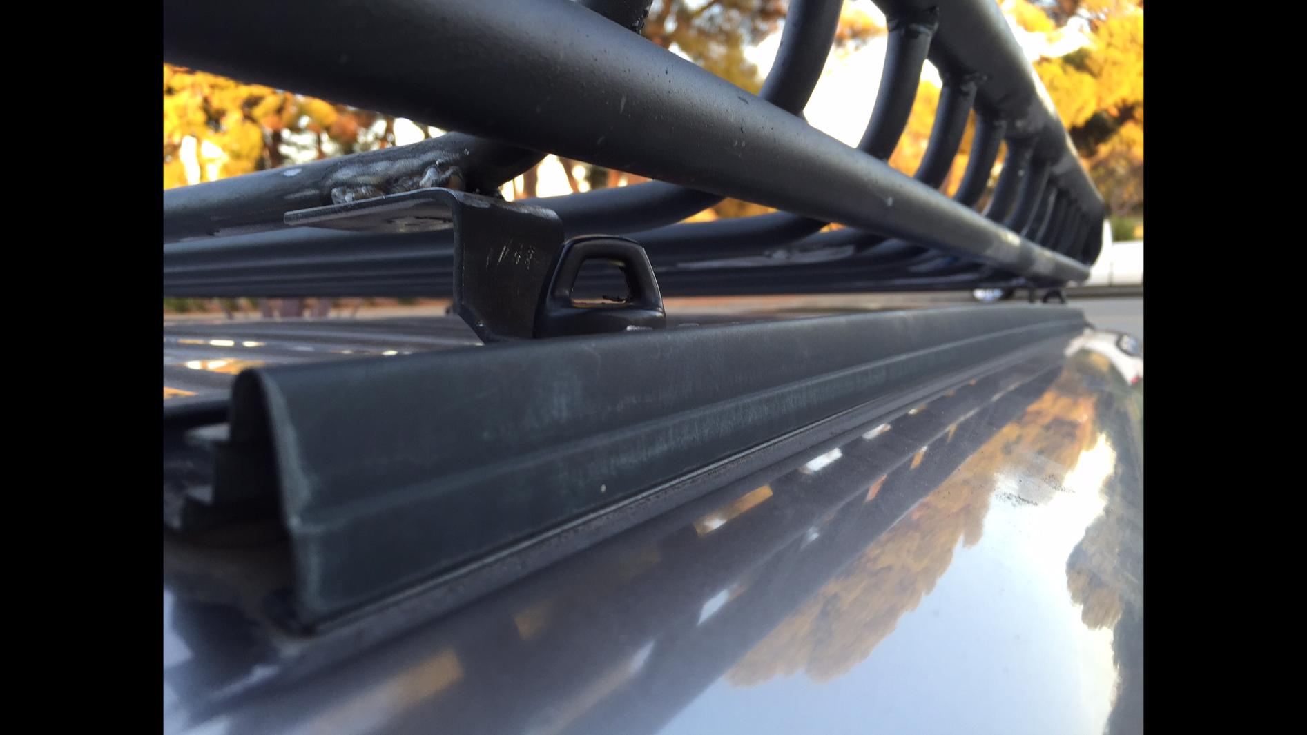

I took the original mounts that came with the rack, cut them in 1/2, & the welded them to the bottom of the rack itself...
I achieved a super low profile mounting system that uses the factory roof rail mounts with the twist lock things...

I did a similar thing to mount my Surco rack as well!!
sits very low. And I can get in the garage!!
