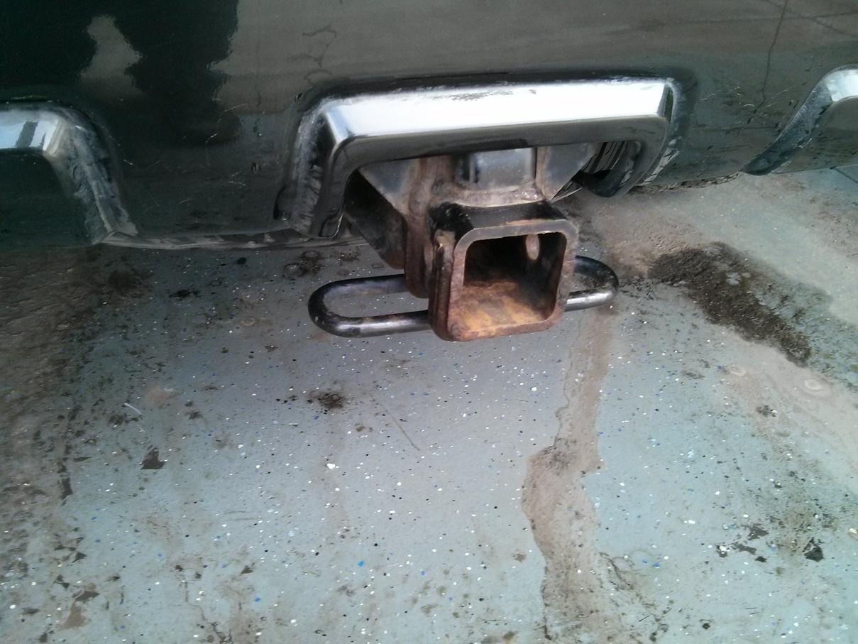

I have a 2007 4Runner Sport. I just recently bought a tow rope and some D-rings so that I can pull people who are stuck (snow, mud, etc.).
The two small loops that are attached to my hitch -- are they strong enough for this task? Can I hook the D-ring directly to those loops? (picture).
If not, do I have to get a piece to fit into the hitch to attach the d-ring?
Thanks.

Do not pull people out using those. They are made to hook safety chains to. Get a receiver or a 4 way setup with a hook on it.
im surprised no one else responded to this but in my opinion it is not strong enough and would shear off. i would recommend tow receiver hitch with a d ring
haha wooops [MENTION=51777]rcdeppen[/MENTION] beat me to it
I'm in agreement with everyone else... get yourself a D-Ring receiver type hitch and good locking bolt (if you don't want someone else enjoying it too). Get yourself a solid strap, too. I think mine is rated at like 15K lbs.
Here's a crappy pic of mine, but you get the point:
