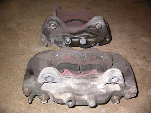

The Tundra Caliper is massive in comparison. This picture is from the article on offroad.com talking about the upgrade.

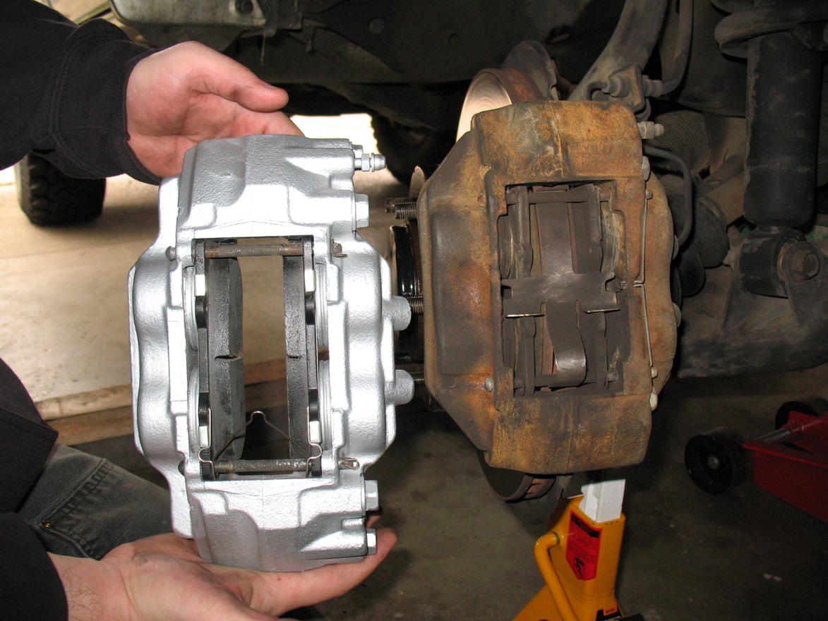

Mine were ready to be replaced anyway, so I decided to upgrade... what an improvement!!
Highly recommend!
