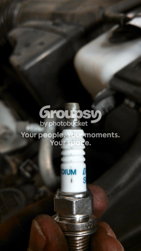

I decided to change my own spark plugs today at 120k miles as preventative maintenance. 8 Denso Iridium SK20R11. After doing this, I started up and listened. Nothing abnormal. Drove a mile and on idle it ran really rough and the exhaust was "puttering". I pulled all the plugs again, making sure to clean the coils or boots as much as possible. Noticed a cracked spark plug (I think) shown below. Maybe I overtightened it, or dropped it, or it came that way?

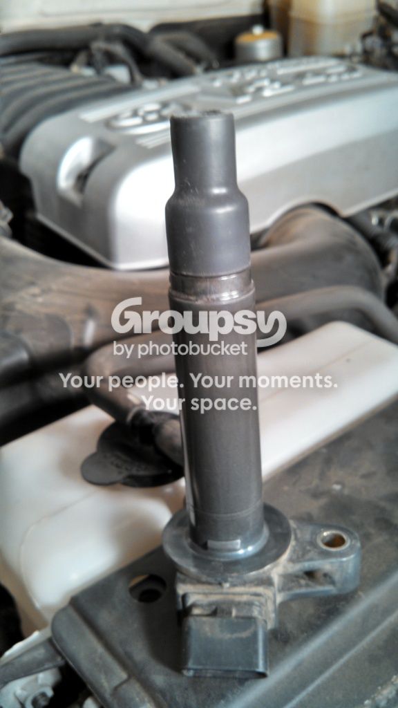

Wiped down these thingies-
Once I replaced the cracked one (Amazon sent me a few extra!) and cleaned all the coils (or whatever they're called) And double checked I didn't break a wire or not click a connector all the way. Idle was fine for a couple minutes. I drove it a mile listening closely and when I parked it, I realized it still wasn't 100%. You could barely hear it and feel it running like it couldn't decide which RPM to run at. The exhaust still sputtered.
Do you have to check gaps on every spark plug? I assumed these were already correct.
I didn't use any anti seize and made sure to just snug them up.
I'm at a loss here. What did I do wrong?
Never assume the factory gap is correct. Always double check. I have found a few that were off. Did you use dielectric grease? I'm not familiar with Toyota engines. Are those the factory recommended plugs? I stopped using fancy plugs for just because. After double checking everything, try unplugging the battery for a few minutes. Allow the computer to relearn new parameters.

It could be I'm just paranoid. I drove around some more and stopped periodically and had rock solid RPM in Drive. Park though varied a bit but this could be normal and it never had any knocking or rumbling like before the cracked plug was changed. I would like to think it is fixed now, but I will continue to monitor.
I ALWAYS check every plug that goes into whatever I'm working on. They all come pre gapped now adays, but mistakes happen. Checking them has saved me once, and now I'll always do it.
Those appear to be the correct plugs. They do not require gapping per Toyota. There is sticker on the driver's side of the engine block on my V8 that warns against gapping them. Your engine may be relearning the idle speed, etc. if you disconnected the battery.

And if they are the right plugs then no you don't have to gap them
You should always CHECK the gap on new plugs, but with the fancy iridium/platinum/unobtanium plugs you can't CHANGE the gap as the electrode can break/bend.
