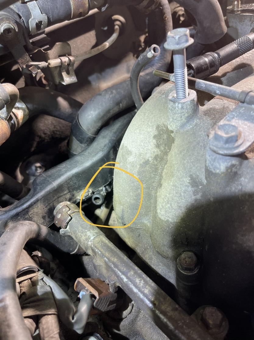

Second vacuum line is at the back of engine exactly where the fuel supply line runs, it's a vacuum line connected between the two cylinder banks with a y connector but no line. (Attached photo)
Attached photo

For the 3.4l there is a vacuum air assist that ports air from the IAC to a Y that splits and goes to each side of the intake manifold in line with wheee the injectors mount in it.
Yours being an 01 I do not know if your engine has this same setup.
Also that IAC has a coolant line going to it and it’s easy to get the air assist and coolant lines swapped. But once again I do not know if your 01 has the same setup.
The Vacuum nipples behind the valve covers run in line with the fuel rails and tie in together into a y connector. There is a slightly bigger line from the air control to the y connector it's the air assist hose. The other 2 hoses on the iac are the coolant bypass hoses.

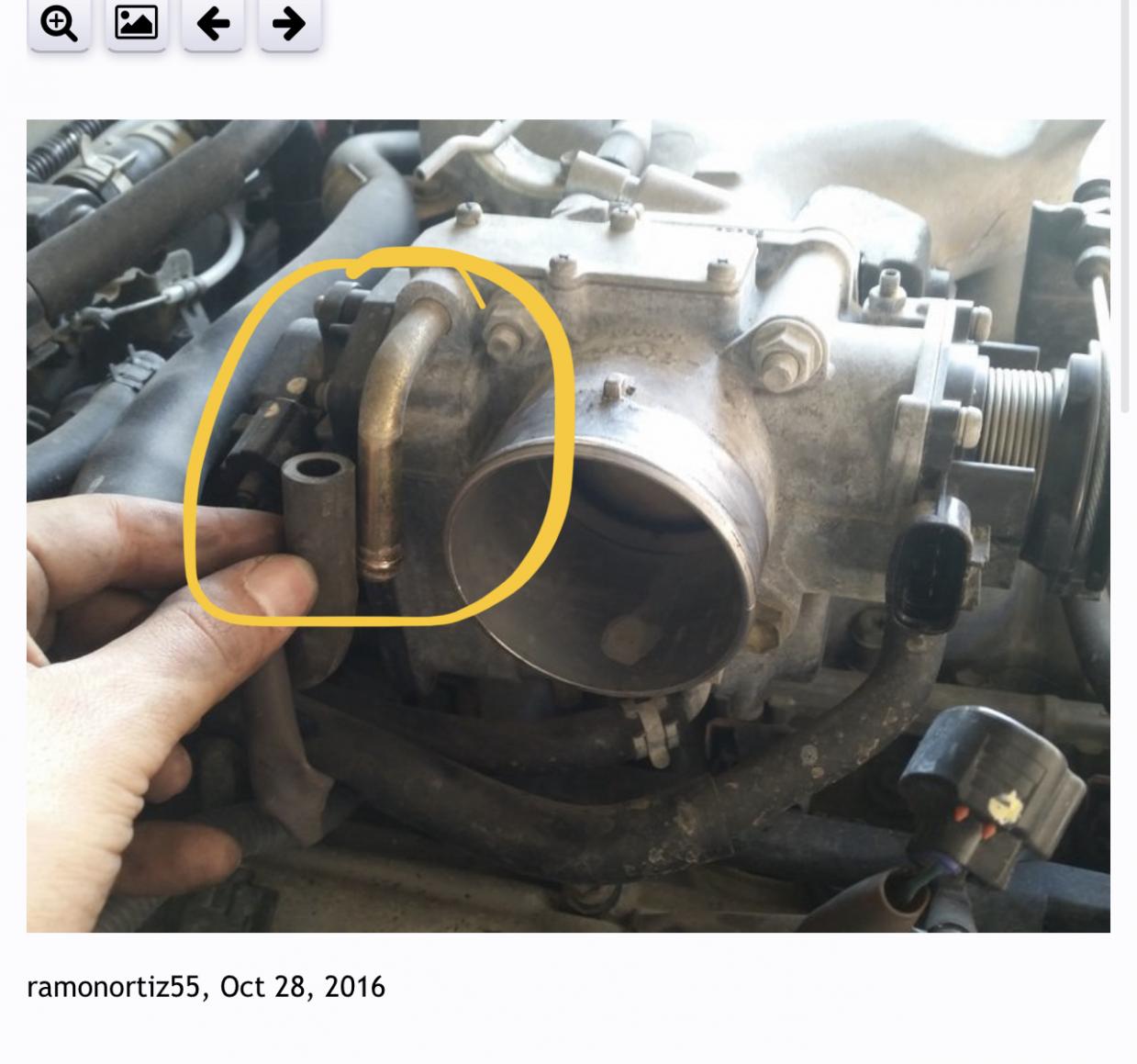

So I verified the timing was spot on, cranked the truck still same idle. I'm tearing it down to intake manifold make sure gasket there is good..after that going to try the IAC. It looks like we are only missing the hose from the y connector to the left side of the throttle body, If I understand that correctly. The right side connector and bottom are the coolant bypass,
The yellow on circled is the one I belive goes to the y connector can someone verify?

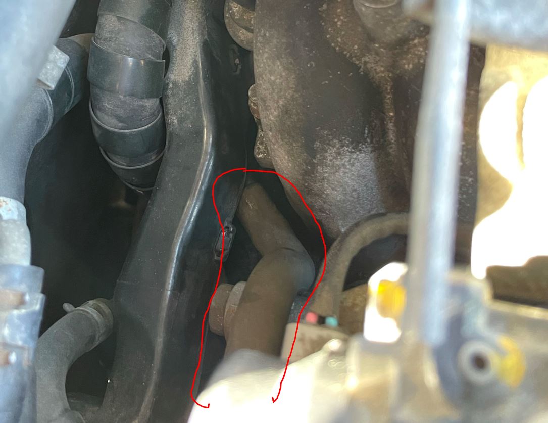

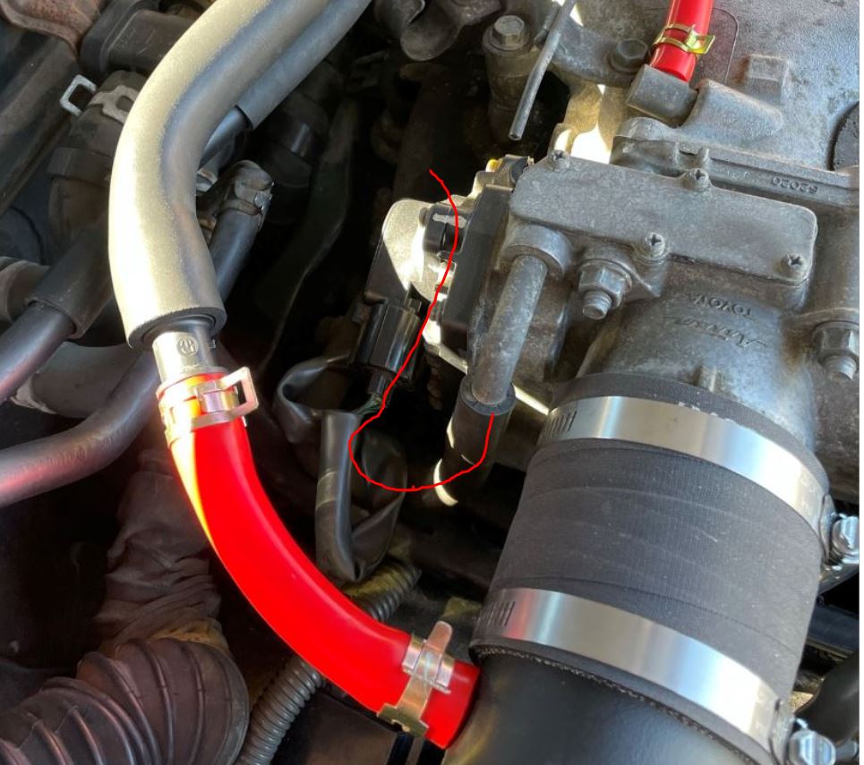

I ran out and traced mine quickly.
Here's what I've got (hope this helps).
First photo is a poor attempt at tracing the line back. Imagine it going under the TPS sensor/connector.
Second photo is where it ends up, which it looks like may be your first photo in the thread.
