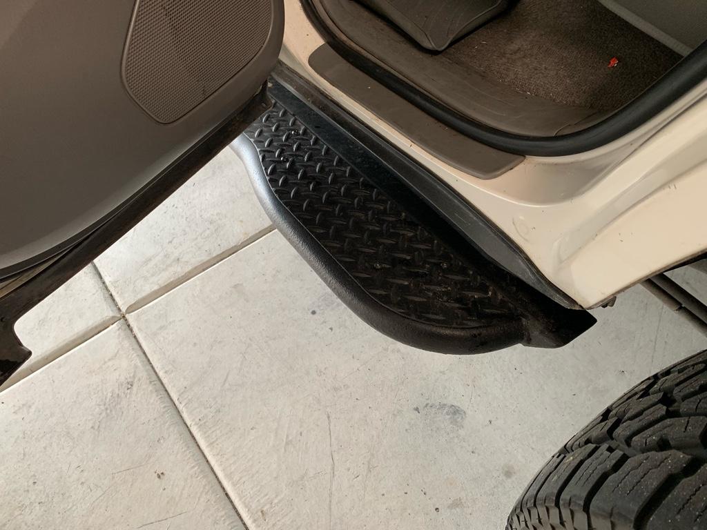

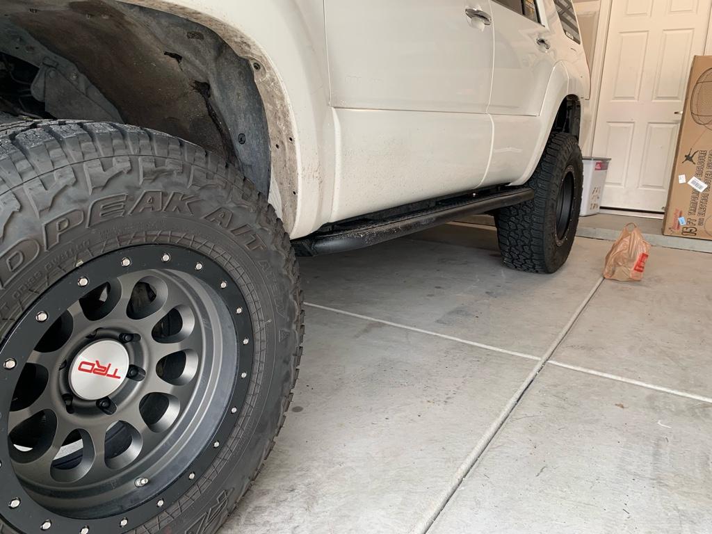

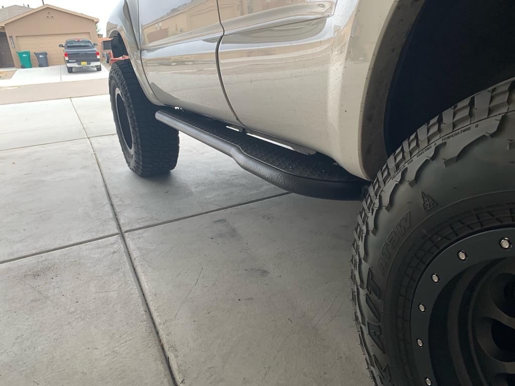

I’m not sure what the price difference is but I have White Knuckle Off-Road sliders and they clear the back door by like an inch on my 08. Very precise! Pics for fun.
