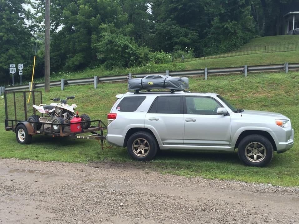

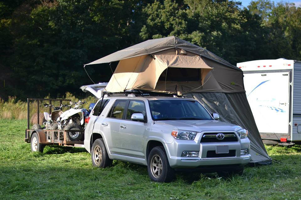

I don't have the factory rack, but the Baja flat utility rack is actually shorter than the factory rails. I didn't have any issues with the ARB bolts touching the roof, but it was a real pain in the ass to thread the nyloc nuts with so little clearance. I replaced with shorter bolts (stainless) and used lock washers with regular nuts instead of nyloc. I can't remember the length of the bolts I ended up with but I just grabbed one each in a few different lengths, went out to the truck and eyeballed them against the rack, then went back and bought a bunch more in the right length.
I use the Thule cross bars on the factory rails. Works perfect, yes its a little higher than it could be, but its perfectly fine.
Thule 45058 is the part number I used.

I agree with the above:
- get shorter bolts (or cut your current ones)
- get better cross bars so that the original mounting hardware still works
happy camping.

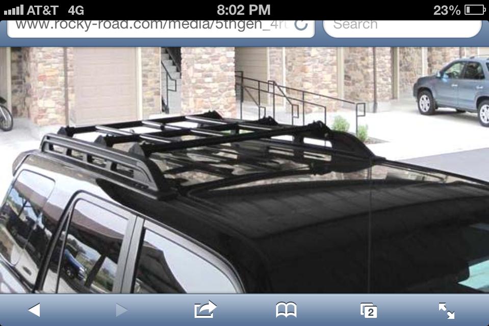

The Rocky-Road system which utilizes the factory roof rails may be the option you are looking for-
I looked at those but the issue I have with them is the height. I want to stay low profile. And the Rocky rack is more expensive than the Thule bars which has the same issue - height. If I'm going to go the "cheap" route then I'd opt for the Thule bars over the Rocky rack as the Thule would be easier to sell down the road.
