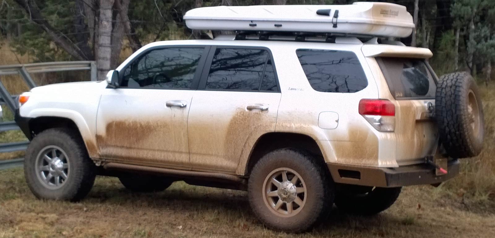

Four Rhino-Rack SXB-SILV crossbars are fastened to the factory rails and support this Baroud Evasion Evolution thru some pretty rough trails in AZ. rack.jpg

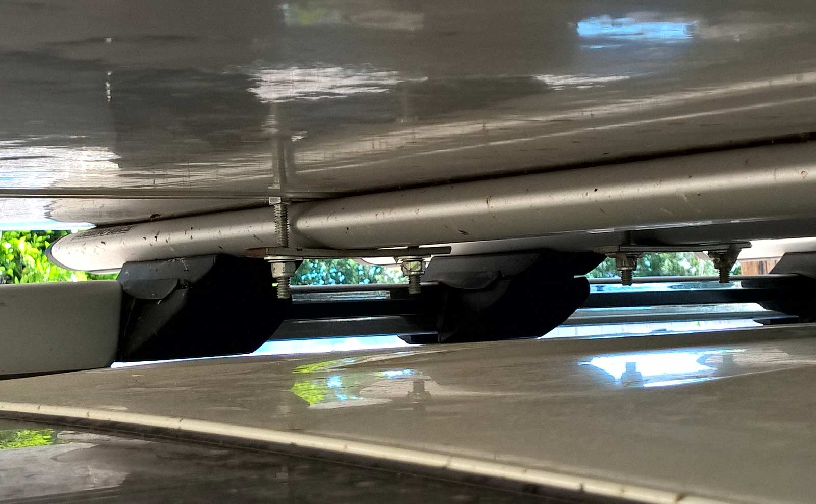

Closeup of fasteners I made anchoring the RTT, Baroud supplied hardware not wide enough for the crossbars. Minor MPG hit with the RTT, more with the full Budbuilt armor and LT tire adds (that offset the RTT CG hit).

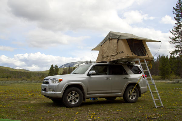

Sorry for reviving an old thread, but did you try it? I have a few trips coming and my CVT is going to beat my Gobi by a few weeks. So would like to still use the RTT, but very nervous with factory rack. I'm a big guy 6'2 300lbs... probably should just wait for the Gobi

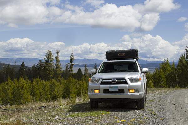

New to the forum, purchased a 2016 Trail Premium last weekend. Gobi Stealth Rack is on order, icon stage 4 on order, trd wheels on order, 285/70r17 bfg ko2's on order, and CVT Mt Shasta is on order and I am pretty sure it's going to beat the rest of the items by a few weeks (except the wheels and tires).
I'm a big guy, 6' 270. We attached our RTT to the factory rails with the supplied crossbar hardware. Me and my wife slept up there no problem.
I used my CVT Shasta on the stock rack before I got my drabbits rack. You have to use shorter bolts and it is not the easiest thing to tighten down due to lack of room. It can be done and we didn't have any problems. My wife and I used it three times traveling from Oregon to Arizona, no problems at all.
Exactly this. I forgot to mention its a complete pain to get a wrench between the RTT and roof to tighten it and you have to use shorter bolts but its doable.
