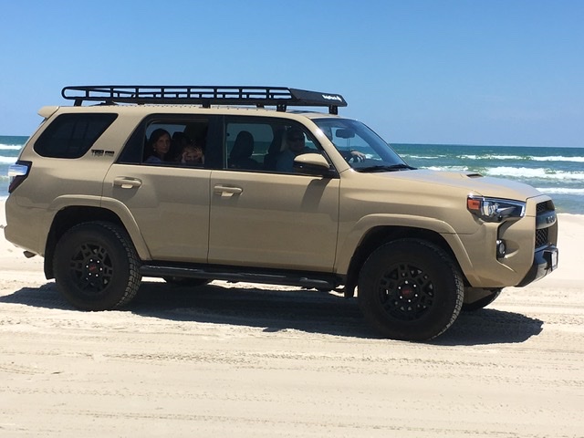

I’ve been doing a lot of searching looking for a RTT that will fit. It was in a time crunch and the full basket rack was available and in stock. I have, and do use the basket more than I would have a flat rack though. Any suggestions?

your picture doesnt work, but any basket-style rack will mount a RTT on top of the side rails, not in the basket. no rtt are small enough unless you have a MASSIVE basket.
None that I’m familiar with buddy, like others said you’ll have to mount it to the top of the side rails or some top-mounted crossbars. If it’s their standard 5” tall model I wouldn’t worry about it too much, shouldn’t be too too bad. Otherwise you’ll be wanting a lower profile rack, unfortunately.
I’d probably suggest a hard shell if it’s going to be mounted higher, keeps the overall profile lower.
Also, found this, could be helpful; https://www.toyota-4runner.org/5th-gen-t4rs/256190-bajarack-5th-gen-rtt-clamps-$70.html
