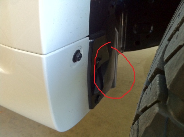

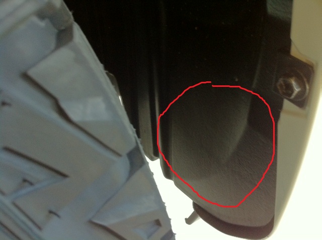

what can i do to eliminate the rubbing in these two parts when turning full lock side to side
i know there's cutting.. (dont want a hole there)
heat gun and mallet? ( sounds painful)
read about shifting the fender? (have no idea how or which way)
please help me guy :whipping2

it looks like he cut the bumper not the liner..
should i just move the liner forward? mine should not be rubbing the bumper after liner is fixed
what about the back side liner.. the 2nd pic in my post??

The SR5 bumper and the Trail bumpers are different. I've tried what harper did, and the liners are different so they won't go forward that extra inch. Your best bet is just cutting like I said in my pm.
thanks
what about the back side of the liner?

No rubbing with this setup but rubbing with spidertrax added back. Im the spots shown in pics.
I guess ill move front liner foward but not sure about the back side of the front liner.

The spidertrax moves the wheels outward ,moving the the sweep of the wheel outboard 1.25" and causes the rub there in the back.
Did you have your truck aligned after the lift yet? You need to after any lift as the camber and toe changes and your front tires will wear on the outboard edge.
When you get it aligned next time ,you need to ask for max pos .caster and that will move the front wheels forward. It's 4.0 for our Runners by Toyotas specs with 4.0 being something to shoot for. Each degree of Positive caster moves the wheels forward approx.1/4".
Some have taken a heat gun and reformed the plastic liner or cut it out too.
