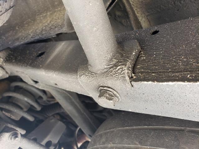

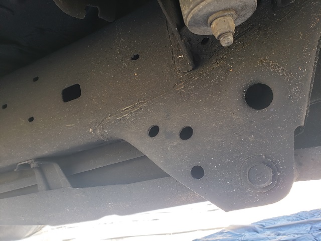

Not sure what region you're in, but I'm in Massachusetts. My 3rd gen 4runner has about 380K on the chassis with no rust. I just coat it with WD-40 every year before they start salting the roads, I've been hitting it again in February, but not necessary really for me cause of my long acquired skin of coating, but I do it a 2nd time anyway. My undercarriage is black and solid. Just a $20 gallon of WD-40 is all it will take to keep it solid. The WD-40 will seep into all the fissures and lifting undercoating and protect it. Just keep it coated and you're good. I actually just coated mine yesterday and I took pics before to show how good the coating holds up.
Here's my write up on how to do it -
SEASONAL RUST PROOFING using WD-40 only
