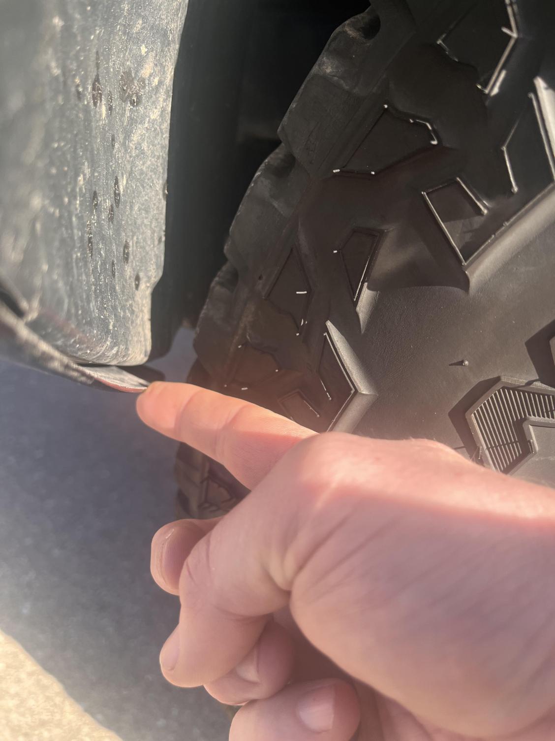

Finally, finally I upgraded the suspension. Here's the kicker. backed down the in-laws driveway and have rubbing on the driver's front. Anyone else have this with stock tire size, wheels, and control arms? I've read all the threads about rubbing with bigger tires but still stock???

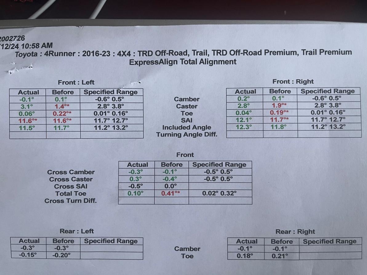

and I know you're going to ask about alignment. Work on Saturday, aligned on Monday

It's a common rub spot. Trim the plastic a bit.
I can't find the document - but Toyota used to trim the bumpers at the port for the TRD Pro models because it only took the slight change in wheel offset to rub in that spot. There is a Toyota document that has a little guide for dealers where to trim to avoid that rubbing. In your case - grab a box cutter and cut about 1/4 inch off that inner bumper edge. Mark out first with masking tape to help you get a nice clean line.

Not a lot of wiggle room for knobby tires with near stock suspension height, so trimming will most definitely be needed. Get comfortable with a dremel and a heat gun, take your time and plan out where you're cutting, put some painters tape over the area and measure out your line so it's the same on both sides before cutting.
Also, you could have a touch more caster, especially on your passenger side, which will make the problem worse (ie. slightly more trimming) but your vehicle will track better on the highway.
The amount you'll need to trim to make your current setup work will be really minimal. You could quite likely just trim off that little lip at the bottom of the wheel well and be fine. Cut it off flush with the wheel liner and don't worry about it again unless you go with bigger tires or a more aggressive offset wheel.

This puts my mind at ease that it's normal for stock in a similar scenario. I'll get to trimming. I suppose there's some good news down the road. If I ever go bigger tires then I'll have more trimming up front but less likely to need a BMC
Appreciate the help!

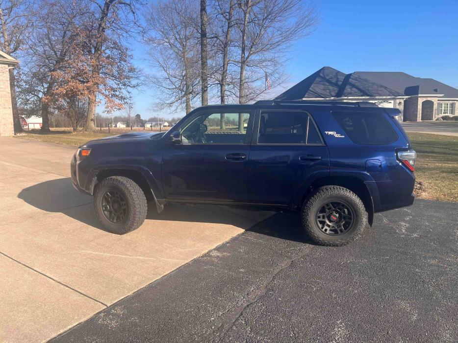

it's hard to tell from the pics, but are you running any wheel spacers? it kind of looks like the wheels are sticking out farther than stock.
Only change from factory was the 6112 coilovers, no spacers.
Took everyone's advice and did some trimming. Should be in good shape now.
