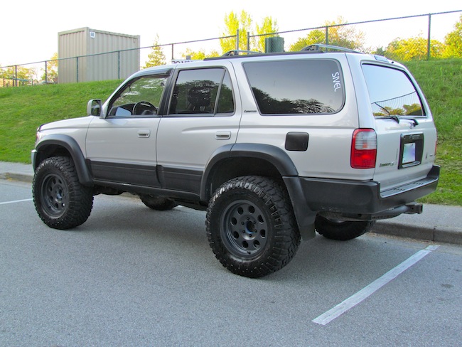

I just LOVE the look of this picture
<a href="http://www.flickr.com/photos/retrospectphoto/6171127755/" title="20110920-IMG_0268-2 by RickaShay24, on Flickr"><img src="http://farm7.staticflickr.com/6156/6171127755_7d05c2af2b_z.jpg" width="640" height="427" alt="20110920-IMG_0268-2"></a>

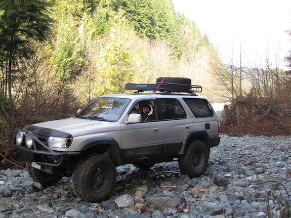

I ran tacoma 5100's on the highest setting with a 1/4" top out spacer with stock coils for one year. I had 1" of rake with ome stock load coils and Bilstein hd shocks in the back. My ride was quite stiff. I had zero brake dive on the front. I put a badlands bumper on and it did not settle down at all. I have since swapped in ome 883 coils and dropped to the lowest notch and it is a softer ride. I have 1/2" of rake. Good luck with your choice. Here is before and after pics.
