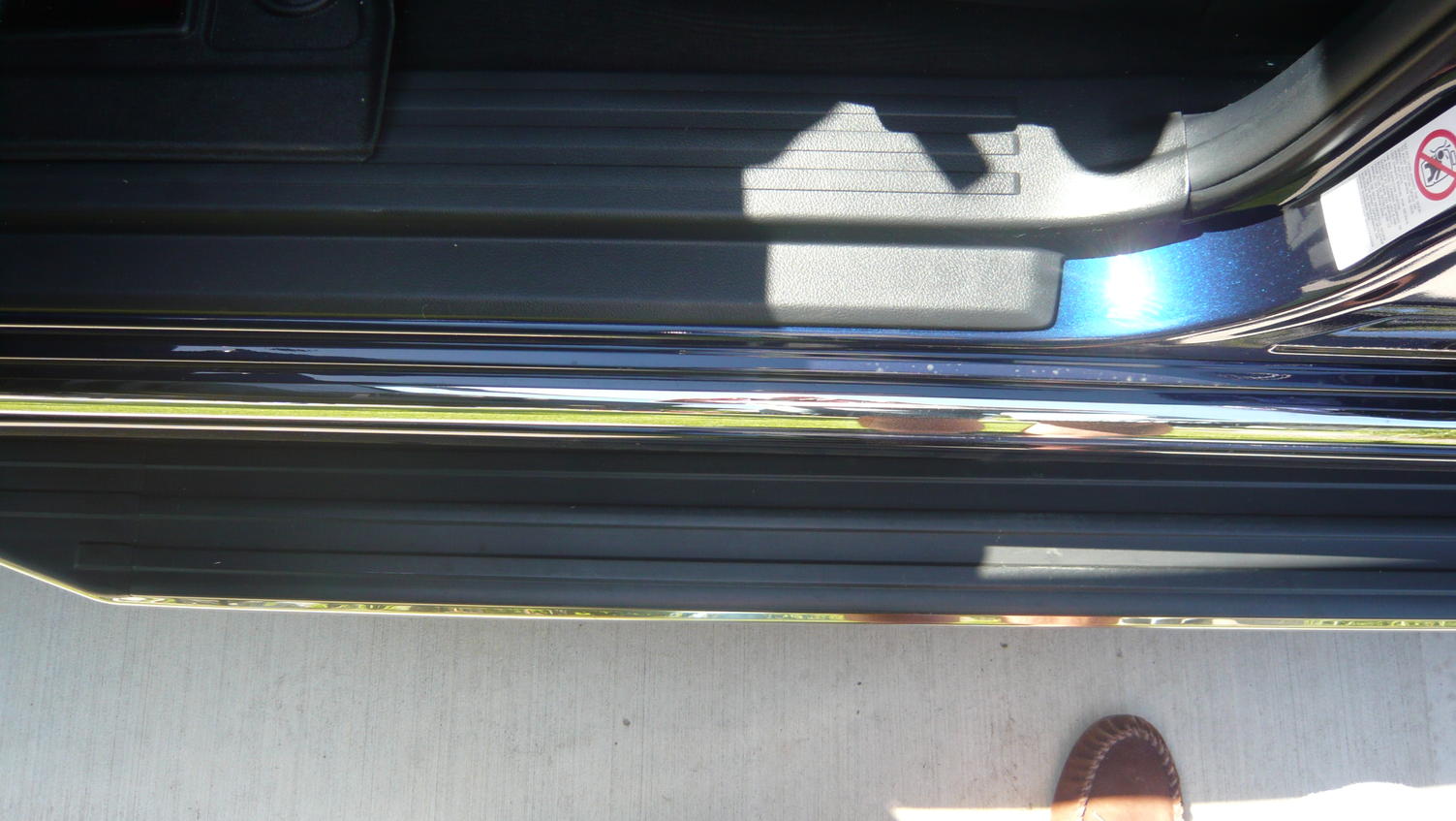

I ordered not only the Tyger 69" boards but also I ordered a set of the Dee Zee brackets. After looking them over closely I am convinced the boards will bolt on to the Dee Zee brackets and ride a bit lower and farther out. If it works the way I want it could be the ideal solution - the classic running board style only a lot more functional. Maybe when this is done I will post a few pics of the results so others who might have this same issue can see. The problem I've found with running board pics all over the web is that you just can't get an idea of how much foot space you really have, once the doors are open.

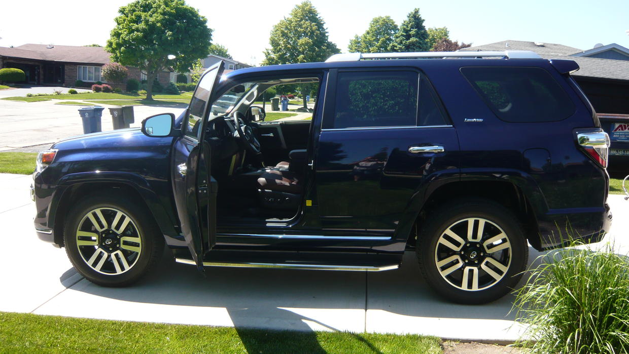

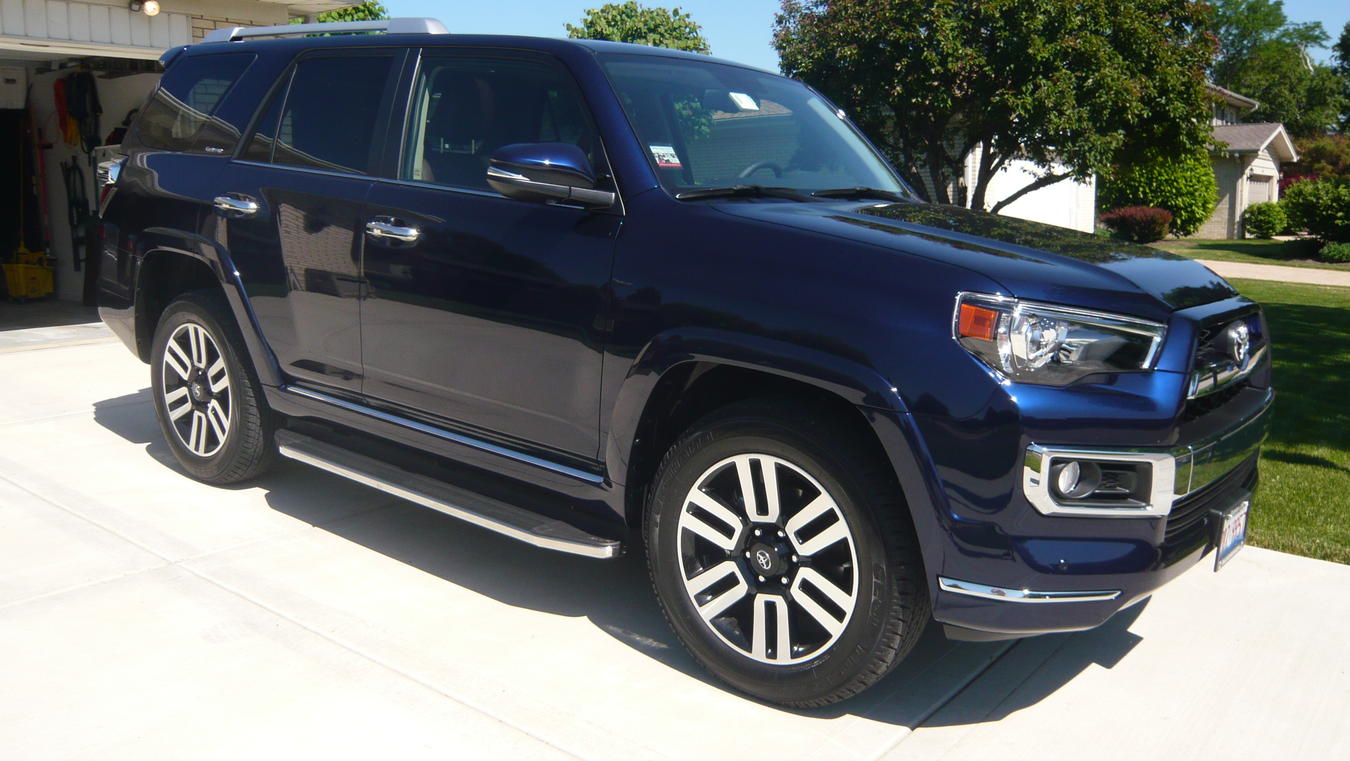

I got all the parts together and put the boards on last night. It could have gone more smoothly and would have, had it not been for the fact that
1) Amazon sent me a beat up set of brackets which had to be replaced, and
2) the Tyger boards came with garbage zinc hardware (snapped a bolt easily tightening them up, then ended up replacing all the board-to-bracket hardware with stainless steel)
Otherwise, beside the fact I took it all apart to replace the zinc crap, it went together pretty much as I expected. Shame I couldn't use the included Dee Zee hardware to mount the boards, but it would have required a lot of grinding (thus heating the bolts and compromising them). I ended up running to the hardware store and buying stainless M8x1 bolts, the 10mm hex heads of which slid right into the tracks. But, since they were hex not square head the surface area in the track is reduced, so I took SS washers and ground 2 flat edges on each and slid those in with the hex heads. Still not sure I'm 100% with the final solution, but I tend to be a perfectionist. I'd like to see meatier hardware in general with these boards. It's at least as strong as the Tyger setup, with the HUGE added benefit of those beefy Dee Zee brackets in place of the cheesy Tyger ones (the Tyger brackets are similar to the OEM ones, undersized for the job IMO). I also used blue Loctite on the undercarriage bracket bolts and the threads of the hex bolts holding the boards on.
[edit: after a few days I found I had to use a bit of silicone caulk on the gap strip where the rubber meets aluminum to keep it in place, it flaps in the wind at highway speeds and was inching backward.]
The net result is, I have running boards with the look I like that are in a functional position on the truck. I like them, and my wife can get in AND OUT a lot more easily. For that matter, so can I. I did lose ground clearance, as we all knew I would, but I really have no intention of off roading. I don't think they will get in the way in the snow but if they do, I will cross that bridge then.
I'll post a couple pics later.

Finished product. Looks good, seems very solid. I also added a bonus pic of the interior as I think the nautical blue/redwood combination makes a great vehicle that much better. Truth be told I do think I'd rather have 17" wheels with a more appropriate sidewall tire, but a lot of people like the 20s and have commented on them to us.
