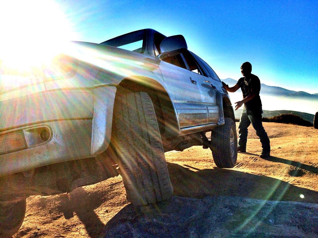

Wondering if anyone wheels without a rear bumper. I have a stock 2000 4Runner Limited with the E-locker. Also have the tow package. Today I went out wheeling Cleghorn trail in the San Bernardino mountains. On a lot of the steeper hills and bumps I would hit my tow package pretty hard. It probably saved my ass a few times though. I want to remove the tow package but I don't want to slam my rear bumper. Could I remove just the middle part of the bumper? Or does the whole bumper need to be removed? Would it look weird without the bumper? I plan on building a hybrid bumper soon so I won't run it like that for long
Here is a pic of it fully flexed. The rear tire is off the ground

Just remove the tow package, the bumper will only scrape on the bottom. If you are worried you can actually attach stuff like a strip of thick steel or slippery plastic cutting board. to the very bottom lip of the bumper using the conveniently place holes.
Notch out the rear bumper and flip the hitch over. I hit mine a lot too but I'd rather hit that that other parts.
We call the tow package on the 96 the hittin' hitch.
Even with the hitch flipped and a decent lift it still gets its lumps. When the spare used to fit underneath the hitch helped protect it.
Not all hitches are flippable- or would improve clearance if flipped.
A lot of guys running 35's remove the rear. I see them driving around and it dont look that bad. DO NOT LEAVE the end caps of bumper if you remove it. IMO that would look very weird.
I hit mine but it saves your rear end. The rear stock bumper is made of soda can thickness and if you dont have a hitch it will crush once hit. Im about to get a tube rear bumper and have been waiting till then to remove it.
I'm not running a rear bumper right now since I am in between bumpers. I don't mind the look, but I hate that everyone likes to ride my ass still and I don't have a hitch. For onroad its fine, but offroad having a hitch is nice to protect the rear and its also a recovery point
