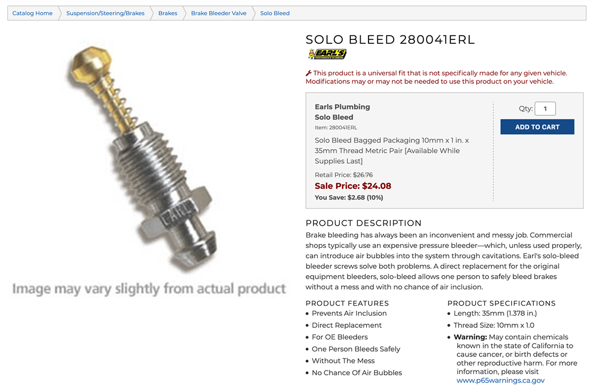

I was looking for speed bleeders for my 199 TBU. Local place can get Russell 639560s for $12/pair but has this Earl's Plumbing bleeder in stock. Looks like a different design with more moving parts at twice the price. I'm leaning toward Russells as that's what I've read about here. Plan was to do the TBU tomorrow but I'd have to wait for Russells. I've already put this off way too long!
Forum search turns up nothing about Earl bleeders. Anyone have any experience with them?

The Russel bleeders will have the check ball and spring internal to the body - it has the same number of total parts. Either one should work just fine. Make sure you have some thread sealant on the threads so that when you are bleeding, it goes out the nipple at the top instead of around the threads.

These are the only speed bleeders I worked with. I went with these because they make then in stainless steel. As per my environment. These were my best option. Even come with tread locker on them with the check ball bleeder cover too.

ive never heard of the "earls".
not good to mess with brakes on a unknown name....at least for me anway

You haven't heard of basically the oldest automotive performance plumbing company? They were basically the company that brought AN fittings to the automotive world...
