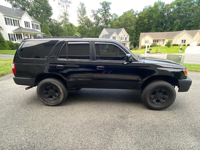

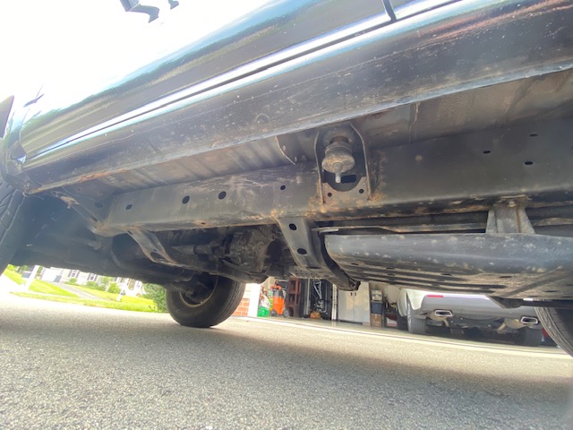

Things are changing so I'm looking to sell (change of employment and location), so wanted to get a fair and honest perspective on my rig.
I know the CarFax shows some time in NY, but as a newer 4Runner owner, this looked to be pretty clean after some searching on T4R. It does show some rust on the passenger side fender at the door, but otherwise pretty clean.
Thoughts?

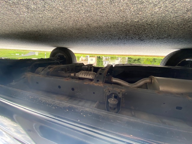

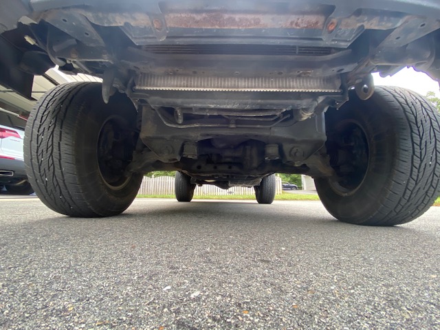

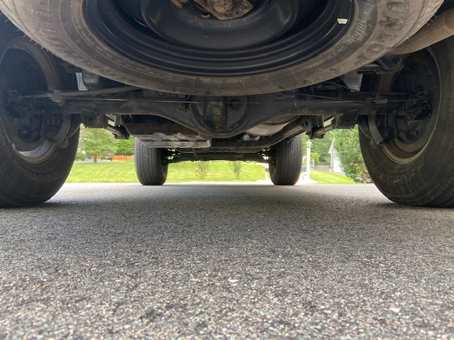

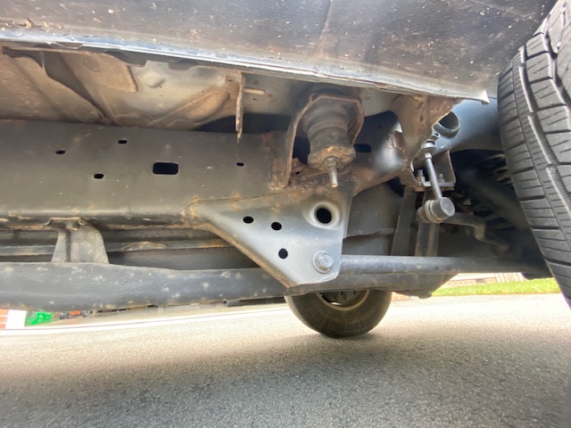

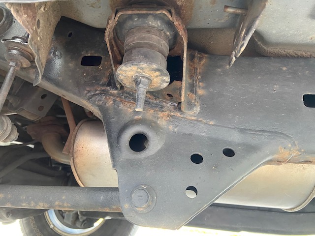

That looks pretty good to me. Take a good look at the inside portion of the rear lower control arm mounts especially the passenger side one. I'd still probe around with a hammer just to make sure it's not rotted out from the inside. Doubtful, but you never know.
Yeah not Too bad considering where it spent some time.
As Bad Luck said, poke around on the trailing arm and any area with holes, still looks solid enough to be legal and safe. Luck.
That frame and whole underbody looks fantastic to me and should be a strong selling point to anyone interested in buying it. I've fixed way worse, patched rusty frames, and even replaced my rear axle due to rust...this one's in excellent shape!

Well it sounds like there are some real 'rust buckets' out there! And you sir, have some fantastic mechanical skills to repair at that level.
I'm not sure yet, I'm wanting to get some basic maintenance done (fluids, LBJ's, sway bar links/bushings, steering rack bushings, and all fluids), before I end up selling it.

Just bought a 2001 and found a rusty spot that I bet is common. Driver side, inside, next to fuel tank but forward of rear trailing arm attachment point. Hard to see or photograph but easy to feel for corrosion or holes.
