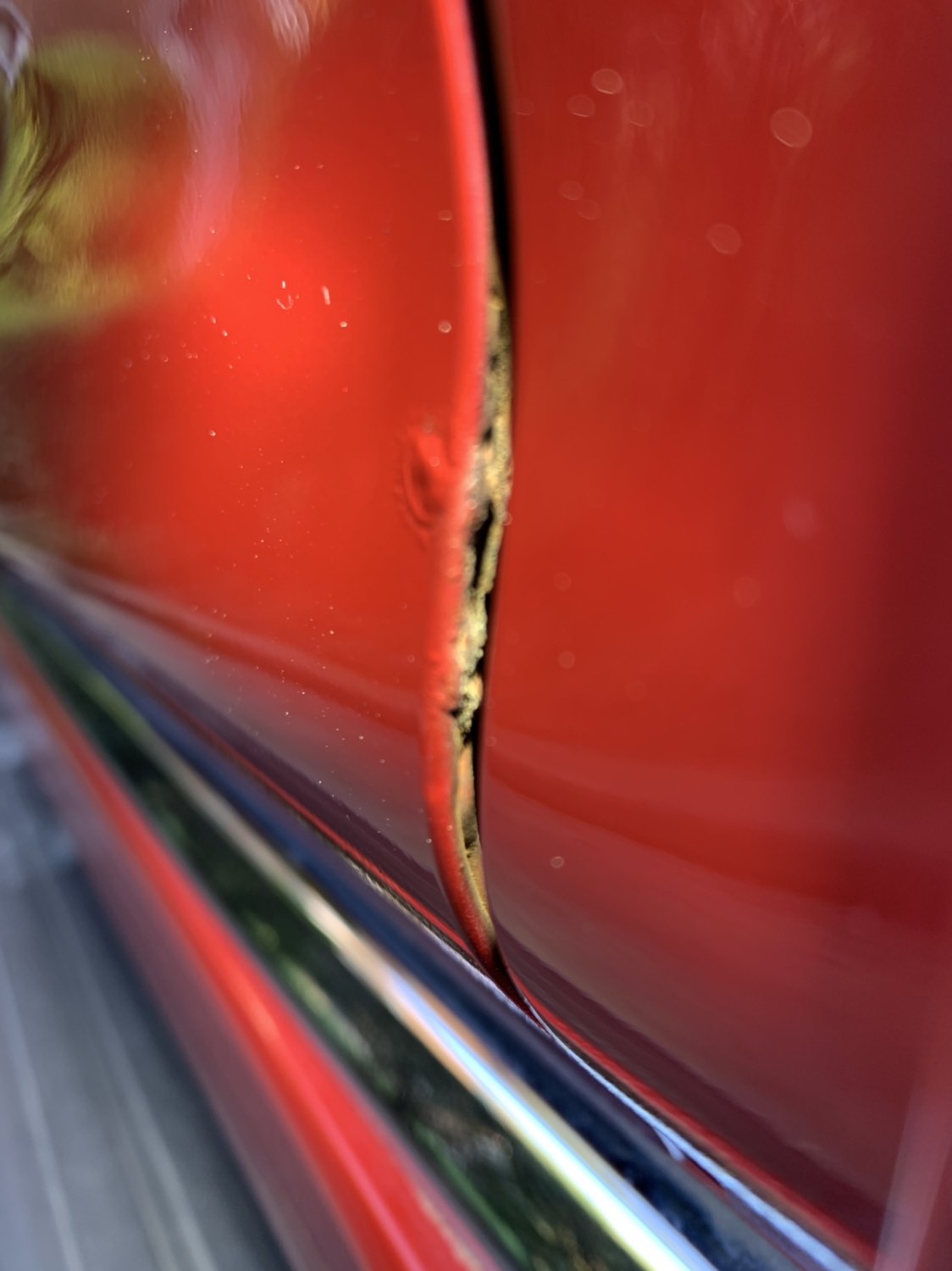

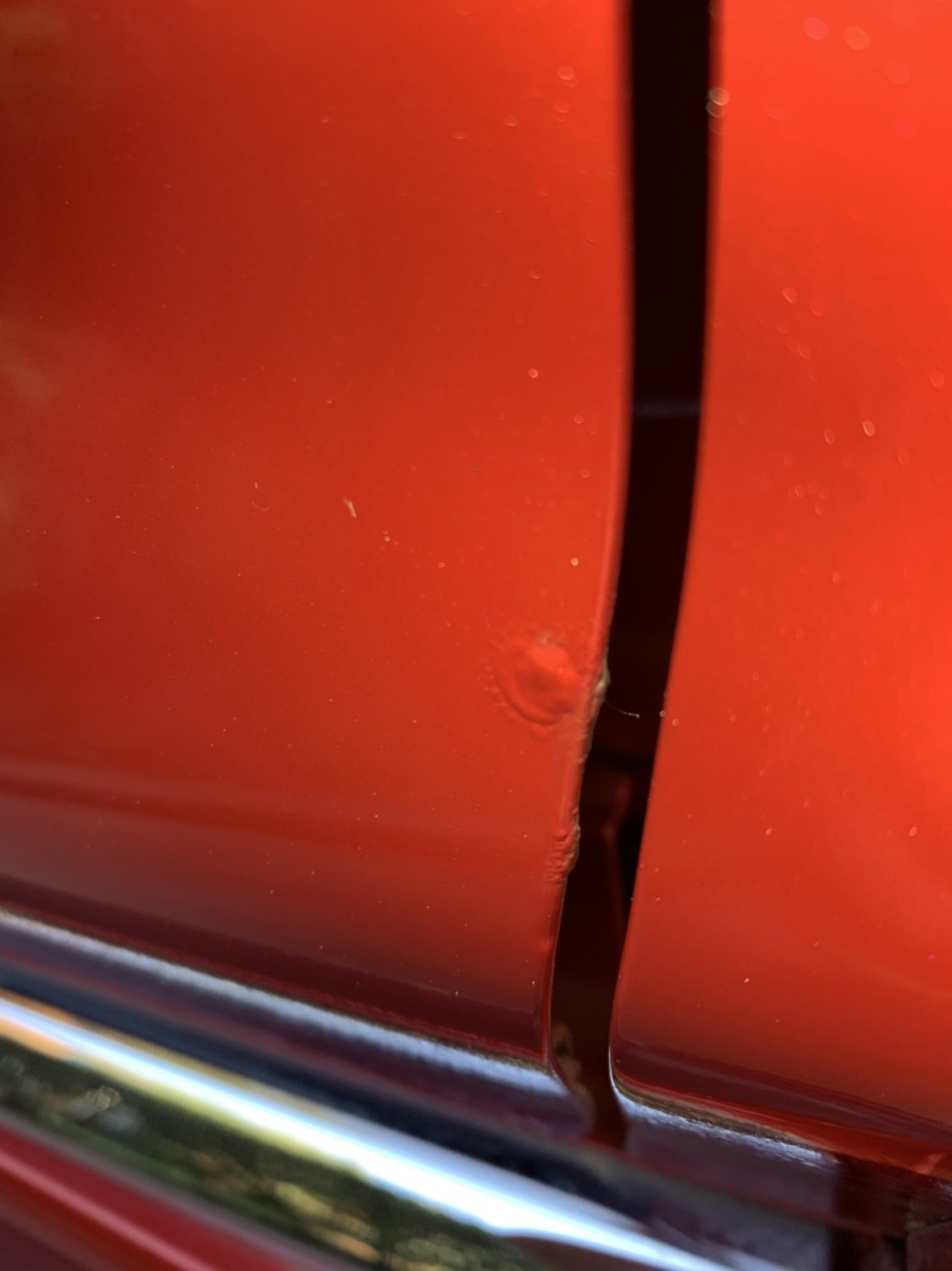

Is anyone else having problems with rust on a 5th gen? My Limited is rust free except one door. I’m taking it into the dealer this week and will have them look but I don’t think they will repair it under warranty. I’m thinking there was a defect in the door seem. I’ve owned this thing since new and have always babied it and the miles are very low. IMG_9723.jpgIMG_9725.jpg

The car has never been in any type of accident at all and has zero dents or scratches. I'm in PA so yes, I'm in the snow/salt beltway. But I also wash and wax my 4Runner throughout the winter and it's kept in a garage. The way the door seem has split open makes me think it's a defect in when the door was assembled or how else would have water gotten in and rotted it? There is no rust anywhere at all on the vehicle except the one door and it's not even the bottom of the door, it's along the side where it meets the front fender. If you saw this 4Runner in person, you would swear I just drove it off the showroom floor, never abused.

Just a quick update to anyone who was curios. The dealer and some higher ups with Toyota examined the door and have found it to be a manufacturing defect and are taking care of replacing doors and are covering everything under warranty.
