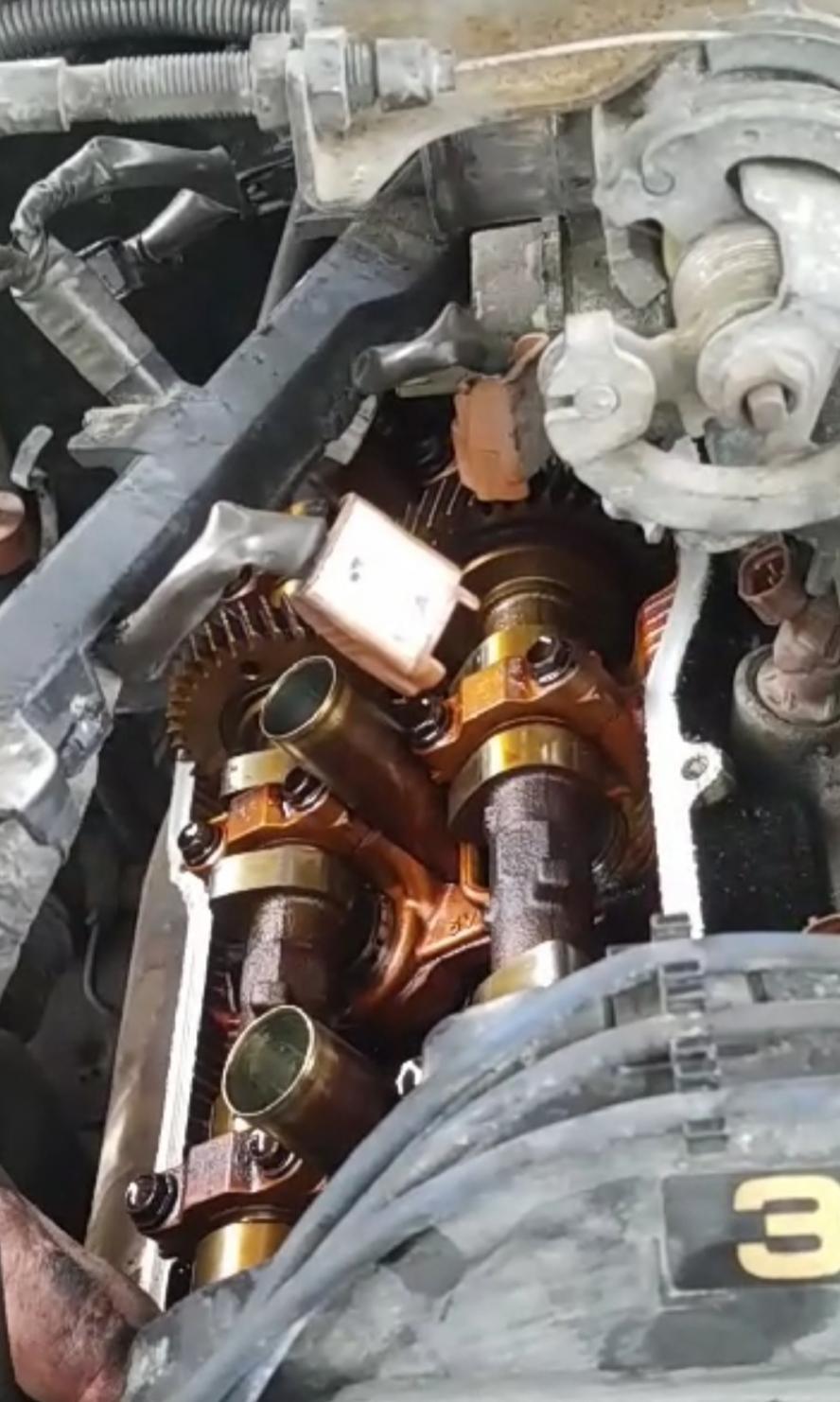

There is rust on the cam shaft lobes. I barely know how well this engine was treated, but the last owner wasn't super ideal to say the least.
There is rust on the cam lobes, the timing chain tensioner seems pretty far out too. The engine is 23 years old with 177k. The dark spots in the photo aren't oil, they are corrosion.

The dark stuff is just varnish. It actually doesn’t look bad — no sludge or deposits. Just some stain from slightly over long oil changes. A few fills of full synth (diesel spec is best) may reduce it over time.
Try to count the exposed teeth on the tensioner. It looks about how mine does but it’s hard to tell.
Are you talking about that orange coloration? You realize that's just varnish right? Pull the covers off any valvetrain of similar age/mileage and it'll look very close to the same, especially if they use conventional oil. The only way they could possibly rust is if water entered the valvetrain and the engine sat until it fully dried out, in which case you would've notice a lot more problems before now
The spark plug wells aren't super uncommon; just how they seal up. Moisture gets in one way or another but can't get out

I've owned it for 12k miles and I've probably done 3 or 4 oil changes, 2 with synthetic oil. I think an seafoam oil treatment might be in order. I think your right about it being varnish, but there is definitely corrosion on the inside of the valve cover.

It's all varnish. There is no corrosion on the engine internals or the inside of the valve cover.

If you're talking about light pitting here and there that isn't corrosion nor uncommon with older vehicles that have potentially been neglected at one point. Very common with age regardless. I don't see how steel would corrode in the presence of oil unless you're using straight crude
The steel internals only rust if an engine sits a long time without running or being spun to coat the parts with oil.

Looks like a great engine. The only (incredibly minor) corrosion I saw was on the inside of the spark plug tube. Still not an issue.
Do the next couple oil changes with Rotella T6 and your engine can look like this inside (250k miles of dino oil, then 20k of T6):
You can see the varnish is still getting cleaned up, but much of the engine is quite nice already.
