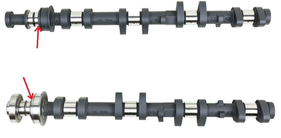

This is how I interpret the issue. In the picture below I've pointed to a thin flange on each camshaft. This flange has a bearing adjacent to it, the idea of the flange being to limit the camshaft's lateral motion.
That bearing cap is aluminum, and the flange is very thin. Any tilting of the camshaft while it is being removed puts a strain on the flange and the cap, possible breaking one or the other or both.
The strain would be worse if the springs exerting the force were at the far end, cylinder #4. More leverage.
So, for removal the cam is positioned (read the FSM's directions on aligning dots on the sprockets) to exert the least amount of pressure, ie the most valves fully closed. And those valves that are open to whatever degree are in the center of the camshaft, ie cylinder 2 or 3.
Everyone has seen a magician levitating his assistant as she lies, supine on his table. Imagine that's what you're doing as you loosen the bearing caps, and the lovely lady will die if she gets even one degree from absolutely level.
You don't want her blood on your hands.
