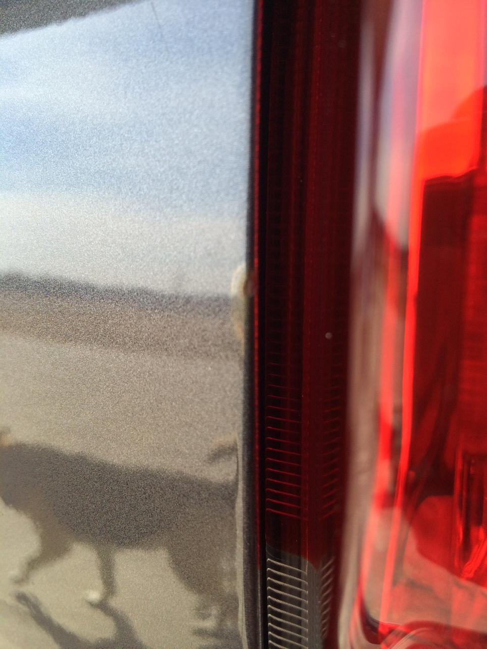

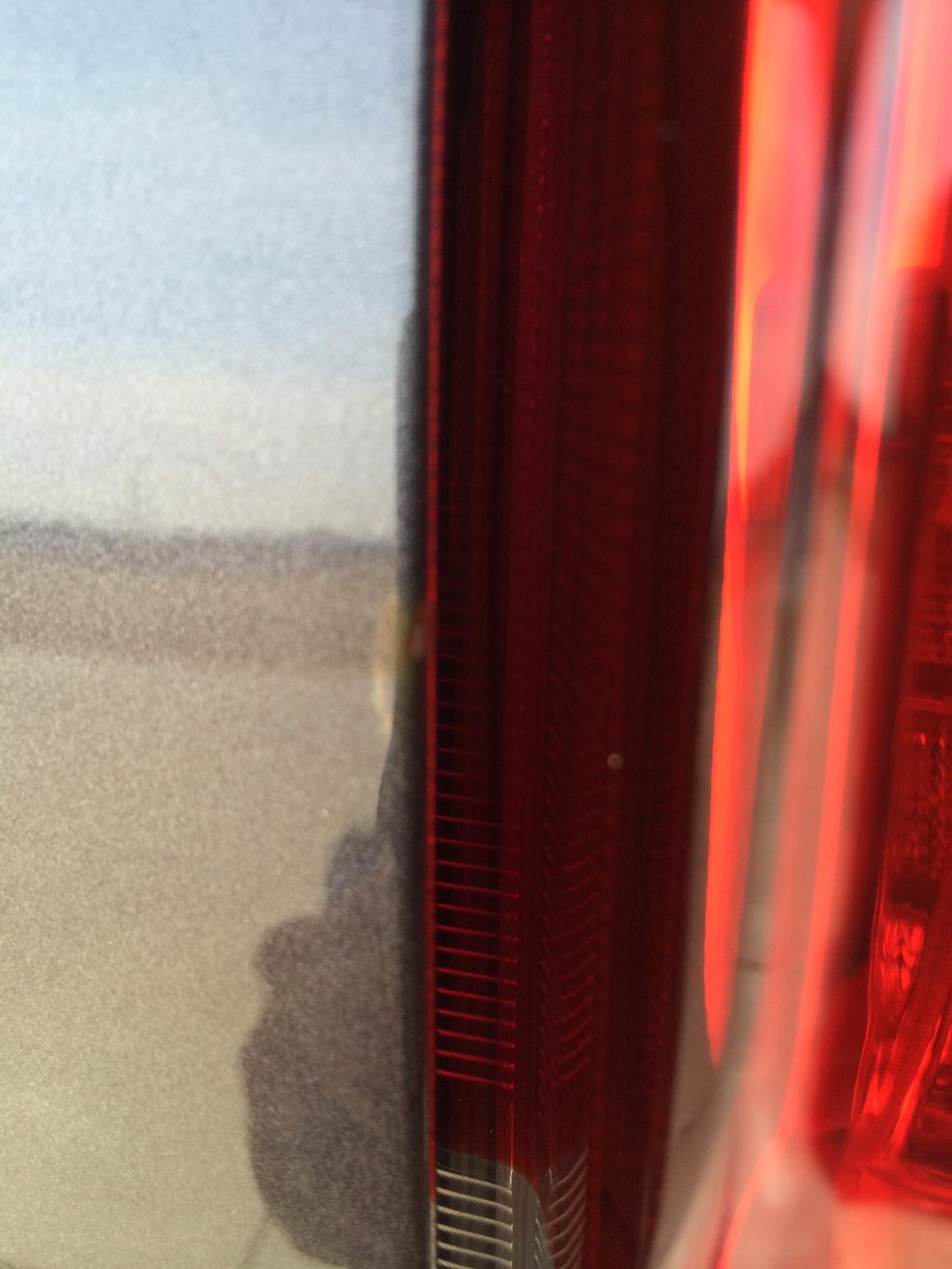

Just noticed a very small spot of rust beginning to form just level with my rear tail light. About the size of a pen tip.
It's located on the very edge of the lift gate.
Haven't contacted the dealer yet, any suggestions on how to approach them? It's 2011 limited with 40k miles.
Oh and I am a waxing fanatic so this really shocks me:(

I'm literally at my dealer right now doing my 20k service and pointed out a tiny rust spot. They actually pointed out several more to me that I didn't even see.
They are going to have it sent to get fixed and repainted. He said he's been seeing quite a bit of them with rust already.
Sounds like I won't have to do anything to get it fixed.
I'll chime in once it's done though.

Well I dropped my runner off today at the dealer. They sent it off to the paint shop to get fixed. I have a feeling this will not be the last of this problem.
I took mine in yesterday. I had to take it to the Toyota collision center for some body work anyway and stopped by the dealer about the rust on the lift gate. The service manager quickly came out, looked at it, correctly identified what was going on (rear emblem not spaced properly and was rubbing against paint), and said it would be covered by warranty, no questions asked. He said he has seen this on other 4Runners and he would have the body shop fix it and properly space the emblem so it hopefully does not happen again. That's all I can ask for, and once again, I am very impressed with this particular dealership.
