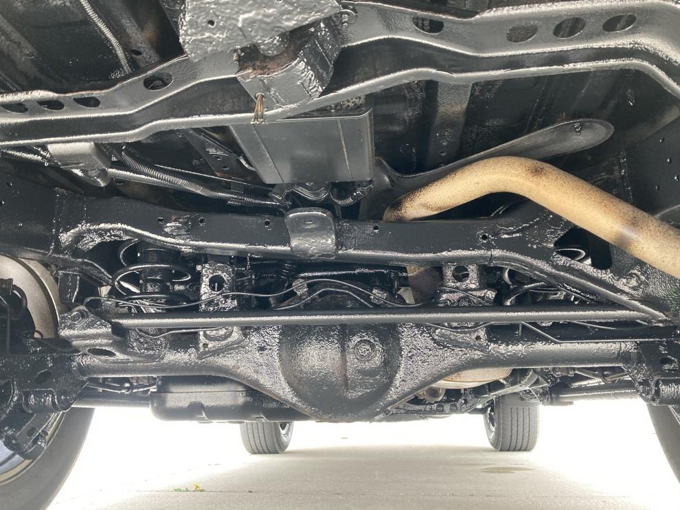

Your frame looks as good as my ‘07 Limited V8 with 172k. Primarily some surface rust and rust at the welds but no structural rust. I had Wool Wax Black applied a couple weekends ago. A local rust proofing retailer did it for $180. I am vey pleased with the outcome. He uses both Wool Wax and Fluid film but prefers Wool Wax as it is a little thicker and he says only needs touched up every 2-3 years whereas Fluid Film should be done every year....and FF smells really bad vs. Wool Wax. He says not a lot of prep is needed with either product. Just knock off the loose rust by tapping with a hammer and then wire bush the smaller loose pieces. Took him a half hour to prep then an hour or so to undercoat and spray in the doors etc.
