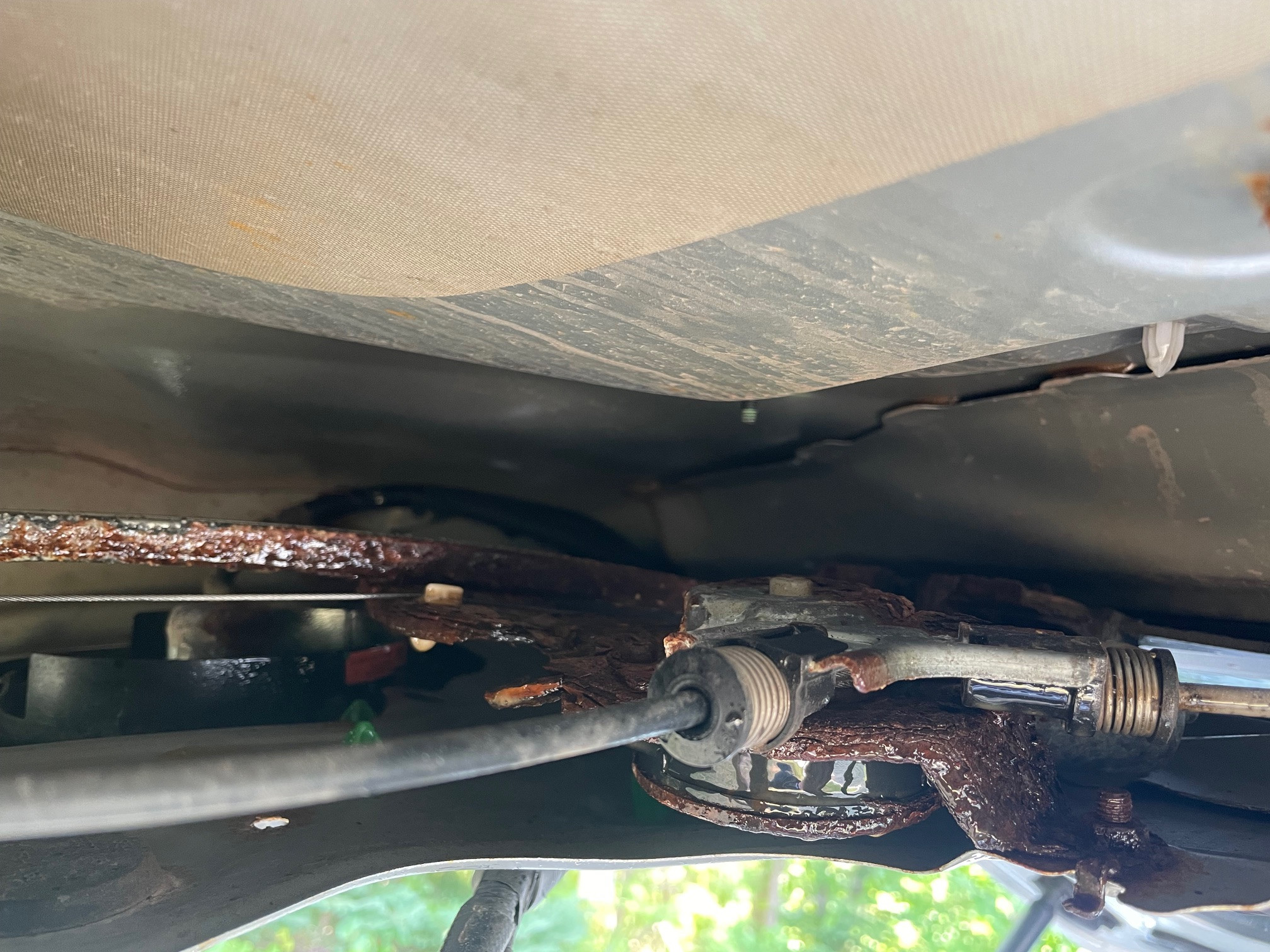

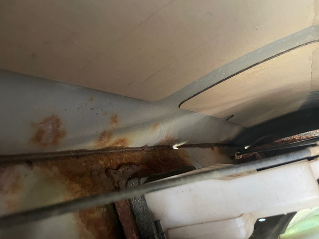

hi all,
i bought a 2018 limited a few months back and i noticed some rattling in the rear hatch. turns out it was loose rust from a few rear window wire mounts. i took things apart a bit and noticed a lot of rust around the latch area especially on the inside of the hatch.
my plan for now was to remove the latch assembly, clean/brush up the area, apply some sort of rust protectant and monitor it. i don't want to get into removing the window mounts right now if i can avoid it, maybe for phase 2. the rust looks a little more isolated in that area although they're nasty for sure.
any ideas on how to address this? i wasn't sure if i should use por15 or fluid film or something else. hopefully not too late to get it under control.

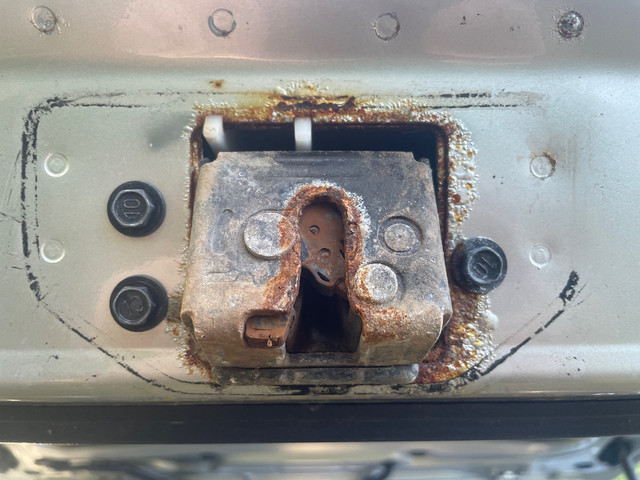

Rear door latch assembly exterior

that is a surprising amount of rust on a 2018... what spartacus said is the proper way to do things here. but if you don't want to put that much effort into it I would just hit it with fluid film and call it a day. I use that stuff on the pinch welds of my door, inside the hatch and inside the doors... that stuff really does not evaporate or run off. if you put a nice coat on there it will stop the rust is contacts (it should penetrate the rust and protect). what I've done in the past is take out the hand grips in the hatch and spray in there...
edit: this is why I still think the roll down window is overrated... likely the cause of that rust is water in the tailgate through the window seal
Grind the rust off or use rust neutralizer or reformer then paint it with marine paint.
Rust neutralize/reformer is phosphoric acid, sometimes called navel jelly; it dissolves the rust and you can wash it away with water. That still leaves the remaining metal unprotected.
What I use is a zinc rich primer. That used to be called cold galvanizing compound. Then top with the marine paint. I have never had metal re-rust after using zinc rich primer.
That latch is done and should be replaced. It will stick and then burn up the actuator which will then need replacing. I have replaced both on our 2014 and it’s easy to do. They say to prevent this you need to replace the seal at the bottom of the window.

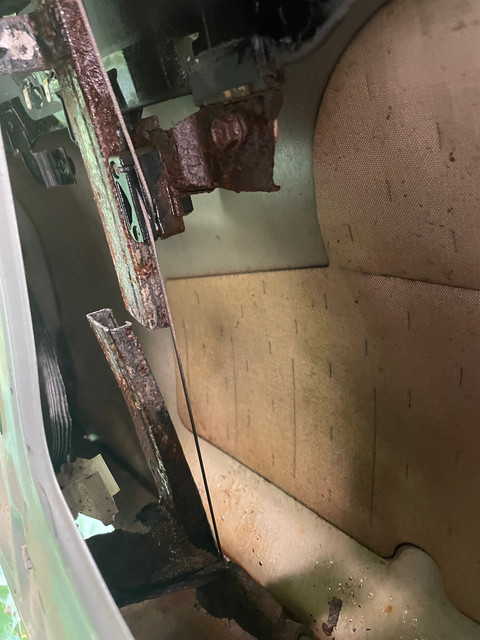

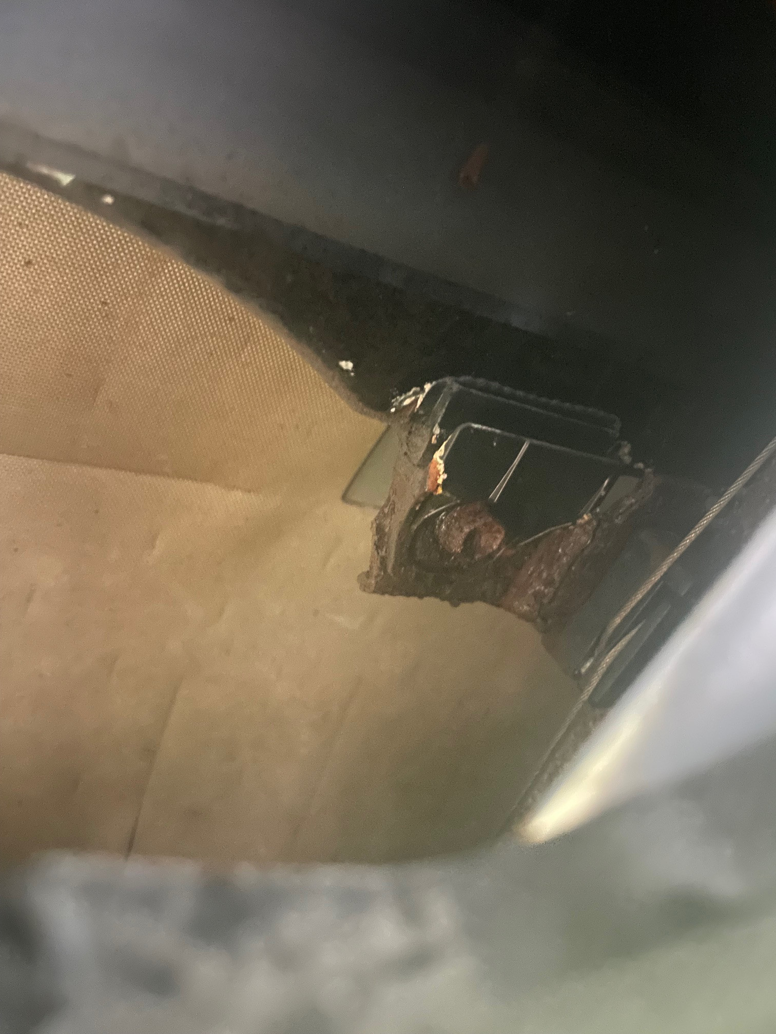

i got things apart a bit more today. the rust inside the hatch itself isn't that bad. but the rear window regulator is shot. mounts are rusted badly, as well as the area where the window motor mounts to the regulator.
i removed the latch actuator for the door, but it didn't look too bad and i was able to scrape most of the rust away. the original pic of this area looked a little worse than it is where it mounts up.
for now i just cleaned up what i could and sprayed por15 on everything.
i ordered a new regulator, install doesn't look too bad. hoping i can just clean up the motor and reuse it, as it seems to work fine.
you can see big holes in the regulator where chunks of rust are falling out of it.

I just changed out my regulator. It was fairly simple with one complication. The 4 window attachment points that bolt to the regulator were rusted out. One of the brackets attached to the window (it appears that they are attached with an adhesive to the glass) broke. I called the dealer to order a new one. The dealer said that part is not sold separately. I would have to buy an entire new window! Terrible design. The part is a small piece of plastic attached to the window with an embedded nut to accept a 10mm bolt. You shouldn't have to replace an entire window because of a vulnerable plastic part.

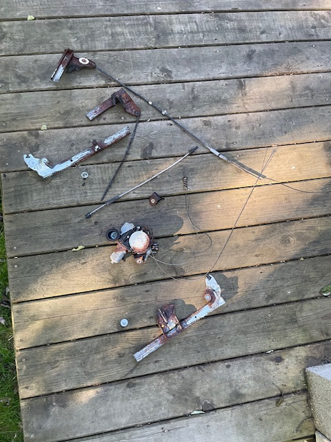

ok made some headway. the bolt that attaches the defrost mechanism came loose on its own, so at least that went right.
from there, i had an idea to cut the track so that i could roll down the window and it would slide out of the tracks. this worked pretty well.
i'm now trying to figure out how to remove the rear window but i don't know if the spoiler needs to come off. the window still has the regulator clips attached to it, but it should be narrow enough to clear. i figure if i'm able to remove the window without damaging it, should be smooth sailing from there.
anyway, cutting the rails took about 20 minutes with a mini hacksaw. will post some more pics later
regulator remnants:
i think i have it mostly done now, had to fight every minute of it though. the window wasn't too bad to get out, but i wouldn't come out with the part of the regulator still attached so i had to hacksaw it off.
when the window came out, all of the plastic clips were intact, but on the other hand they all had bolts stuck in them. so i used the candle method to melt the clips off. i ended up discovering that if they caught on fire they would just completely burn up and come right off the glass, which was exactly what i wanted. so just mark where the center is so you know where to put the new clips.
