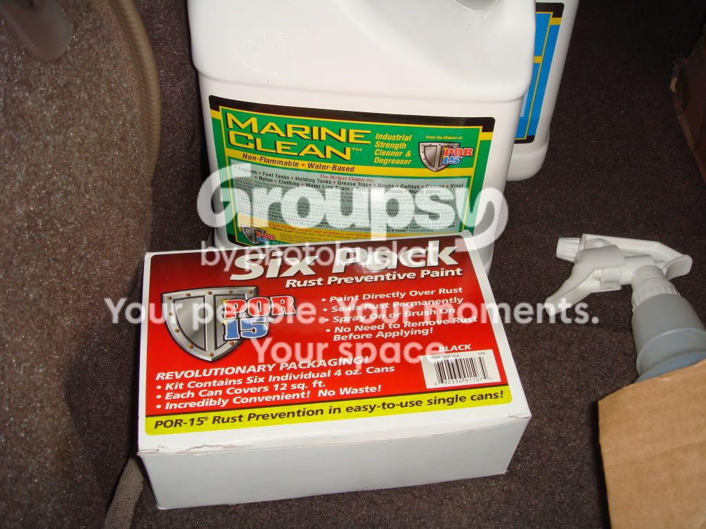

I have some Por15 paint that will be going to be going on my undercarriage this spring. Stuffs expensive ( seriously hold onto your wallet when you order) but it really stops rust if its not to late.
Heres my starter amount ready for use.

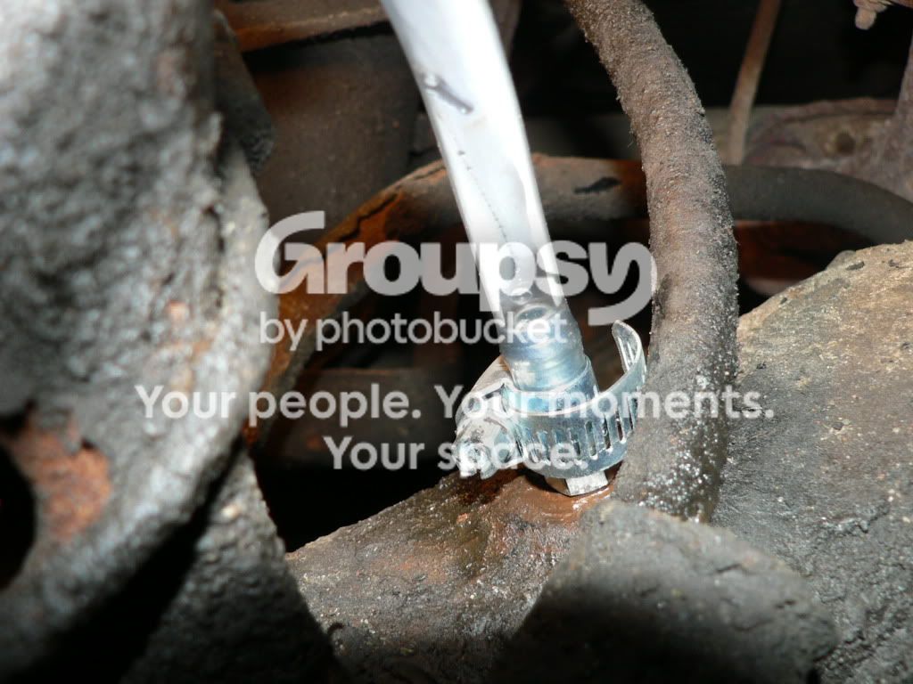

Oh yeah, checking the breather is a really good idea as well. In fact, just do the extended breather mod so it doesn't corrode in the future.

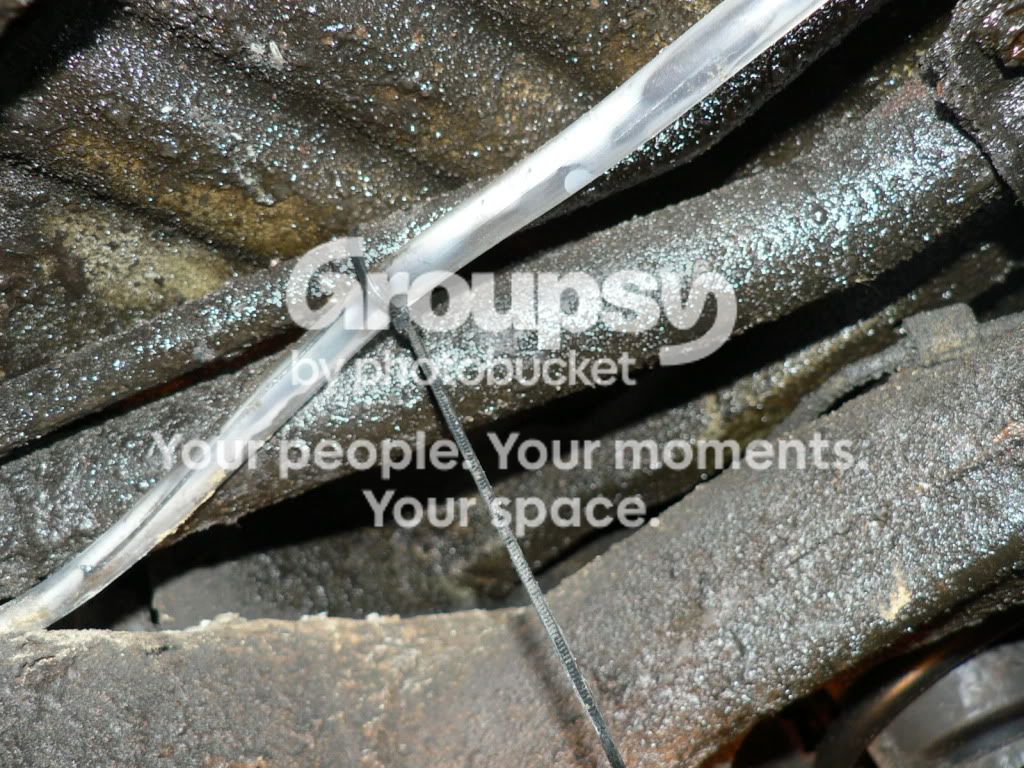

My recommendations:
- Clean up your diff. as other's have advised, and use the JB Weld to seal the pin hole.
- Spray your truck with the Gear oil. You can also do what I do, which is use recycled Motor oil from your oil changes (assuming you do your own oil changes). It's free, and all you need is a decent sized air compressor and a "undercoating" spray gun. (gun should run you about $30.00, and you have it forever)
That being said, spraying your undercarriage with oil is very messy, and not for everyone. You have to be willing to get your hands more than a little dirty when working on your truck......some guys (even mechanics) hate working on trucks this greasy....he he he!
P1110581.jpg~original
P1110573.jpg~original
The truck had some rust on it when I bought it used, but the rust has been kept at bey with this setup...I also use multipurpose grease on the insides of my bumpers, skidplates, and even used to coat my cable for the spare tire....
