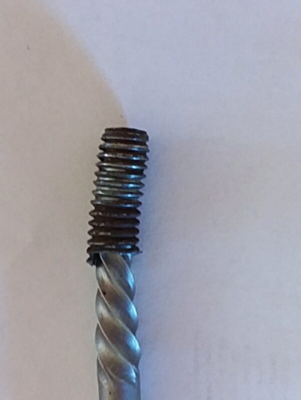

That was to deal with a rear shock bolt going upwards into the frame of a 2004 Jeep Wrangler, where the head snapped off and the sheer point was inside the frame. (Almost a perfect storm of worst-case). So, in addition to the penetrating oil this required some drilling upside down at an odd angle, plus a good quality 'EZ Out'.
At least I didn't have to resort to taking the body off of the frame to remove this bolt...
