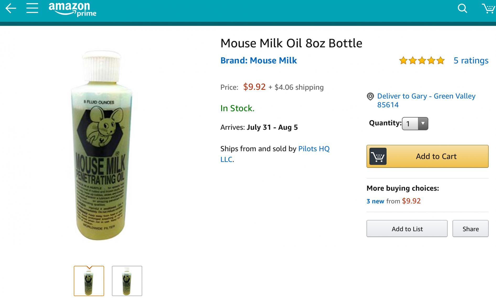

My rusty trusty 1977 FJ40 likes it when I use Mouse Milk.
