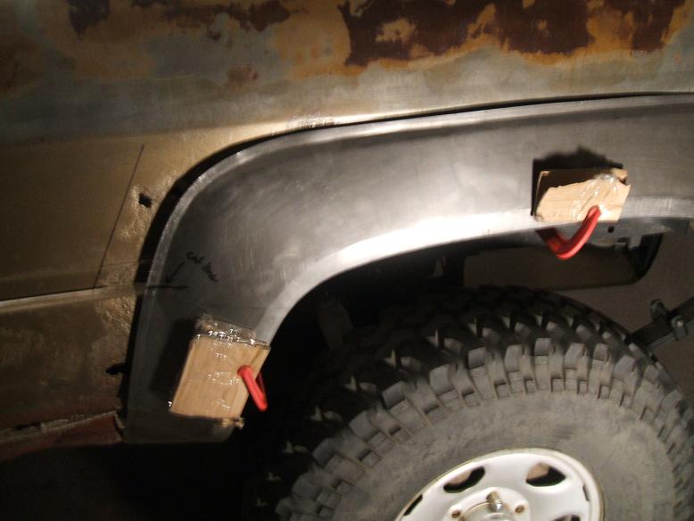

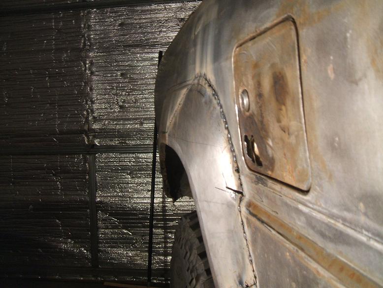

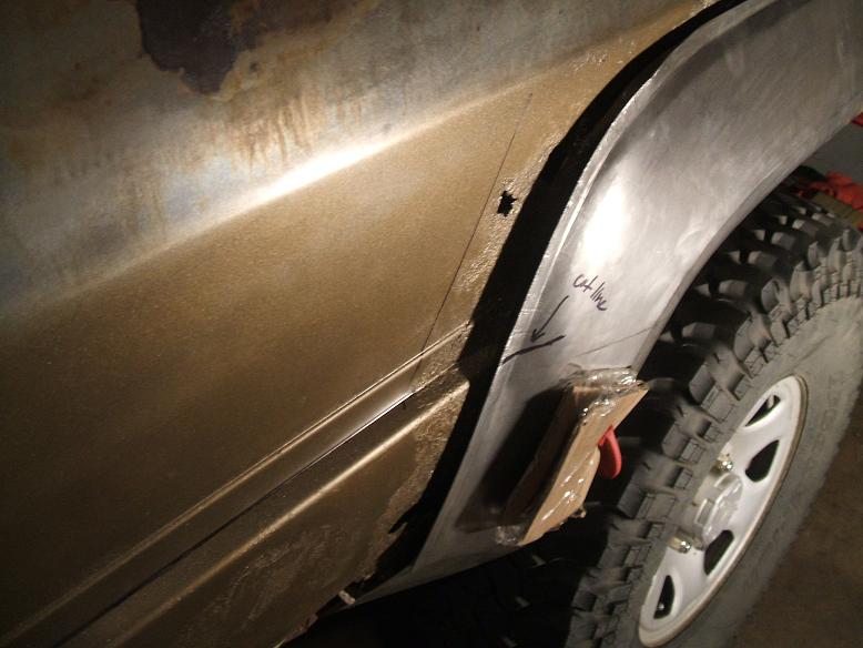

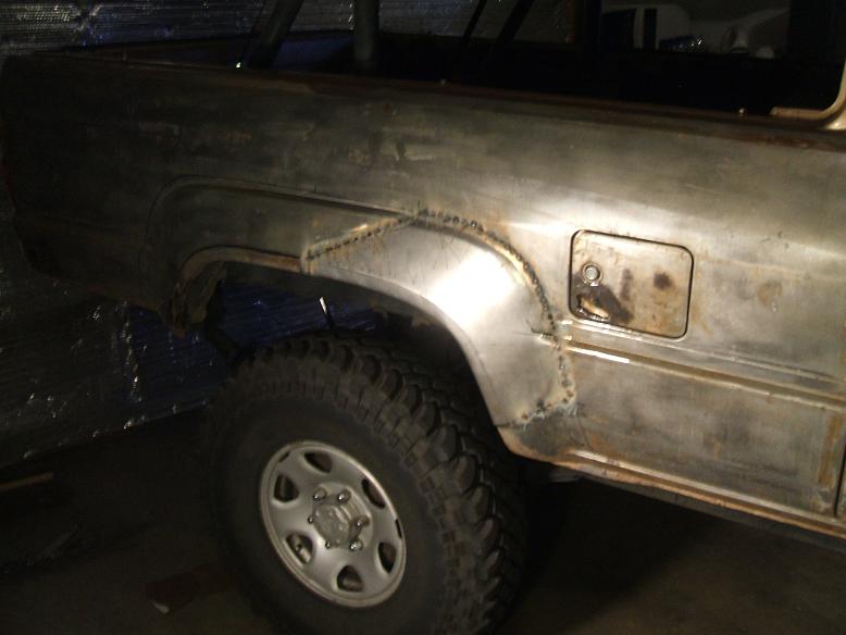

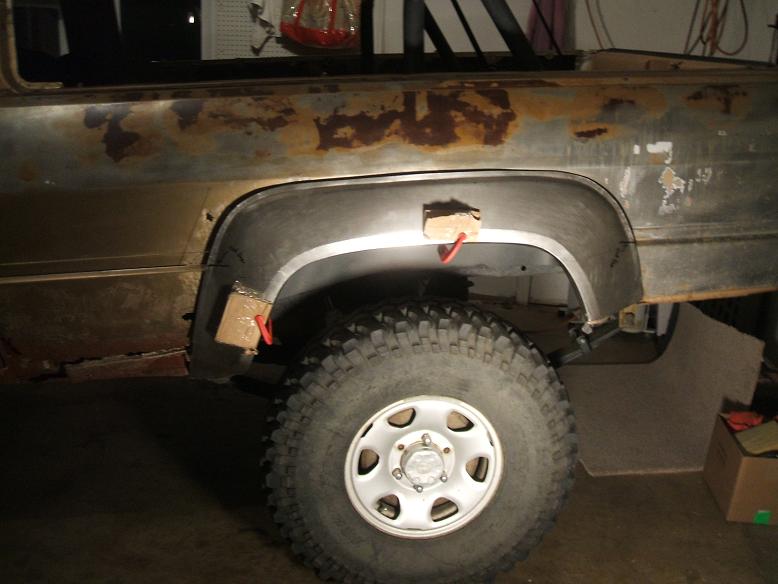

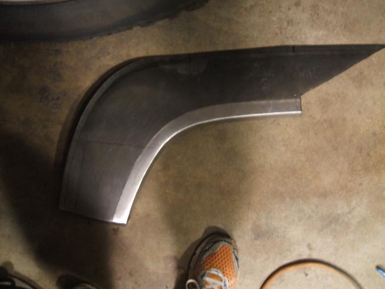

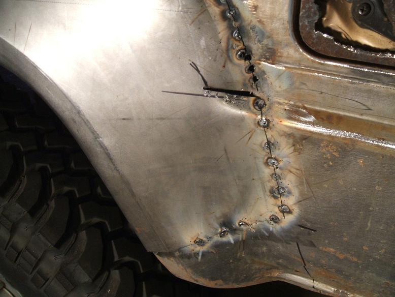

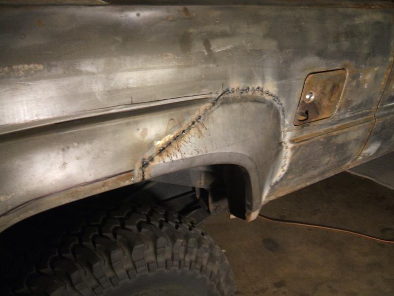

Anyway.....I completed the passenger side, it was the easier of the two sides and I wanted to get a feel for the panel and see how the welder was's going to treat the thin material. Power set all the way down and feed at it's slowest rate still was a little too hot so burn-through was a major concern.
The panels themselves are NOT designed to replace the entire quarter. These things are hand-made and as you would expect, they're a little rough and require some minor fabrication to work. If your panel is really rough, I would suggest either the glass panels or bucking up for new ones from Toyota. Yeah, I know those things will cost you $2000 for both but if you're hell bent on steel, go that route. Otherwise, the glass panels look cool but I don't have experience in fiberglass so it'll come down to your preference.
I attached a couple of pictures......The passenger side patch right after I welded it and also pictures of the driver side being mocked in place.......I'll post more once I get the driver side buttoned up. FYI - I spent 4 hours on the passenger side so far, and I'm guessing another 2 hours to grind, fill and glaze.
