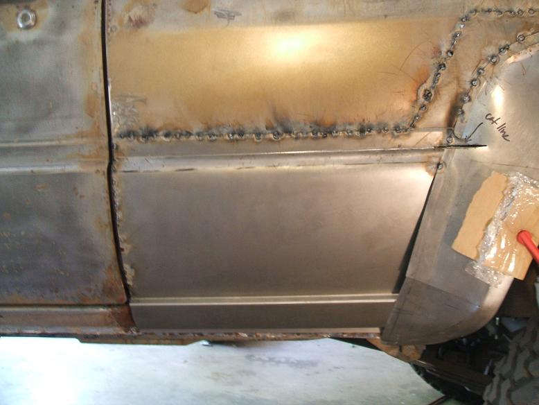

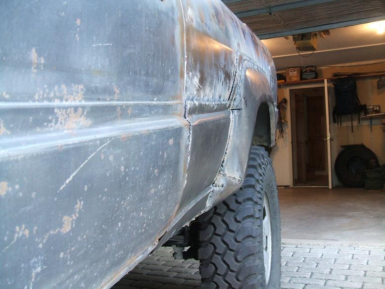

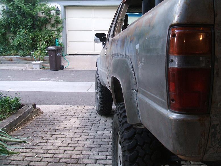

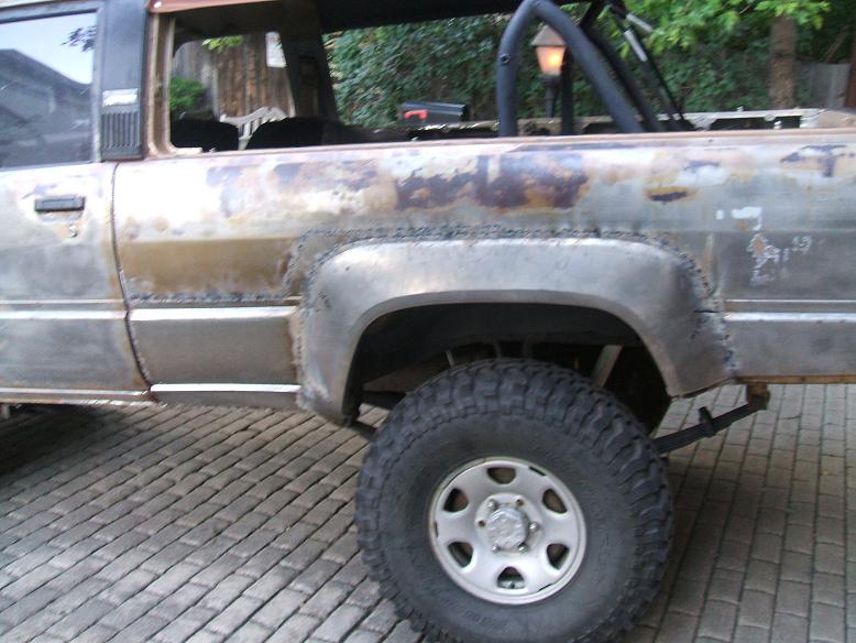

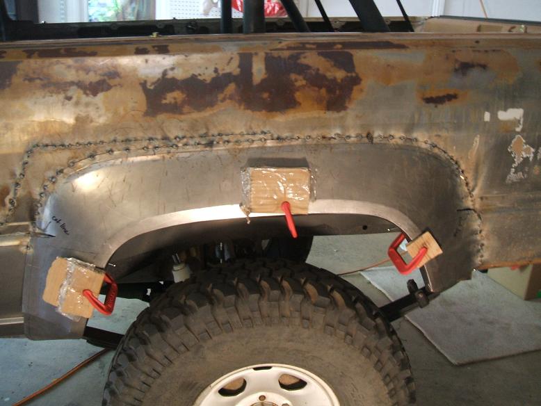

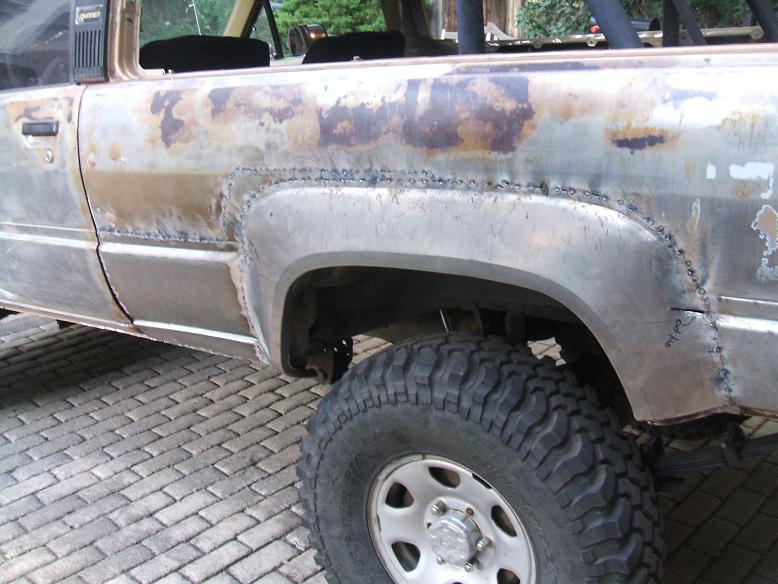

Well, the driver side panels are in and welded and the whole job including cutting out the rusted areas, fitting and cutting the replacement panels and welding only took me 5 hours total. I still have to take care of some minor adjustments and then it's time for filler. The panel just behind the driver door was a complete pain to install, the bends were not exactly where they should have been and I had to make some minor adjustments to make the panel fit. As it is right now, the bottom was not bent correctly and you can see that the lower transition isn't perfect. I should be able to hide the tight radius with some filler to make it look a little better but overall I am really pleased that the old girl has some new skins and that all the rust is history!!
Tomorrow is adjustment and filler day, I'll post some shots of the progress, I'm hoping to have the body completely done and ready for primer by Sunday.

I'm sorry .. but to me .. it looks like crap !!
There is seriously a LOT of work a head, to get the bodylines to match up ..
steel or fiberglass ? .. glad you like the steel !! kuz U gots lots of work to du !!

Are you kidding me? Thanks for the constructive criticism, how thoughtful of you! :wtf:
I'm freakin' speechless!
sorry brutha , but sometimes the truth hurts , anyways , who cares what I think , as long as your happy with it ..
your going to finish welding though first right ? before you do any plastic filler ? you have to "stich weld" all your seams , otherwise they'll just crack on ya down the road .. an you dont want that !

well my momma alway told me .. you get what you pay for !!! .. so NO .. I absolutly could NOT do it for what you have stated your costs as ..
as I mentioned .. My shop dropped this line of product a long time ago , and I do not recommend it , nor even suggest using them. I will never use this product again .. Most definatly , if anything , my customers want honesty ... and only honesty I will give them .. If I said this looks great .. I would be lying , this, I would be more woried about then my previous comments ..
not saying you cant correct it .. it's just going to be some work ..work I hope your willing to spend
