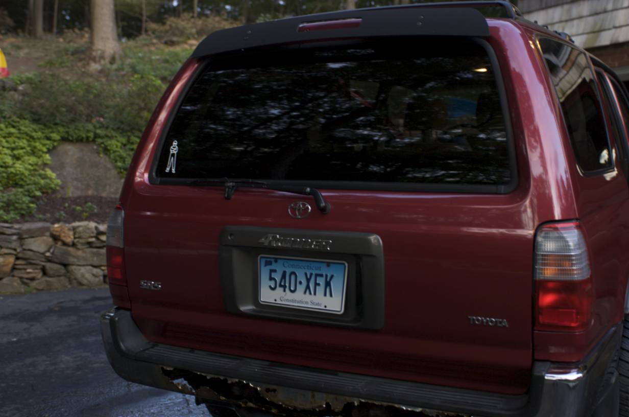

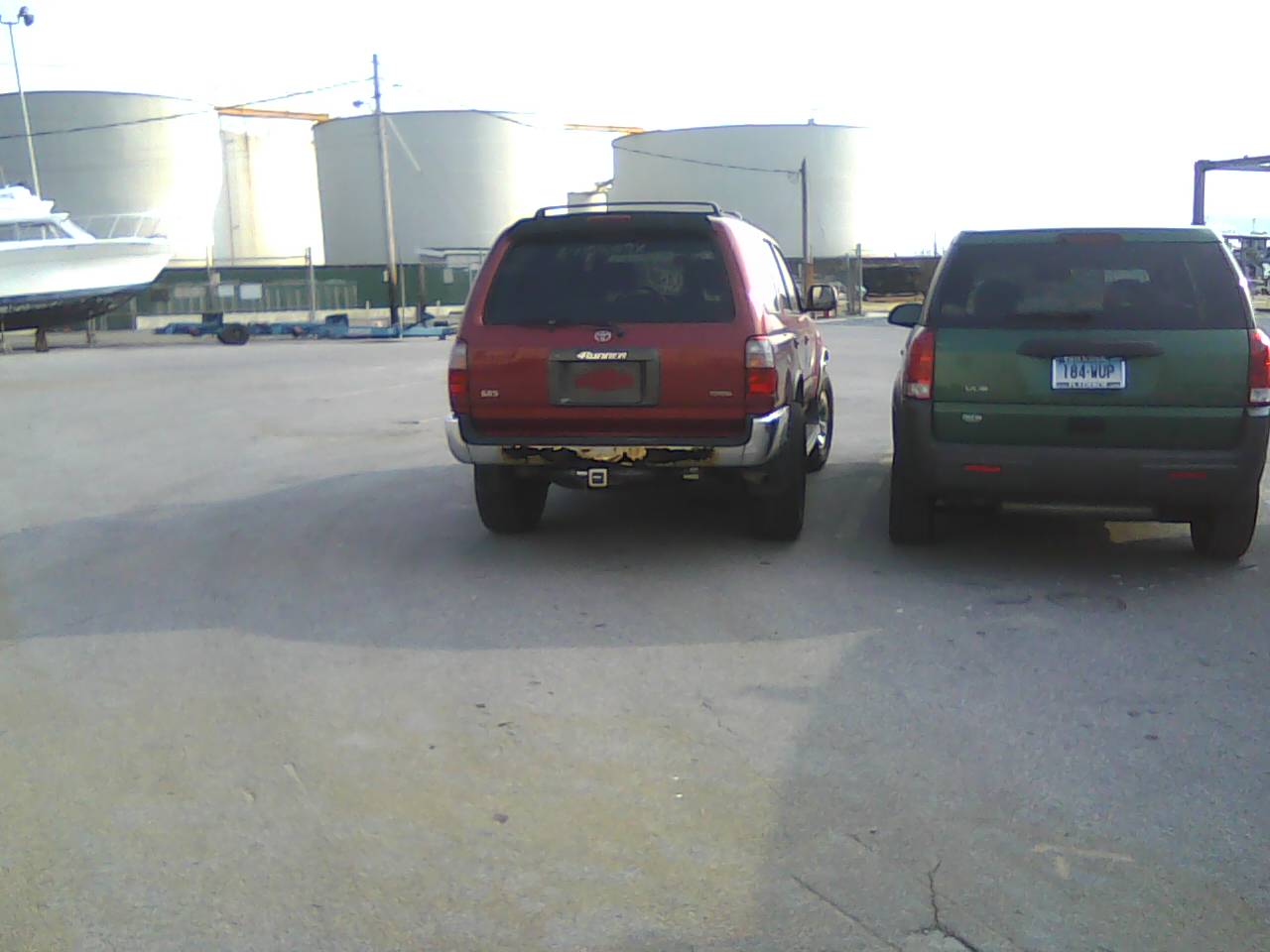

i kinda like mine, it adds character. Bet i got most of ya beat. In the next few weeks im replacing it though.
