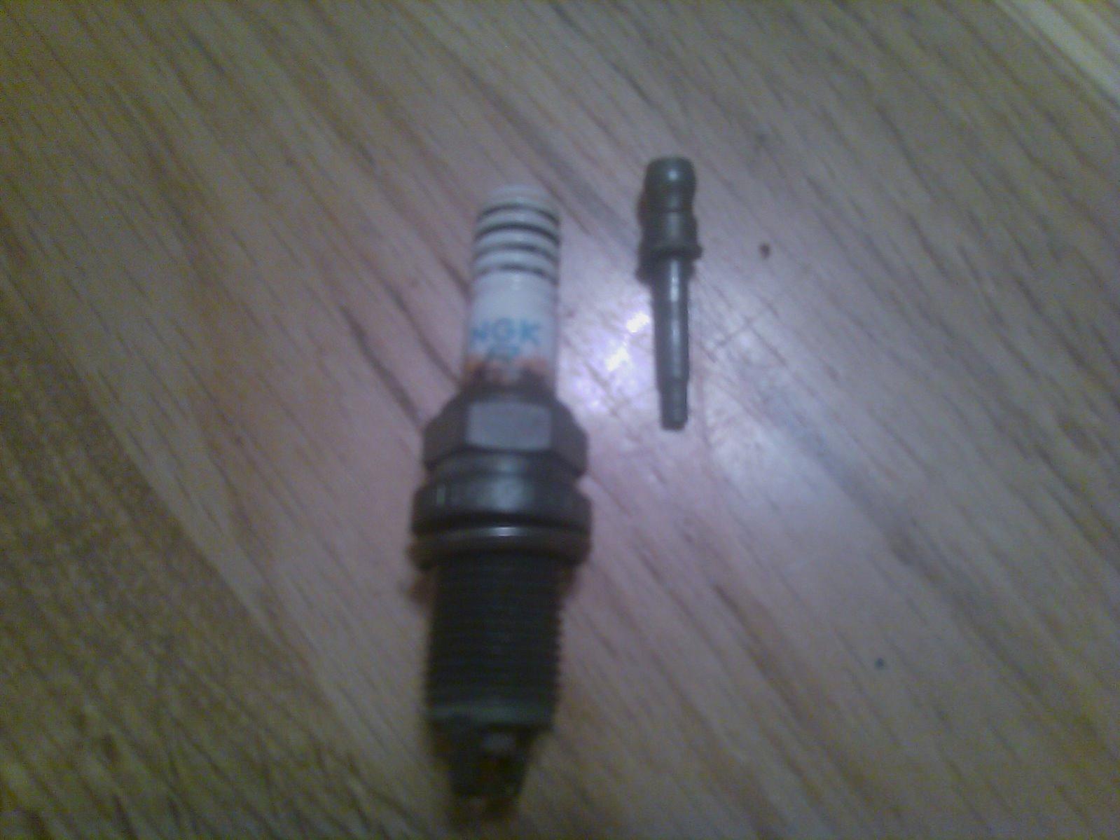

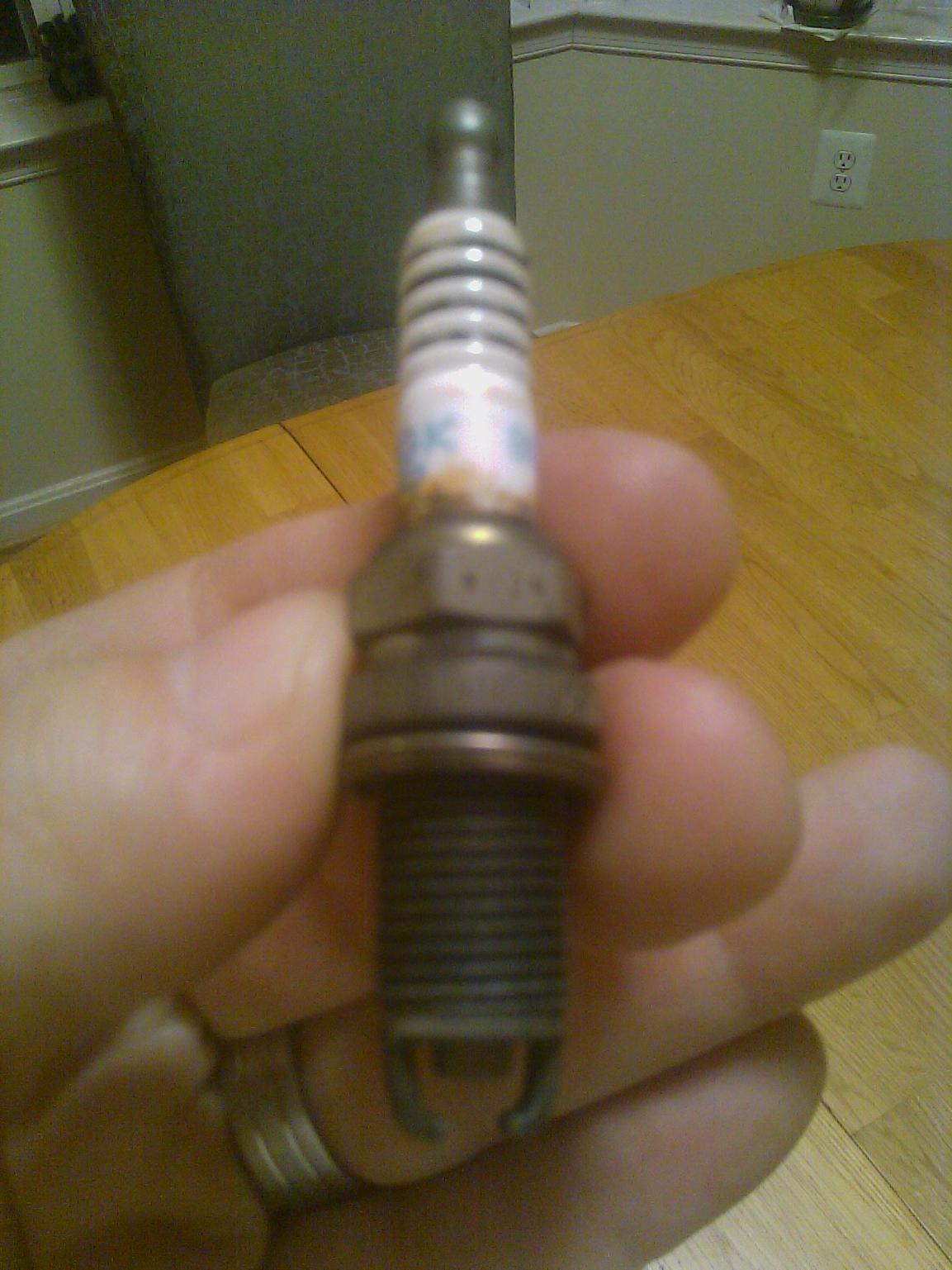

Pic #1- Clean Break
Pic #2, no electrode at the bottom..

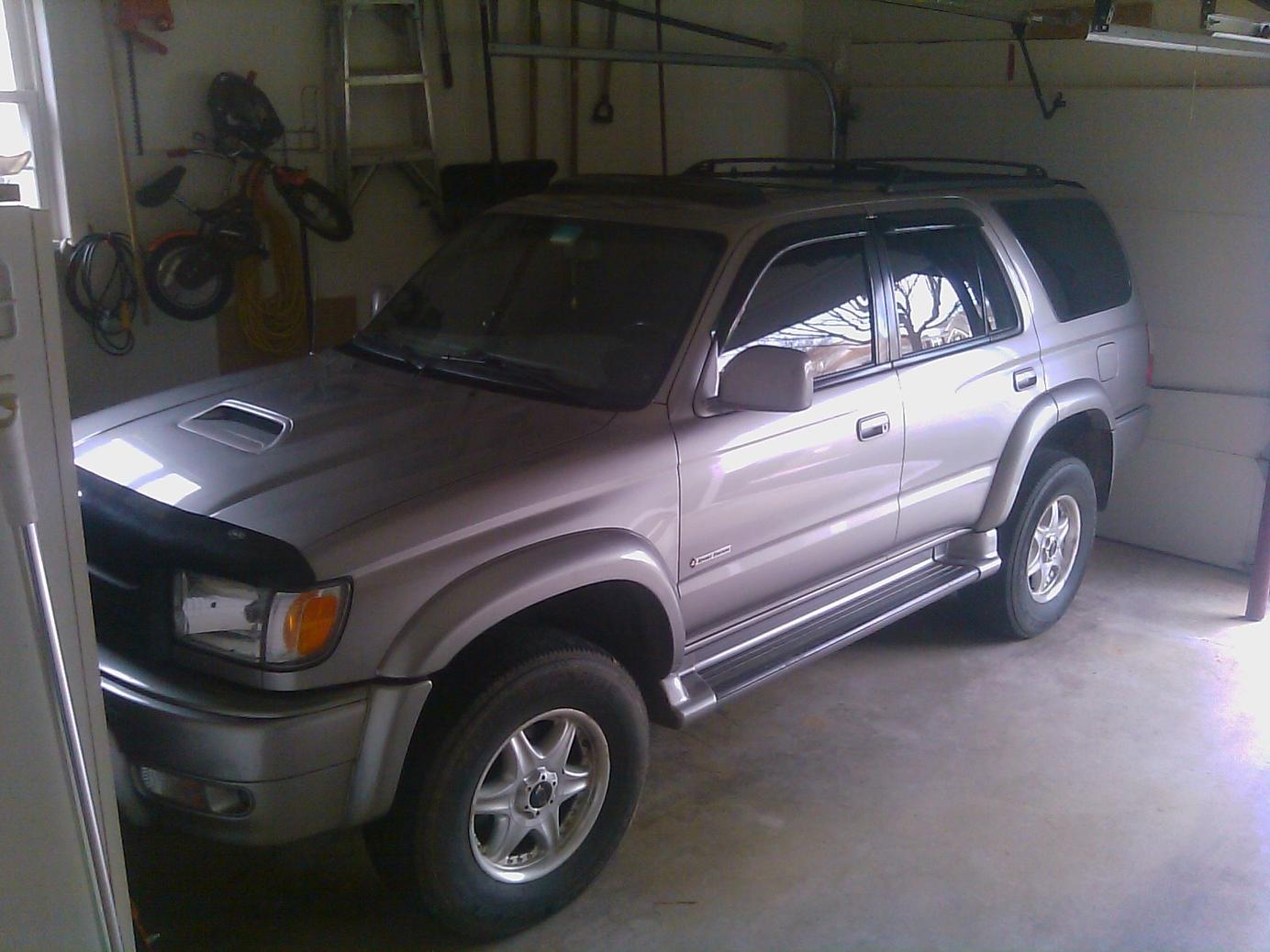

Pic #3 is as she sits.
