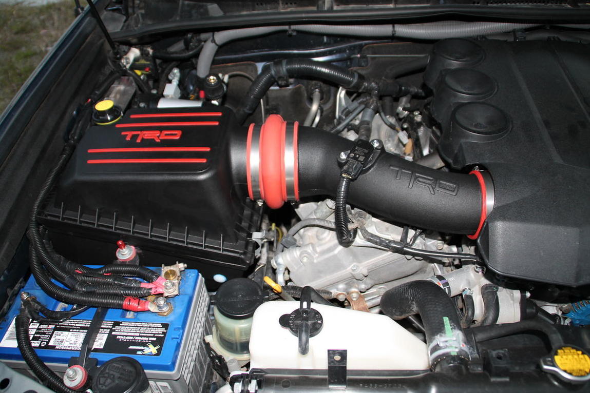

Has anyone done a Safari Snorkel install with a CAI instead of the factory box yet or do I get to be the guinea pig?
Yes works fine. It pulls so much air it vibrates the grate on the snorkel. Intake pic was taken pre snorkel, but you can see it in my sig pic.
did you have to get any extra parts or does it bolt right up?
No Sir. The TRD intake fits in the factory cut out through the inner fender well and the snorkel is designed with a rubber flange included that fits through that cut out. You remove the TRD or factory flange and use the Safari flange. Anyone on here have pics of the flange? I didnt take any. I do have a short video of how well a jigsaw works for the cut out.
