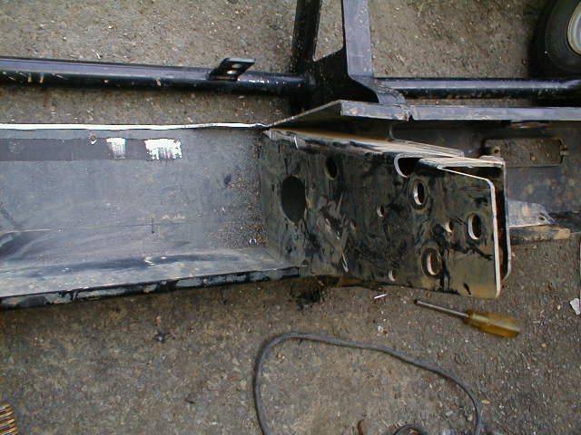

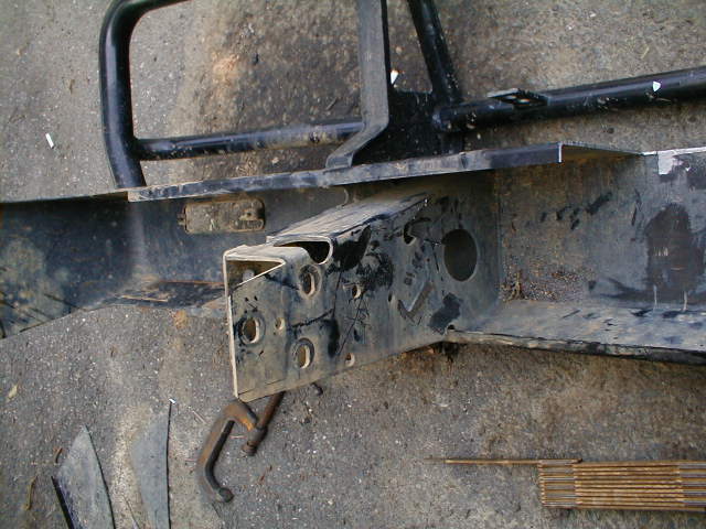

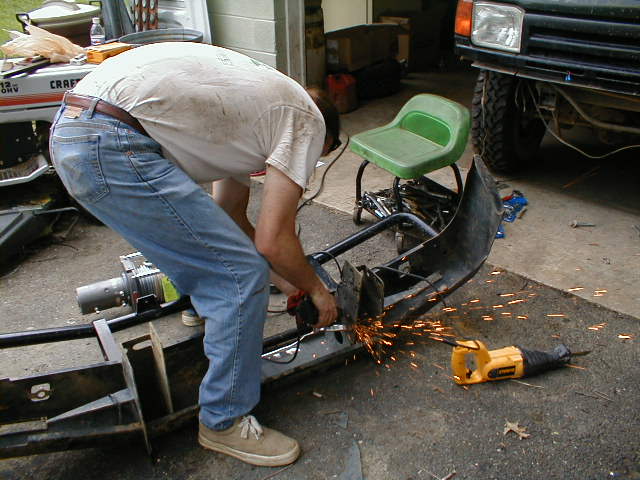

Here's what I got from actual experience, not something read elsewhere or from youtube. ARB makes non-air bag compatible and Air-bag compatible bumpers. I modified a non-air bag compatible one with some friends to mount my Warn M12000 on my old truck. The mounts are different, because I've installed a few I know the ARB air-bag compatible mounts have crumple zones. Pics attached of the non-air bag solid mounts. The other pic I've attached is one of the vehicles that I know had a front end collision and tore the front end off a honda civic. The air bags did not go off, it was a safari-gard bumper. The civic was totaled, and the front end damage caused the insurance company to total the rover too, where it was bought by another friend and repaired in Maryland.
The civic was t-boned cause he ran a red light and broke in half, the rover suffered hood, frame, and fender damage. The driver of the rover had back issues for quite some time.
frodiesel if you got any other questions just let me know, i got no idea why my opinion counts any less than yours. I don't work for ARB, I'm a network engineer so I only do this stuff for fun.
