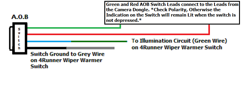

Installed Plug and Play Rear Camera Override Dongle
Thanking [MENTION=129513]bjohnston115[/MENTION] again for this mod!
http://www.toyota-4runner.org/5th-gen-t4rs/214681-plug-play-rear-camera-override-dongle.html

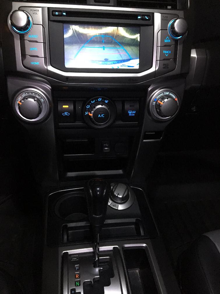

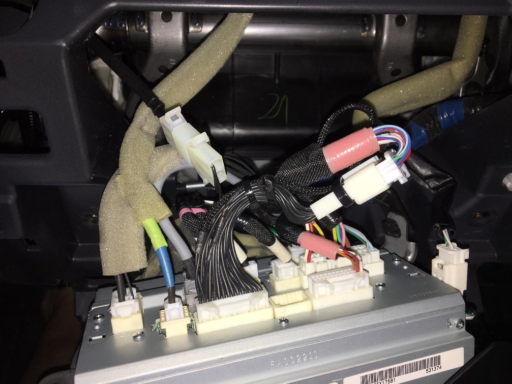

My install went off without any issues. Rear camera still works as normal.

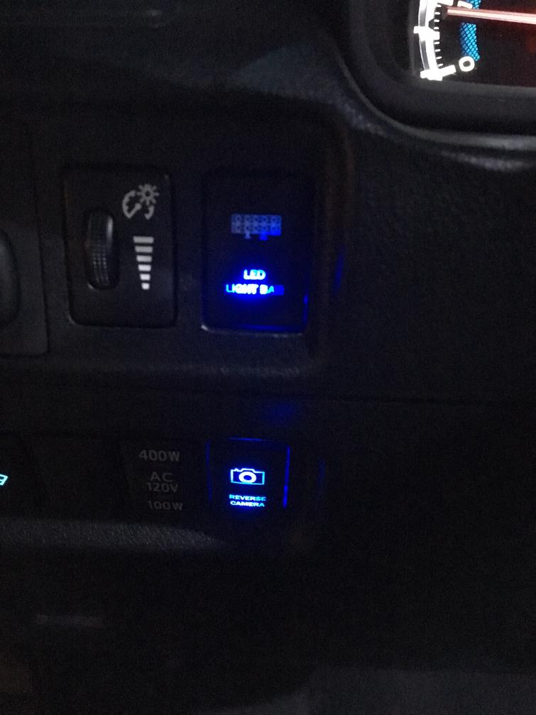

Depress the AOB Rear camera switch when in any gear, camera comes on.
AOB Switch dims properly just as the other switches do.
Wiring diagram
198554d1459663841-plug-play-rear-camera-override-dongle-camera-dongle-switch-diagram.png
Camera Override Dongle Installed
Indication of Override Working
AOB Switch Location and Functioning

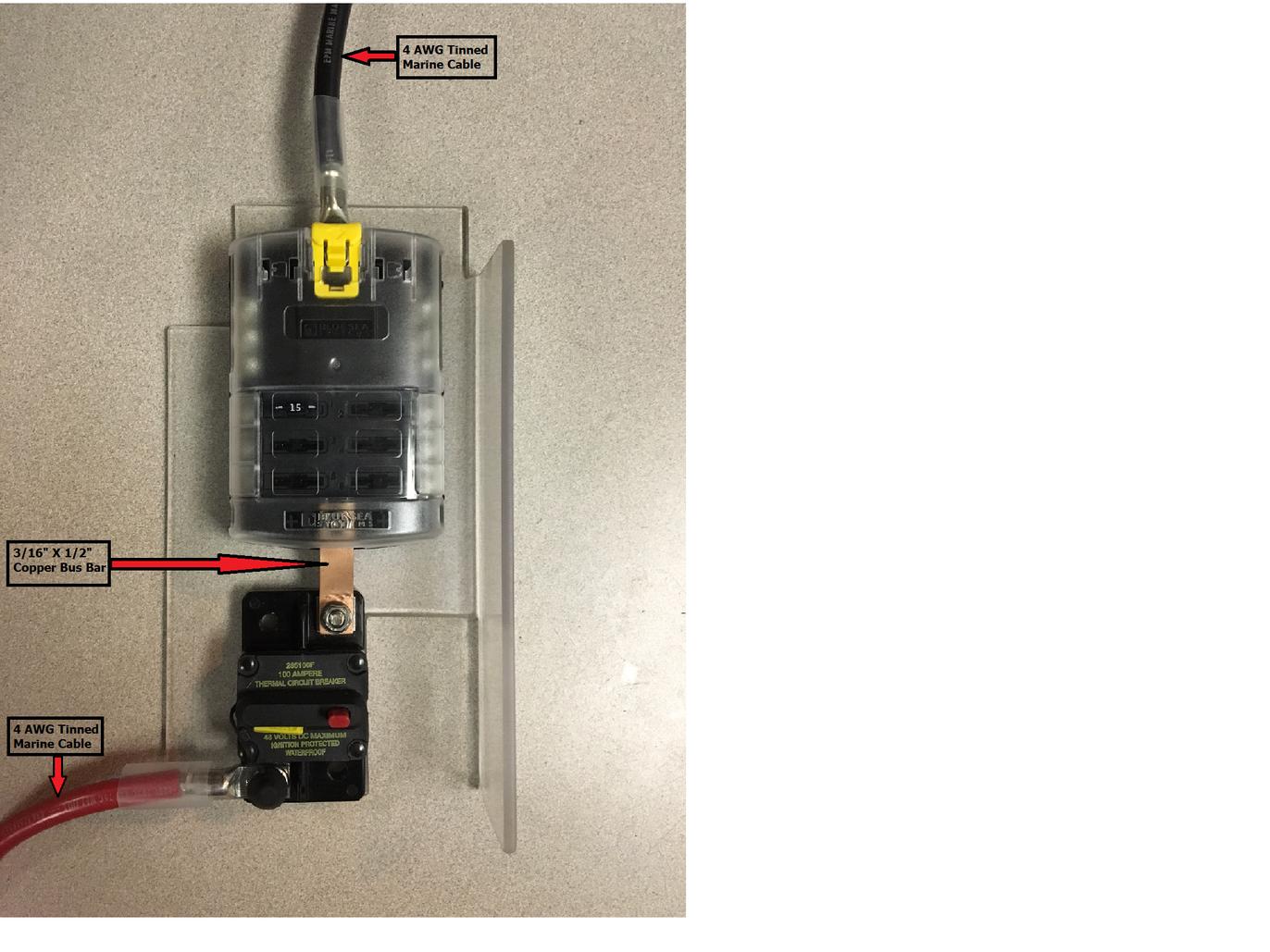

I decided I would try a project to have dedicated fused power all in one place via a Blue Sea 5025 6 Circuit w/ ground bus & Cooper Bussmann Resettable Circuit Breaker CB285-100, instead of individual leads running to the battery for power.

Started fabricating my support bracket out of a piece of 3/16” plexiglass for the Aux Electrical Circuit Mod

[MENTION=44305]weeeee[/MENTION],
The cutout in the upper right corner of the photo is for a pair of relays currently mounted on the inner fender.
The cutout in the lower left corner of the photo is for the brake booster harness to bypass the bracket.

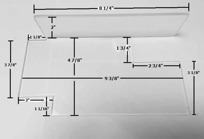

[MENTION=44305]weeeee[/MENTION] & [MENTION=115782]RedStripeRanger[/MENTION],
I don't have access to any more material like this, here are the measurements of the bracket.
Looks good. What did you use to make the clean cuts and how easy was it to bend the plexi?
Thanks [MENTION=90192]2chains[/MENTION]!
This was a piece of scrap golf cart upper windshield that had the 90° bend already.
Used a band saw to cut the bracket to my needed dimensions and a file to clean up the edges.
I like the fact that it's clear and non conductive.
I wish I had access to a lot more of this material for obvious reasons.

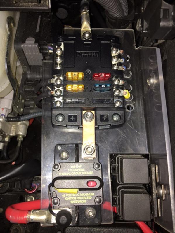

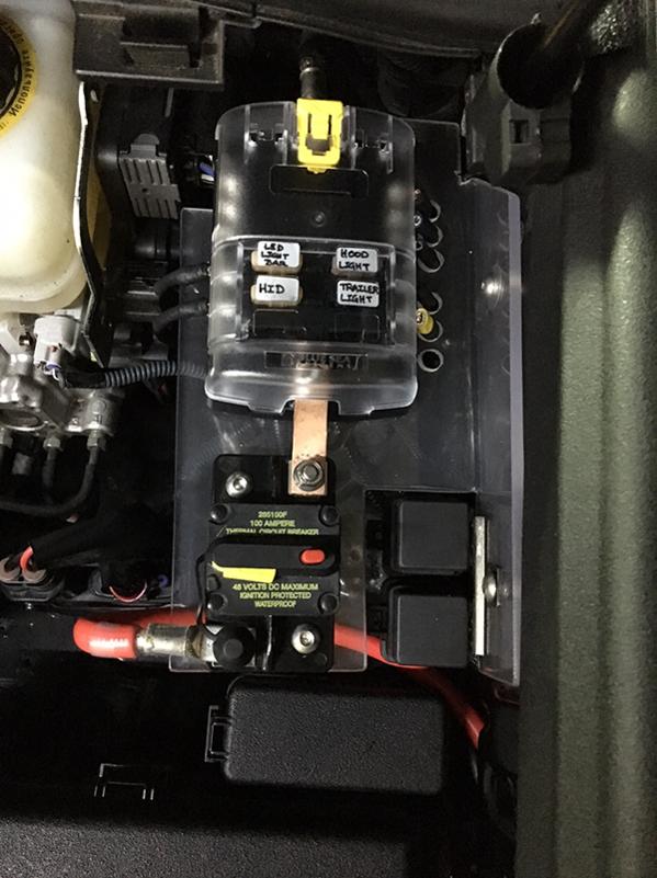

Here is the mock-up of my AUX CIRCUIT. The Pelican 1020 Box idea didn't work out as envisioned. Not quite enough space, so I scrapped that idea.
I think this will be fine as is, not as waterproof as a busman though....
Second photo is the AUX CIRCUIT Close-up installed.
Third photo is the AUX CIRCUIT completely finished and operating as designed
Looks really clean! I'll be watching this closely for ideas...
