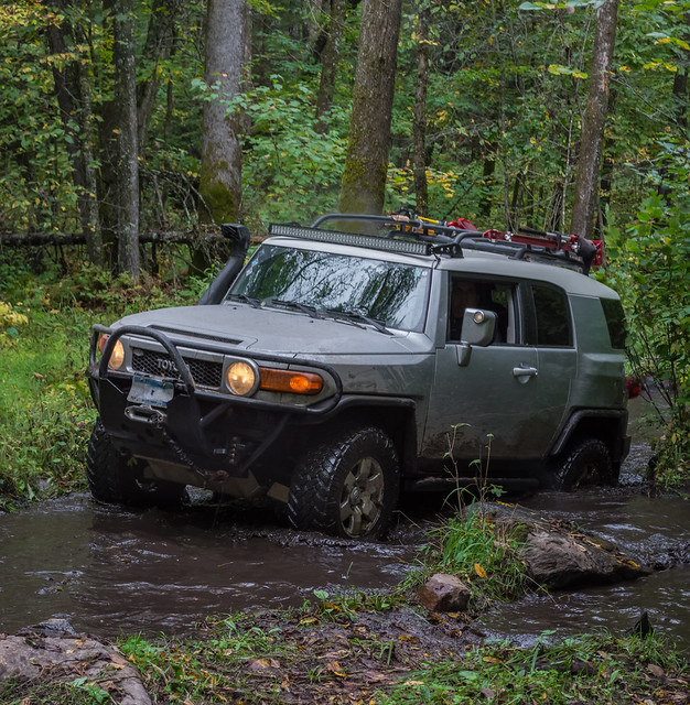

The 5th gen brake upgrade turned out great. After a week of DD use we went up north with Midwest Overland Society. It was a mucky experience. Torrential rains the day prior made for plenty of water and muddy hills to crawl up.
I got one shot of me.
Sparing you the Jeep participants a selection of the plentiful Toyotas at this year's event.

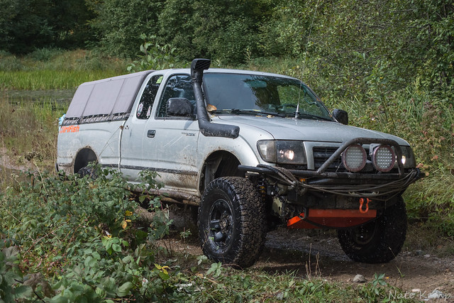

Snorkel!

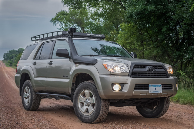

So this happened today. Much more work than it should have been, even for this novice fabricator. The first to the last cut were nerve wracking. I will post up a more detailed write up soon.
Snorkel install looks to be the flushest that I've seen so far. Is this the generic Amazon one that goes for around $60?
Nice work!
I want to do a little tweaking of the snout angles and smoothing of the crease at the mount but overall. Very happy with the install. At about 2k RPM I can hear it rumbling by the passenger window.
Time to update the signature line!

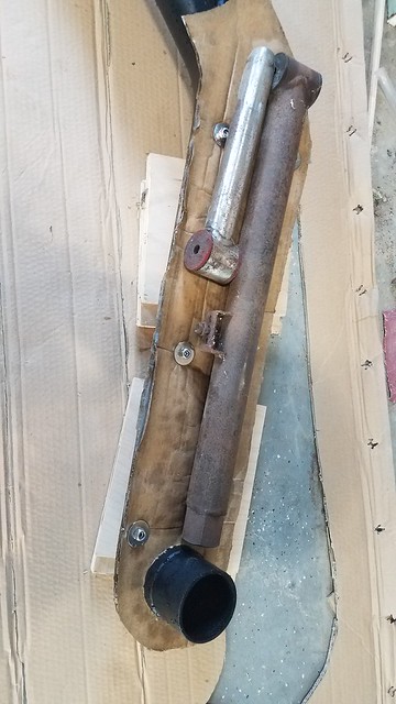

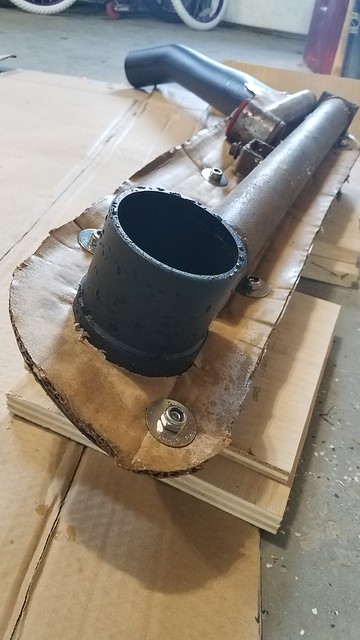

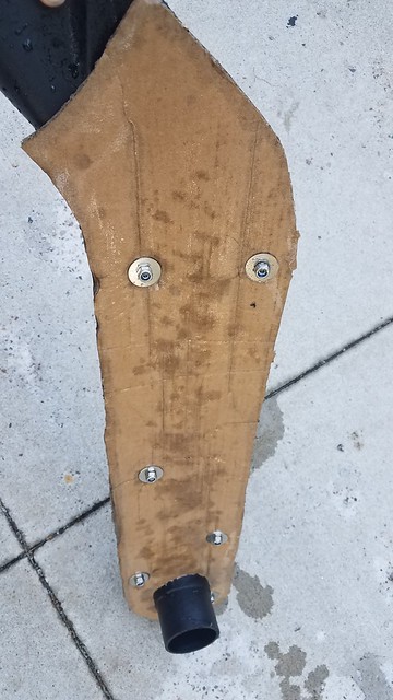

The backside of the snorkel is not flat and the screws are not all oriented parallel to each other, perpendicular to the body of the snorkel. The body of it is also not a perfect form fit to the 4Runner edge. What I did to try and address that was to cut a piece of cardboard to the shape of the snorkel body. I then used the supplied mounting bolts, washers and Nyloks (don't tighten them all the way on) to bolt the cardboard to the snorkel. I then wet the cardboard and weighted it to try and form it to the snorkel.
Clamped and weighted.
My hope was that this would give me a better orientation of the bolts holes to minimize the wallowing of the holes others have needed to accomplish to fit the bolts through the body panel.
Side view to show the curvature. I let it dry for a day until the cardboard would hold its shape.

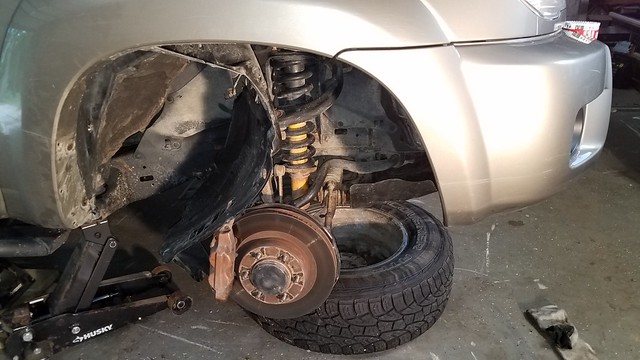

You will need to pull the wheel well liner to access the interior of the fender. I struggled getting this thing off so I pulled the front wheel off. There are 3 - 10mm bolts under the fog light, 3 along the end of the wheel well and then 5 on the mud flap. I was able to bend the liner back enough that I didn't need to pull the mud flap anyway.

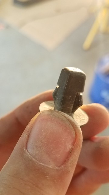

In addition there are a whole bunch of the square clips.
Some you can pinch from inside the engine bay.
Once you see how they are released a small flat head will assist it popping the others out. there are 3 I believe that are hidden under the lip of the fender in the arch of the wheel well. PITA to get them out. I only ended up breaking 2.

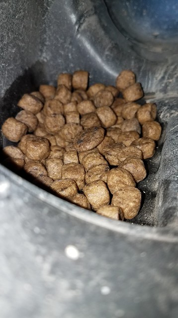

I the inside of air inlet I saw "pebbles." Closer inspection revealed it was dog kibble. Completely intake, clean, dog kibble. I have no idea.

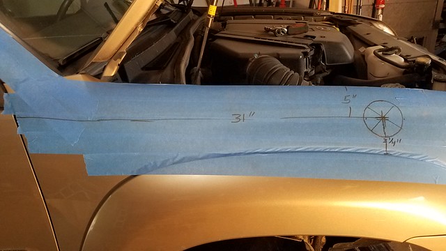

Cover the work area with painters tape. Headlight to top of the A-Pillar and hood to fender. I was repeatedly positioning measuring and moving the snorkel around trying to find the fit I liked. Scratches are likely, especially when the bolts are added to the snorkel.

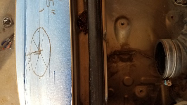

Using your templates and the snorkel itself position it for the best fit. Also make note of where the snorkel arm bracket will rest on the A-pillar. The rivets should not piece the inside wall of the pillar but I want to know for sure I wasn't going to set them off. Once I got a rough position I traced the location of the snorkel. I did not want to trim the fender flare and wanted to be sure the hood and door were not obstructed.
Here are rough measurements as to how mine was situated.
Step 8-20.
Position. Question yourself. Reposition. Question. Fret. Verify it is correct. Think more. Take a break. Verify.
Here is how my hole and the air tubing lined up.

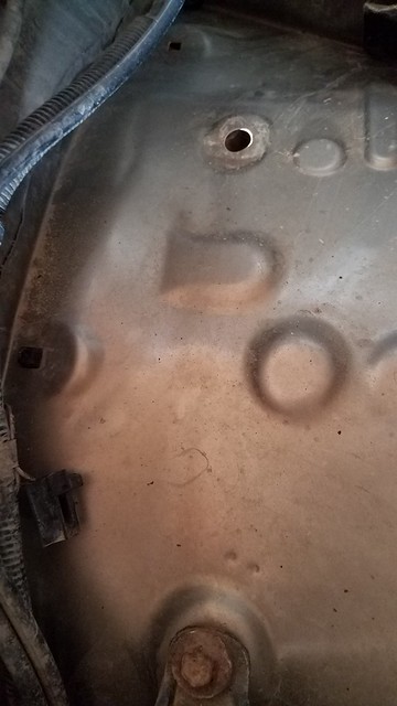

Locate the center of the large hole outline. Tap the center with a punch or nail to set a hole for the pilot bit. Note the angle that the air line will enter the body of the truck. Mine was at a downward angle. Using a 3 1/2" hole saw cut the main hole into the fender. Take it easy. You don't want the saw to jump and damage the body.
