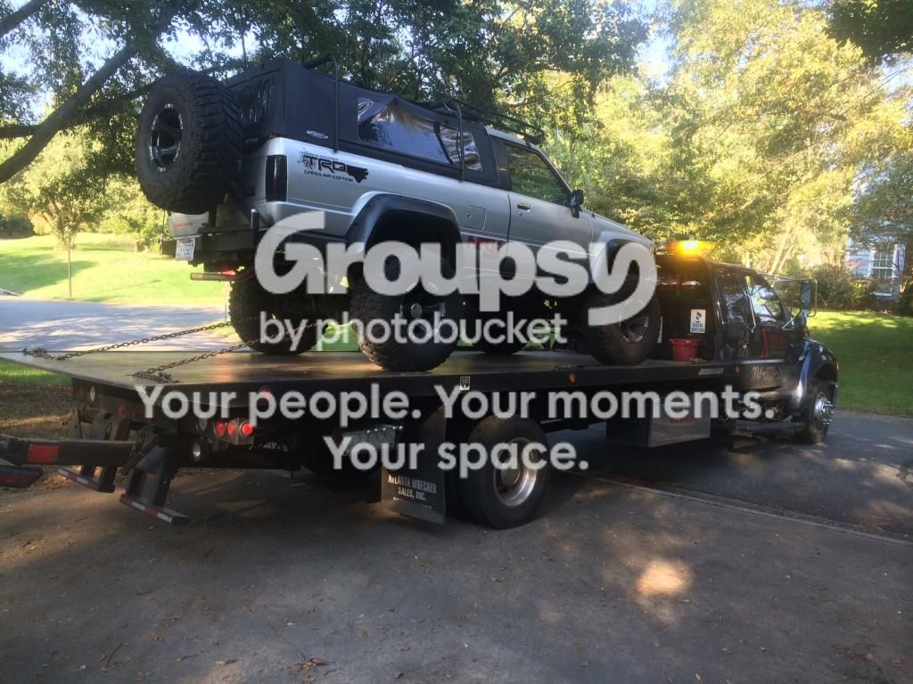

So today I've been having an absolute shit day. My GF broke up with me this morning and won't give me my mountain bike back, then when I went to get lunch in the 4runner today I ended up blowing the headgasket on the 3.slow. Normally I'd just drive it home with a bad head gasket, but it refused to stay running. What a surprise just my luck (guess I shouldnt be surprised with the 3.0). Ended up walking home a mile called a tow truck and got it dropped off at my house about an hour ago. So there I am sitting at home contemplating what to do with the giant paperweight in my driveway. Luckily I have my pickup I can drive in the meantime. Well instead of rebuilding the POS 3.0 and risk having it fail again later down the road, plus it lacks a ton of power, I decided I will be doing the 3.4 5vze swap. So this will be my new build thread for the 4runner. I will try to document every step here. I have already sourced a donor motor. Now its just a matter of pulling the trigger and ordering all the parts to make the sucker work.
Here is the 4runner getting the swap. Wish me luck guys.

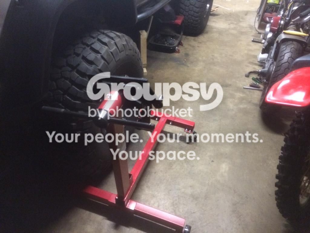

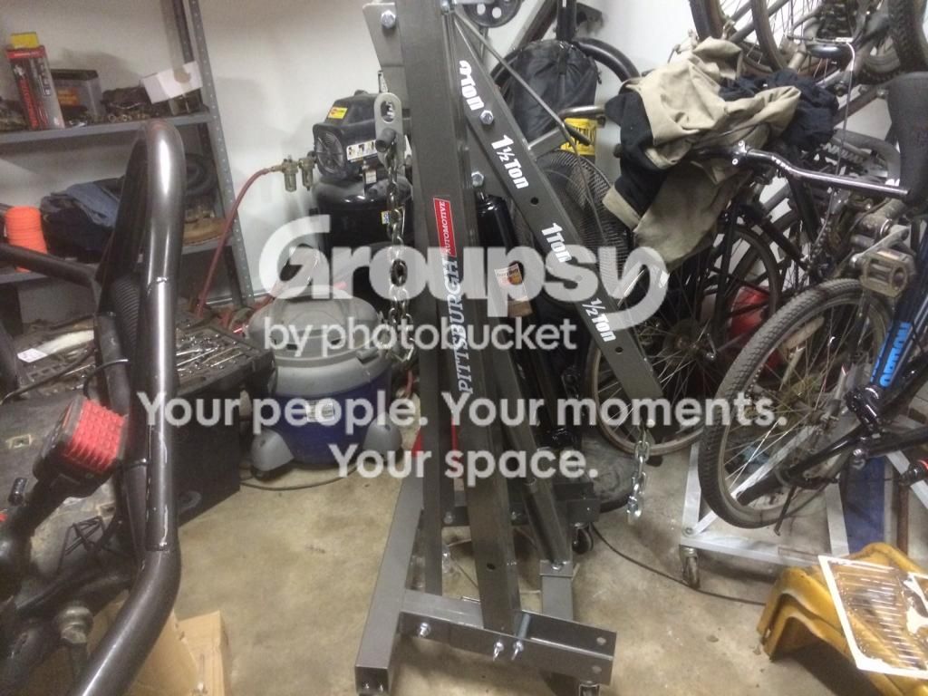

Also picked up a new bigger shop crane and a new engine stand to do the job right.
