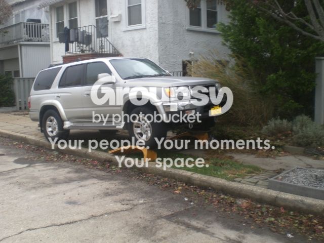

Well I thought I saved my 2000 4runner from the rising waters in Long Beach NY, only to find out I have a head gasket issue I didn't have before the storm. Best I can say is I was running a power inverter installed in the 4runner as a generator to power the refrigerator and some lights for a few hours at a time (2-4 hours idling) this alone shouldn't have blown a head gasket but maybe it was week to start.
I didn’t have full coverage insurance and because the wife’s Camry survived FEMA is no help so I must repair the 4runner myself, as I’m not employed I have sometime on my hands.
History:
Picked up the 4runner in July with 127,000 miles and now she has 130,000 so I want to keep the truck, she helped my family out during the first 3 days of the storm / black out and I now have a soft spot for her. I will not junk her, its not economical to replace the 4runner, and I will bring the engine back to life. Money is an issue so no remanufactured motors or junk yard specials, this engine should be good shape it was a one owner car with a stack of service records.
I’m looking to replace the head gasket & pick up a timing belt kit from aircabinman on eBay for 355.00 shipped
Diagnoses:
Idling in front of my house powering lights etc, I checked the 4runner and saw the temp needle was ¾ up moving towards HOT. Never happened before, I shut her down, checked the radiator fluid, none in reserve tank, low in the radiator so I filled both and saw some brown milk shake. Oil was lighter brown/black = oil and anti frezz mixing. I had no choice I had to drive her about an additional 35miles highway but I didn’t push her above 2500 rpm and added more oil. Now she sits in front of my house, starts like a charm every time
Now for a little Help: I found the Toyota overhaul gasket set from Toyota but can not find any information on the parts included or parts numbers. Anyone have this info or parts list for a Head gasket repair? I would like OE head gaskets and valve stem seals etc.

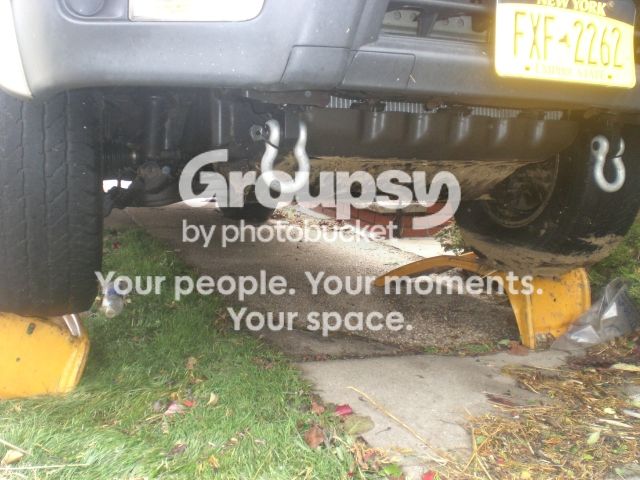

Rather than going on about possible reasons as to why it overheated, I would just like to suggest to the original poster that he not get under his 4Runner, with one of the ramps sinking into the grass.
If you insist on using those ramps, at least use them on solid ground such as concrete or asphalt.
Otherwise this might turn from being an inconvenience, into a tragedy.
Good luck.
Good luck.
I agree, she overheated for whatever reason/s. I drove up those ramps in complete darkness with a buddy holding a small flash light in thigh deep rising water, the pics are from the next day and I was amazed it didn't fall when I saw it. Everyone on my block that left their cars / SUVs in the street have non working, flooded vehicles, Yet my 4runner has a beating heart with a little leak :trophy:
