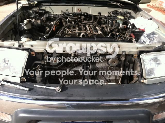

Weather has warmed enough that I've been tackling the engine break down over the last few weeks.

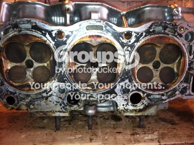

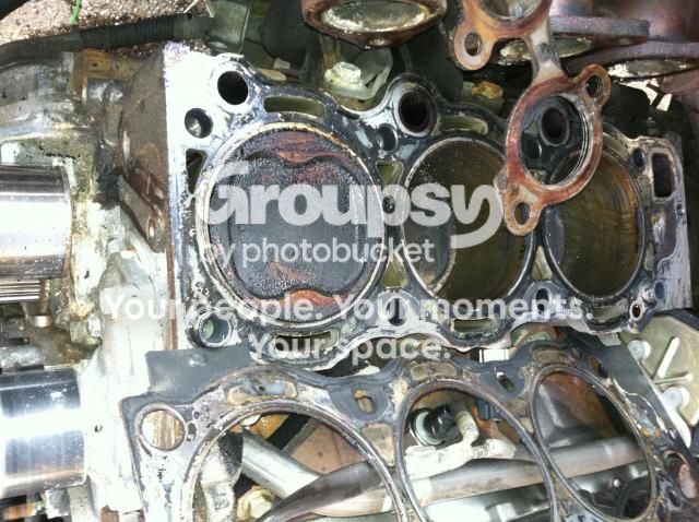

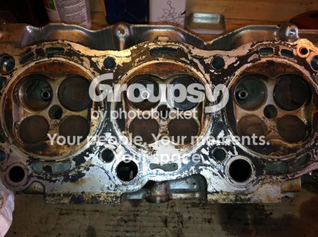

Number 1 cylinder looked to leak out anti-freeze but could have been fluid still in the head passages after drainage. Of all the piston tops the #1 and #3 cylinders was much softer and scratch able then the other pistons with baked on carbon deposits.
Passenger side bank

The gaskets are metal type and I didn't see any brakes like in cork / composite type HG sets.:ybrick:

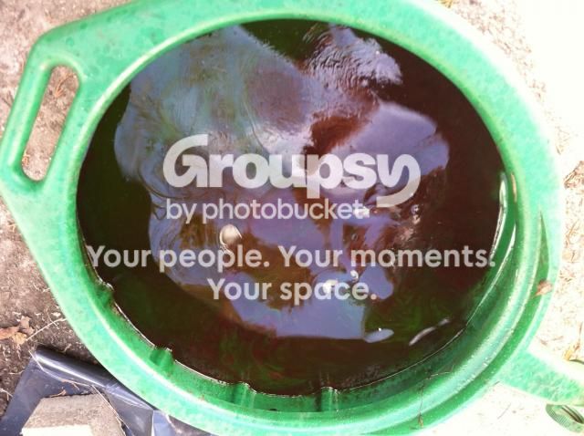

I'm thinking warped head and fluid getting under the gasket. I found antifreeze in the oil and oil in the antifreeze, before taking apart the heads. So something is wrong.

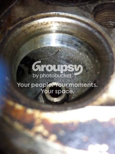

Now for the fun, upon inspecting the heads I did not see any clear cracks in the combustion area. When looking down the intake & exhaust runners nothing really but casting marks then I remove some intake valves I'm seeing what looks like a hair line crack in the #1 & 3 cylinder, could this be the cause? not much but how would oil get into the antifreeze on a intake runner?
Passenger side head
IMG_0457-2_zpsbb15ad5d.jpg~original
Driver side head
IMG_0456_zps84dbeeb0.jpg~original
Looks like a hairline crack, #1 cylinder, interesting part is both hairline cracks are where the casting marks are in the other intake passages but they clearly have some material / founding marks.
02e6ccea-96c0-42db-b03a-63ffc36f3d05_zps453a5fc2.jpg~original
#3 intake valves
IMG_0492_zpsbcd6a7ad.jpg~original
Any ideas, should I take it to get dye tested?
