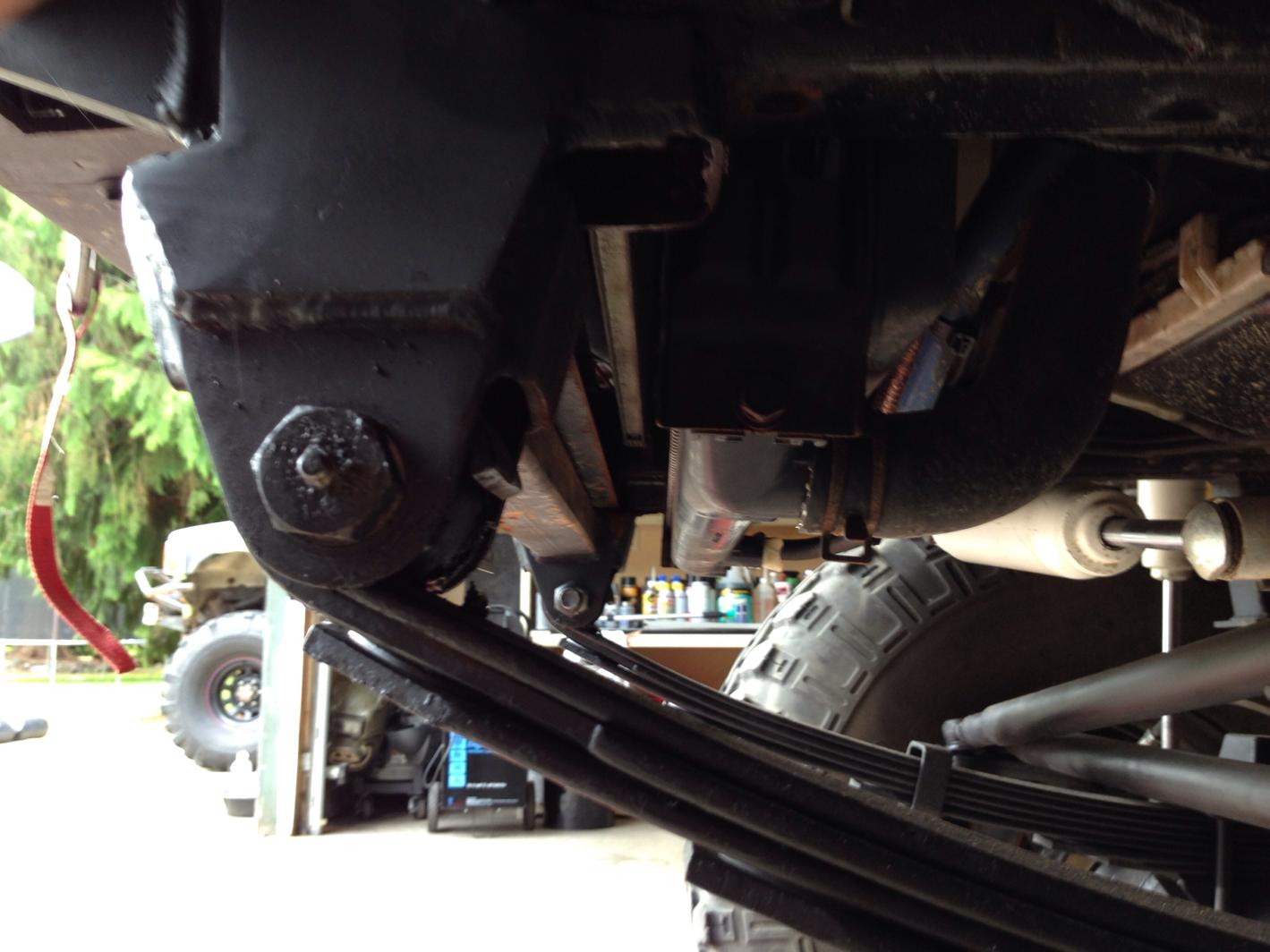

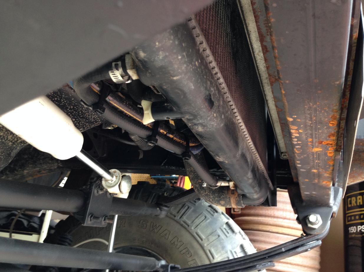

Here's my radiator in the stock location. I actually didn't have to do any modifications to the fan shroud either. There were two part numbers for recommended radiators to use that are 1inch shorter. One of which I believe is the 2rz that downpour mentioned above IIRC. Napa #APD2740 and Performance Radiator #1774. I personally didn't think that the extra inch hanging down was gonna be an issue so I left it alone for now. Napa wanted $144 and PR wanted $106 for theirs at the time. Hope this helps.

I forgot he is doing leafs lol, you guys have that crossmember. I was reading "i don't think the extra inch will be an issue" and I was like... well I popped mine on a rock, but I don't have that crossmember there.
But yeah, I paid like $120-130 for mine from vatozone, because that was the only place open New Years Day. No issues though and no overheating.
You know I'm still thinking about adding some kind of armor to protect my radiator from that. Some kind of plate built off of the hanger running underneath it. I've hit my front hanger a bunch of times on my '88 so I know it wouldn't hurt.
Hmmmm...that 1in. shorter radiator is starting sound like a good idea. Way to go Rob! Now I'm gonna end up spending money again:D
hahaha hey that's the rule with this stuff, there's always something...
I know thardy built a radiator guard. I know you can fab well, just bend some sheet and bolt it on to protect the radiator.
