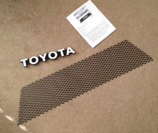

I am selling my BRAND NEW complete Satoshi Grill Kit that has not been installed. (I decided to go a different route...)
I am including the customcargrills.com perfGT grill and the T-O-Y-O-T-A emblem with instructions for exactly what I paid... $90 shipped for the kit.
The grill is found here:
customcargrills.com - 10-11 Toyota 4Runner - DIY Mesh Grill Kit
And the T-O-Y-O-T-A logo was ordered through the Toyota dealer, its the 14" Landcruiser logo that everyone is using.
PM me if you want it for exactly what I paid, $90, I will pay shipping to you...
