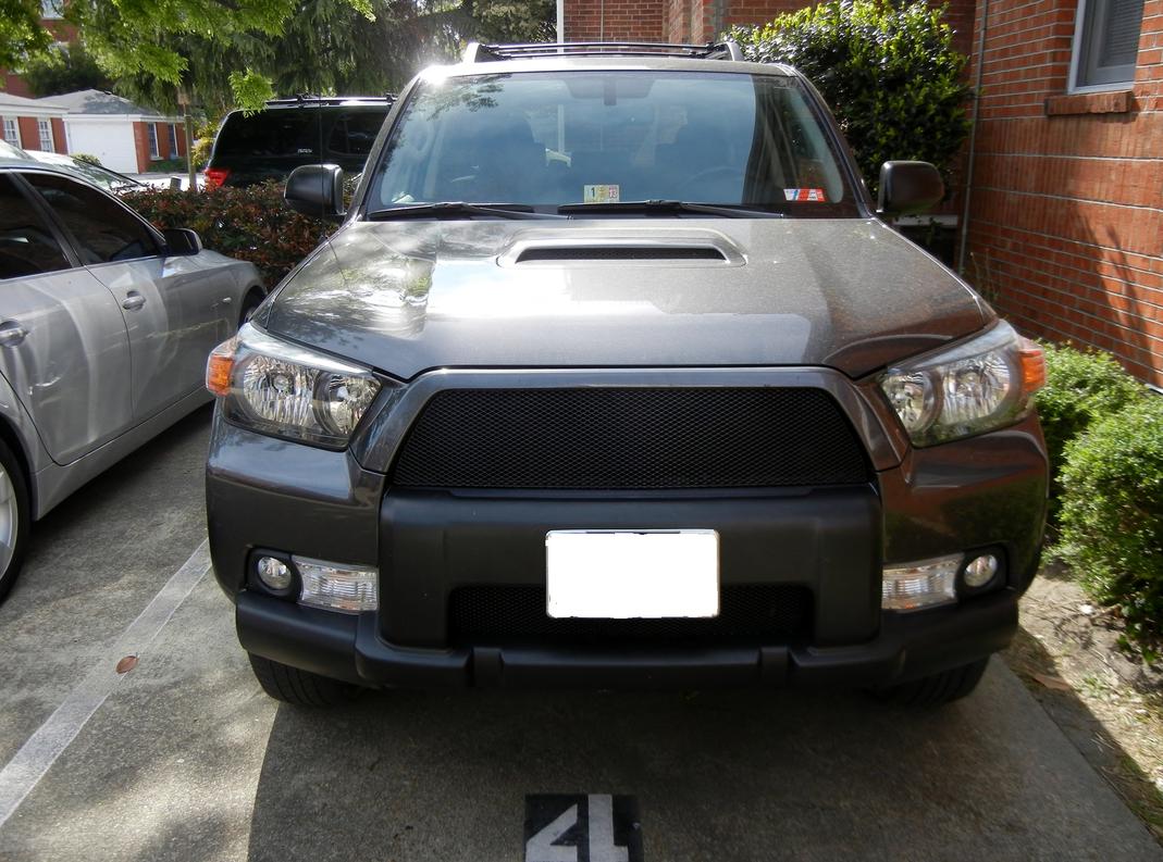

Finally did the change to the grill. Big question though.... Has anyone painted the TOYOTA emblem a different color? I have it and am waiting to put it on. I figure white will be fine, but contemplating changing the color to be different.
I believe Ducmonsta has a red one... If I got the person wrong; at least someone has a red one because I've seen it on here.
