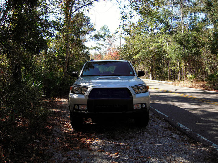

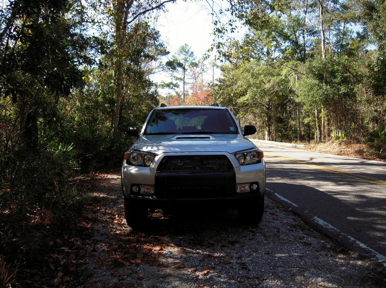

Playing around, wondering how the Satoshi would look on a Silver TE. Unfortunately the front end is very dark in the original picture (only one I got), hard to tell how this would look. I don't think it screams 'AWESOME' like on the Magnetic Greys though :biggrin2:

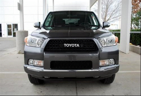

Another photochop
Think it'll look pretty good with the white lettered "Toyota" emblem...

This is the one I got. I painted the white letters mag grey though to match the truck. It was just a little too aggressive for me being white :)
