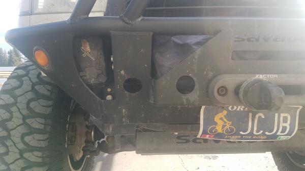

Here's a picture of where I located the winch solenoid behind the front aftermarket bumper (4xInnovations). I've got it wrapped up in electrical tape for "weatherproofing" and am planning on welding up some sort of enclosure. There's plenty of room here for it:
