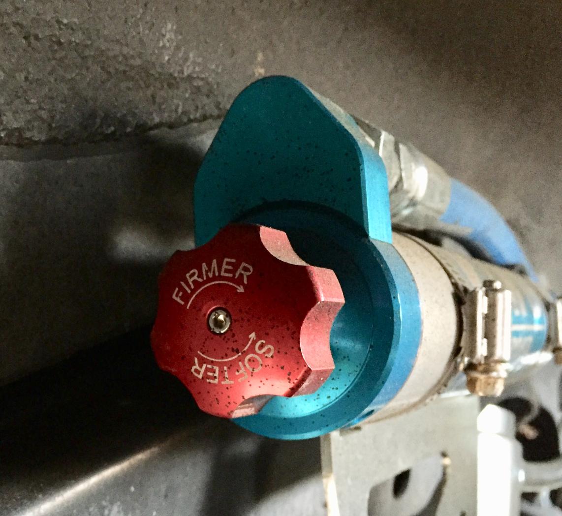

Most higher end shocks come with an option for valve adjustment on the compression side of the shock travel. MOST of these adjustments are done by turning dials with specific detents. On King shocks for example, 0 “clicks” is the softest setting, while 22 or 23 (can’t remember off hand how high it goes) is the stiffest setting.
So he’s running 2 clicks above softest on the front shocks, and 3 clicks above softest on the rear.
I run 4 and 4 on the street currently. Still playing around with it.
Some shocks, like Fox, have an adjustment for low speed fine tuning and a larger one for high speed.
Some shocks have an adjustment for compression AND rebound, like the OME BP51 series.
Pic for clarity
