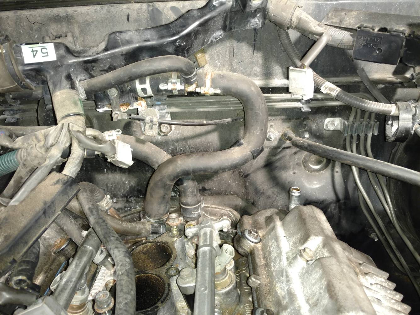

Anyone know a part number for this coolant hose? The large one in the center.
The inner lining is failing.
