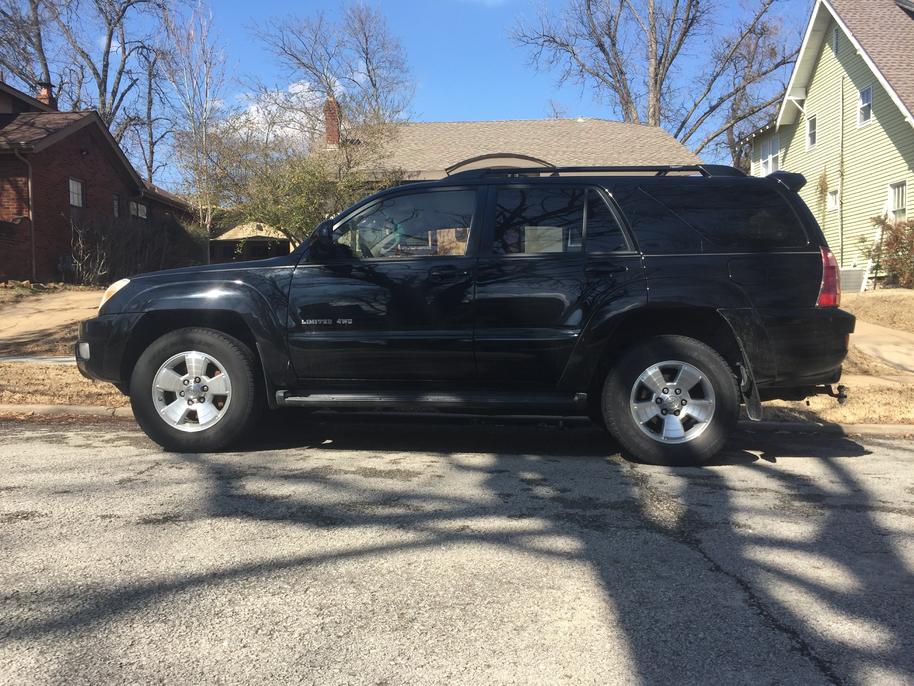

Meet Schmiegle (also my personal alter ego), my 2005 T4R V8 Limited. Bought in 2008, right out of college with 20k miles! I was amazed at the ride quality, quick turn in, and downright defiance towards getting stuck in anything. There's lots of ICE and snow in an Oklahoma winter and she's performed incredibly!
But with 125k miles, I'm ready for a suspension upgrade (among other things...). I wanted to retain the stock ride so initially investigated a total stock replacement of the suspension. I've messed with suspension before on an '98 Nissan 200SX and dropped it too low, with too high of spring rate, and never really rode right. I LOVED the performance of my T4R when I bought it and didn't want to lose that. I decided to give the dealership a shot with a quote and at this point, I was informed that this Limited had the XREAS system...

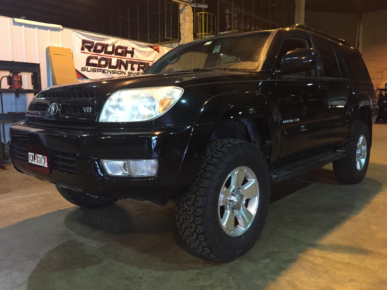

I mentioned that I replaced suspension on a previous vehicle and had some trouble installing it over the course of a weekend. I decided it was the better part of valor to just have a local shop take care of it.
Found a reputable shop here in Tulsa, Gateway Tire on 31st. Talk to Ryan if you're in the area and have issues. They have a massive shop and have done a good job with issues up to this point, as it went into the shop this morning and should be finished first thing tomorrow.
Issues up to this point:
- Rear strut, upper piston nut, seized up on both size. Had to be cut off to be disassembled.
- LCA bolts seized up. The previous day, Ryan saw this coming and ordered a new Toyota hardware kit. Gonna have to burn them out right?
- At first the mechanic balked at removing XREAS... After showing him a thread found on this forum, he didn't see much of an issue. I've decided to just leave the valve to valve system tubing on there for now. I'll remove it when I get home unless it really doesn't matter to stay put?
I stopped by this afternoon to check up on progress and I REALLY LIKE THE LOOK OF THE BFGs... If I can just figure out where to put the 5th one!
Should be finished up tomorrow early... Thanks for a great site!

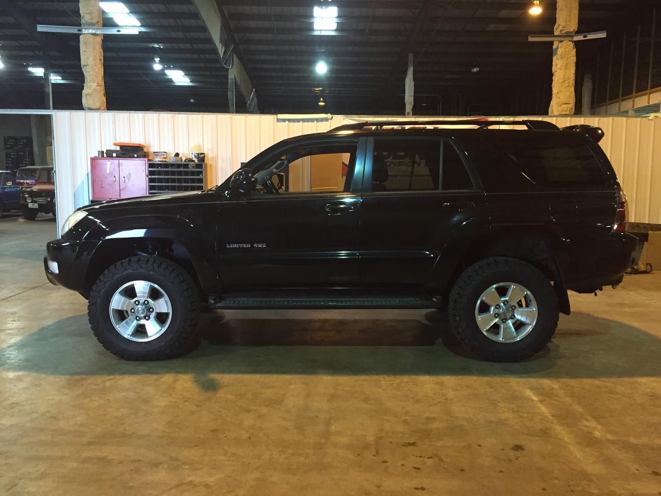

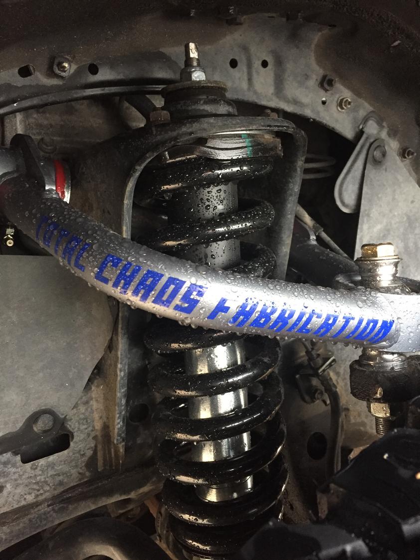

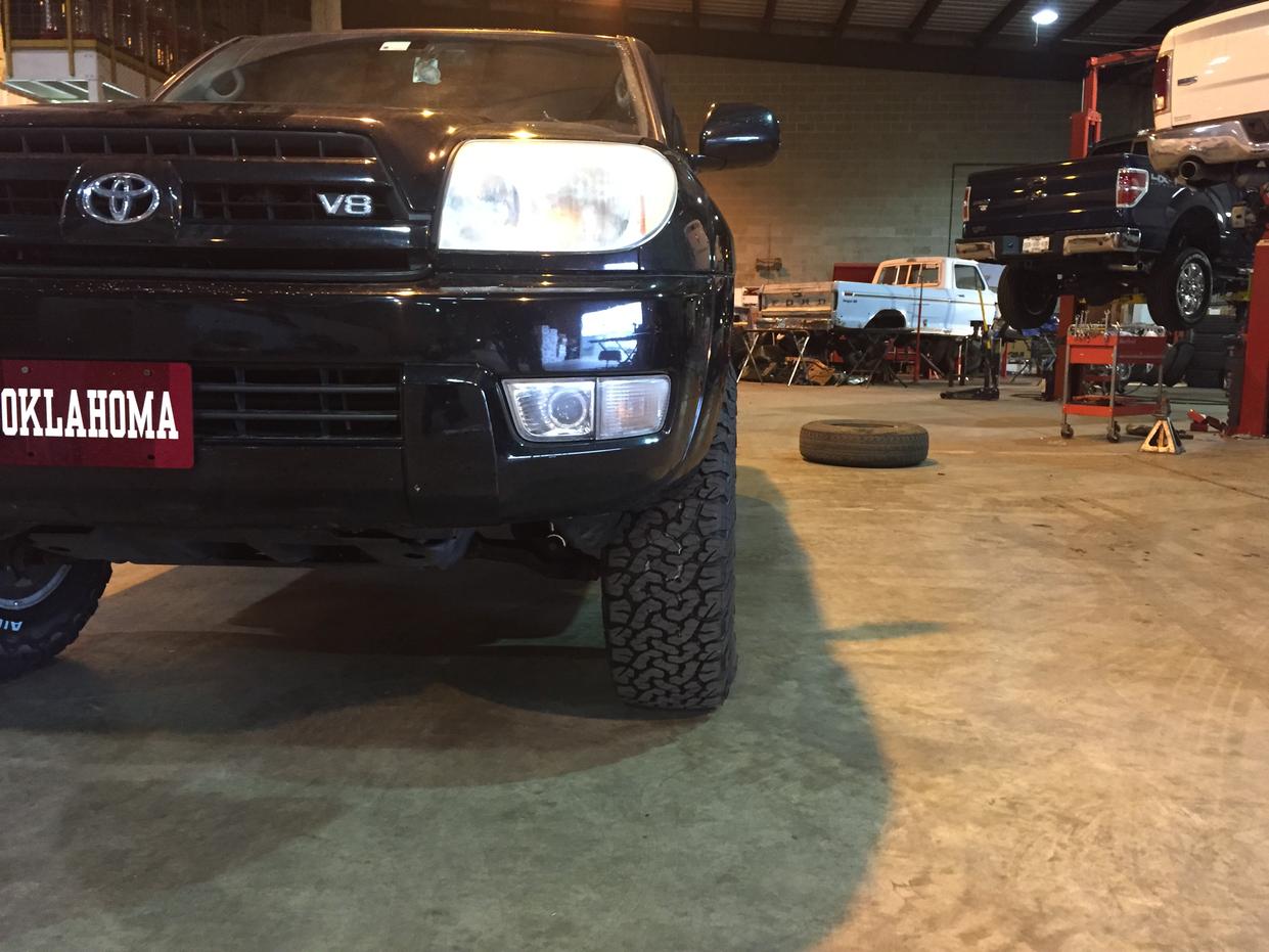

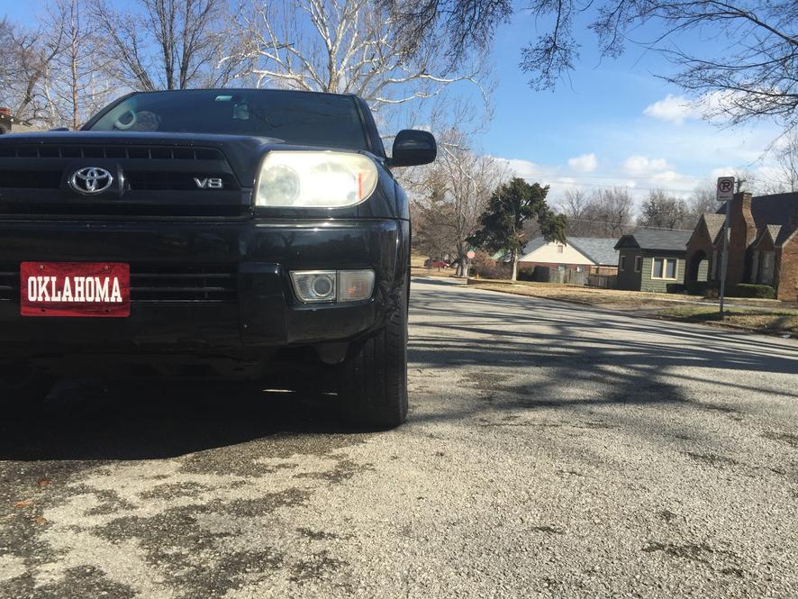

COULDN'T BE HAPPIER! This setup is incredible!
After a few issues, the shop was finally able to tighten everything down and give it a good alignment.
The ride is MUCH improved. Closer to stock Limited ride where vehicle stays level throughout cornering. The bigger tires and extended travel suck out bumps without a problem! It was a rainy day in Oklahoma, so I'm not sure if that was causing a bit of tire slippage in turns or if it was just the new tires. Will relay more information as tires wear in dry weather.

Looks good man!
I'm thinking about going the same route!
Look a lot better if you got different wheels, imo.
Looks good man!
Yeah, I agree. But alas the almighty $$$ is being drawn elsewhere...

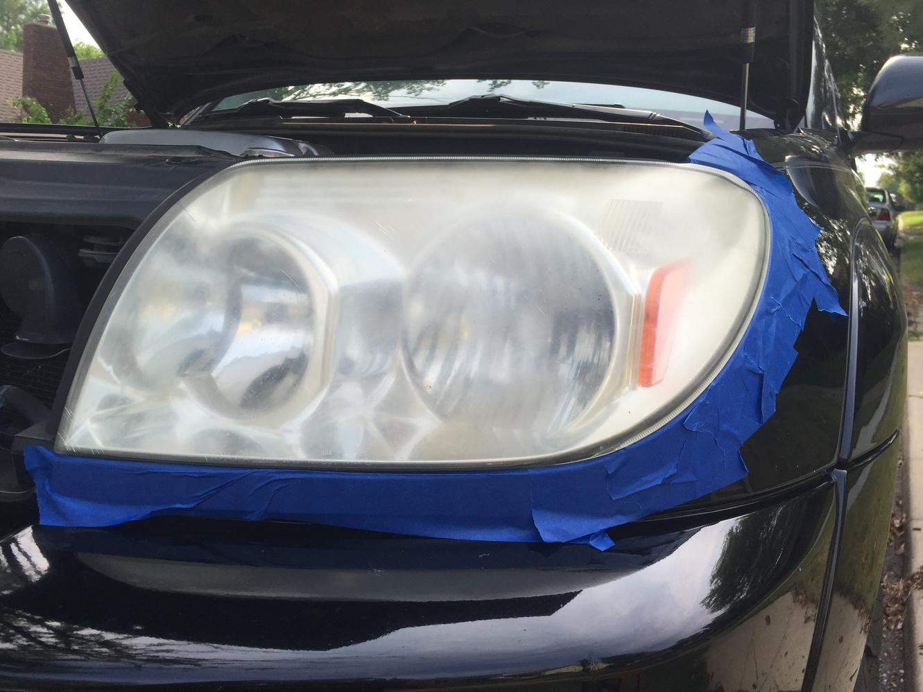

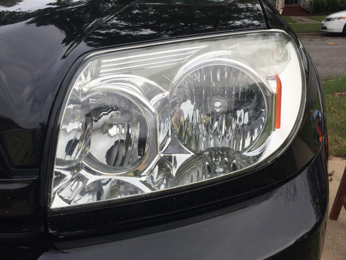

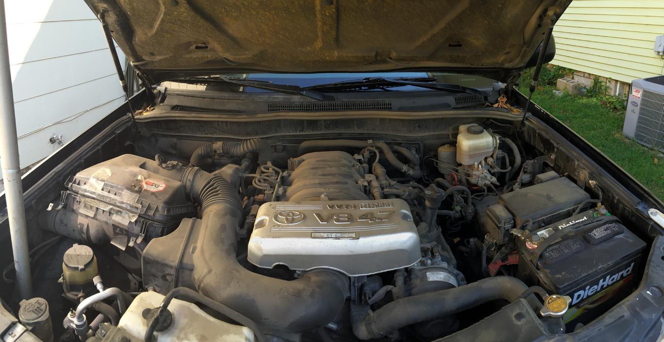

HAPPY 150,000 mile BIRTHDAY to Schimiegle! This week has been a busy week tending to the following neglected maintenance...
Since the last update, it's been a fun filled fomentation of additions.
K&N CAI addition (Whoa...)
New Hood Struts
Driver's Leather Seat replacement
4 piece carpet replacement
Headlight Restore
