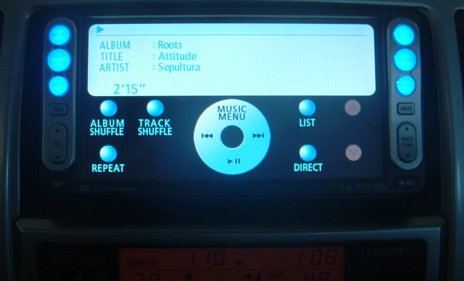

Just installed this Scion navigation/CD/DVD player into my 2004 4Runner, got an Ipod connection cable off ebay for $70.00 that makes a direct connection allowing you to control the ipod from the headunit and not havinbg to touch the Ipod at all.It also plays DVD movies when you are driving so long as you ground the parking cable wire.
not sure of the model, it is toyota part # 08545-00931.
The cable plugs into what I believe is where the factory sat. radio would plug into.

It was a direct plug and play, you have to splice into the speed sensor wire,and I grounded the parking brake wire onto one of the mounting bolts so that my 2 year old can watch sponge bob while we drive.. I put the nav antenna under the dash.
