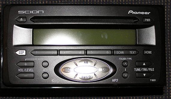

i have a Scion radio for sale.. i'm going from the single disc to the 6 disc.. it's in new condition.. for those who are not familiar with this radio:
-AM/FM 160 watt Pioneer
-Single disc player
-MP3 player
-satelite ready
-3 listening modes (neutral, hear, feel)
-works with the steering wheel controls
-orange background with black numerals
i installed this in 20 minutes.. the 4th gen runners have a "snap together" dash held with 3-4 bolts..
$125 shipped anywhere in the 48 US..

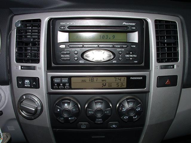

Easy to install, all my steering wheel controls work the same, background lights are the same color, and the sound....WOW! I came home with my ears ringing and couldn't hear the phone ring when my wife called. And I didn't care.
Here's a picture installed

Is it an exact fit, or are there any gaps? Partsrep's new unit looks like a nice clean install.

Once installed you would think it came from the factory that way. No gaps, perfect alignment, etc.
